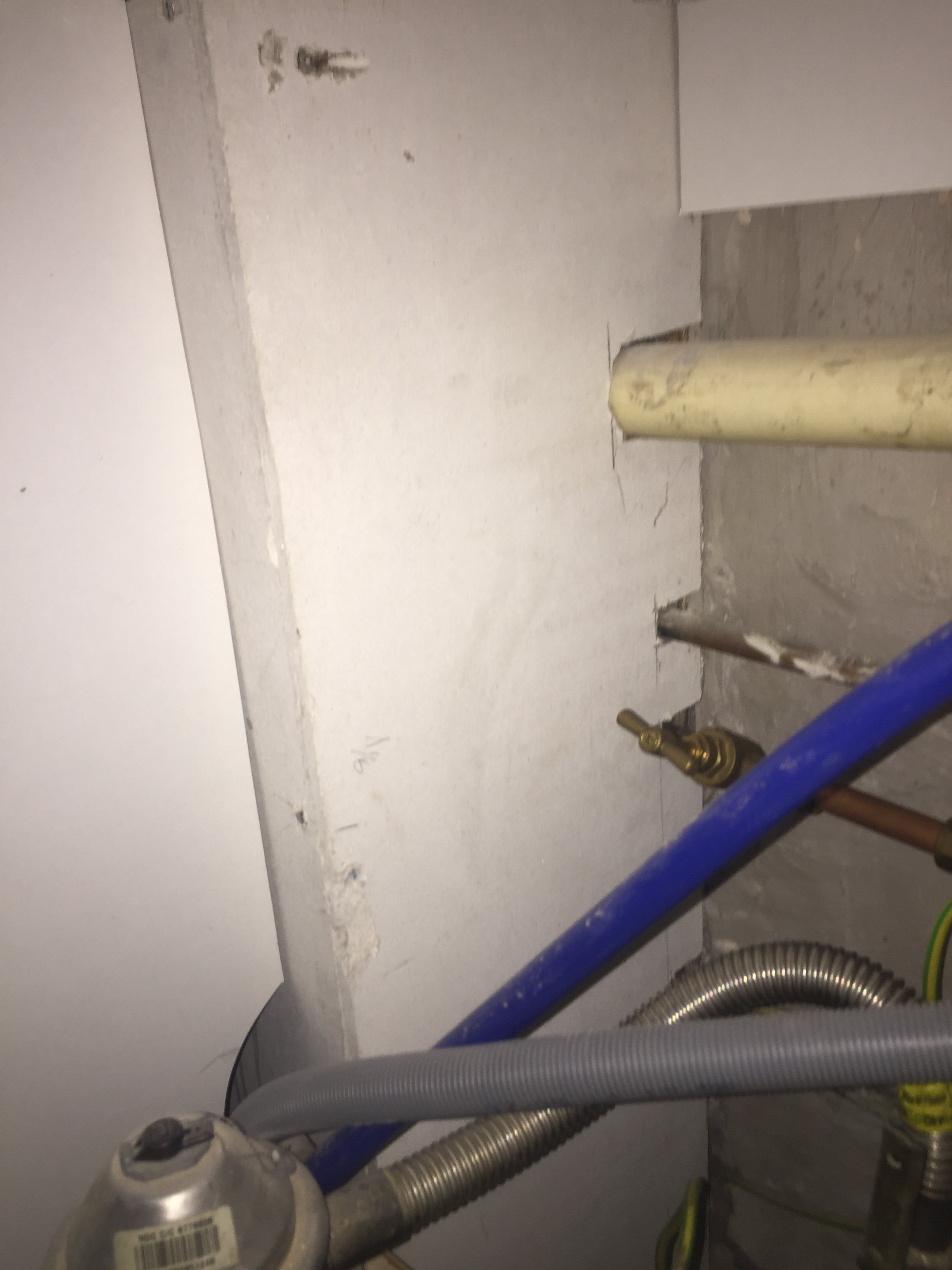

Looking for some advice, I am getting a drain/sewage smell coming from my kitchen soil stack. It’s always been there since I moved in only a few months ago, I had a new kitchen put in and one thing I remember is the drain pipe got bashed about a bit when the kitchen was getting done.
The smell is definitely not coming from the sink trap, I am planning on opening up the boxing around the pipe this weekend to see if I can see if the connections are good.
If the connections are good I was planning on using some expanding foam and attempting to seal around the bottom of the pipe in case the smell is rising from the dwellings below, then siliconing the boxing up to try and prevent the smell. Is this a good idea?

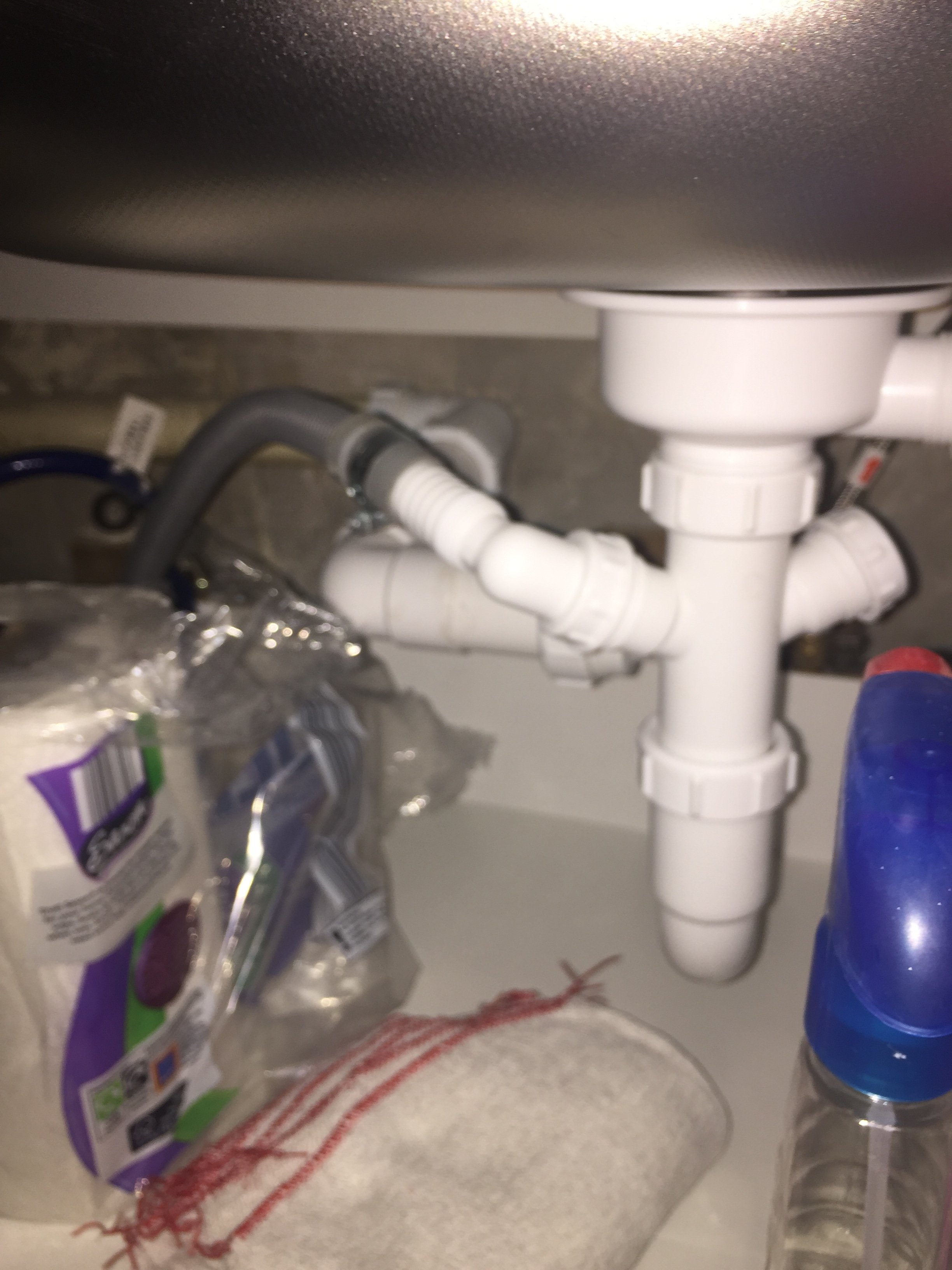

Post a better picture of the way your washing machine waste is piped where does the grey flexible pipe go? Kop
My washing machine waste go's into a connection on the sink waste and is secured tight with a clip. My washing machine is to the left of the above picture and my sink trap to the right.

even thought it's apparently not the issue here, you still need to make sure the WM pipe rises up above the sink overflow height before it falls to the trap connection, otherwise when you empty the sink the dirty water will stagnate in your washing machine sump.

Not sure what you mean abot the WM waste and the sink overflow?

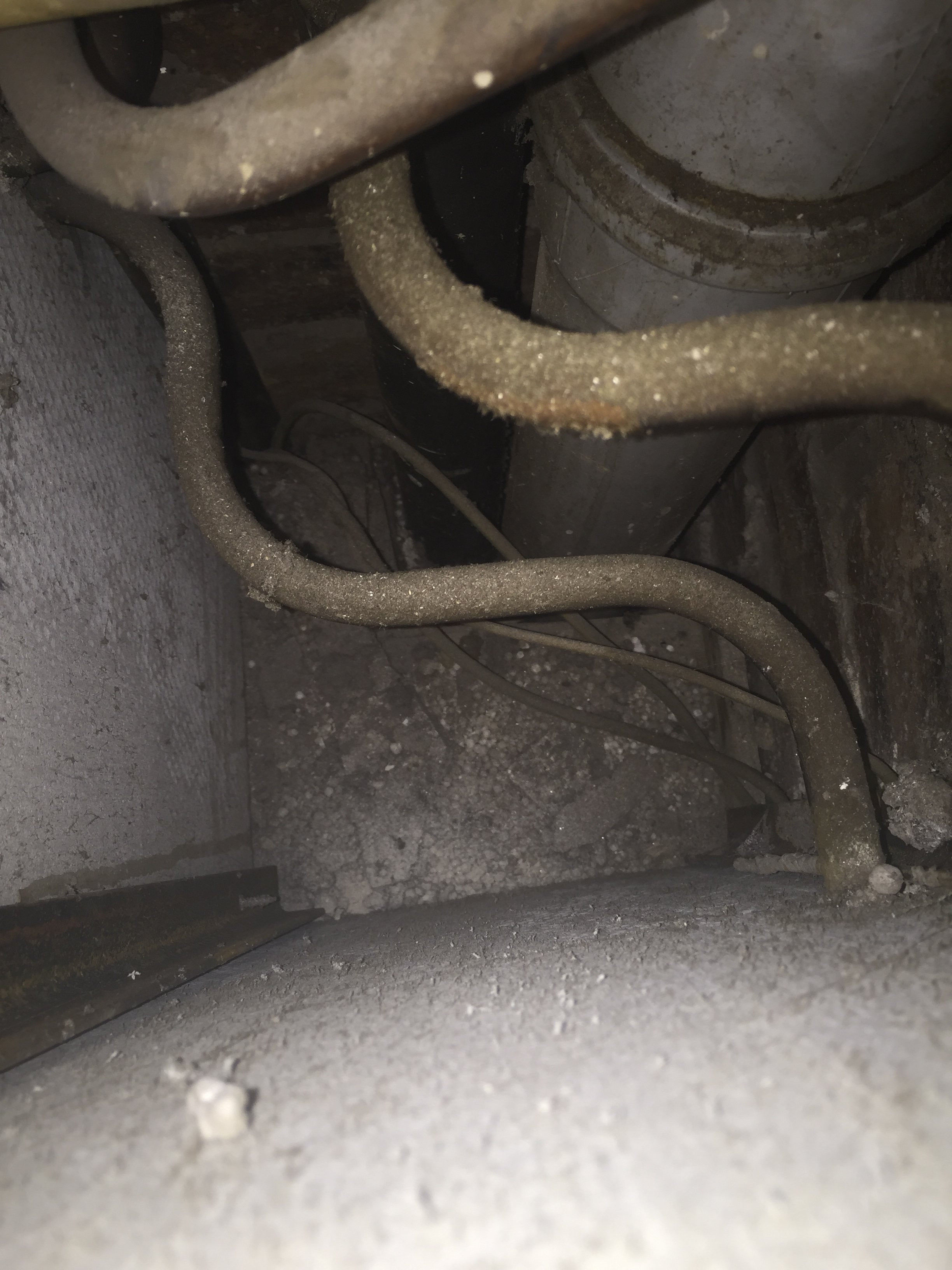

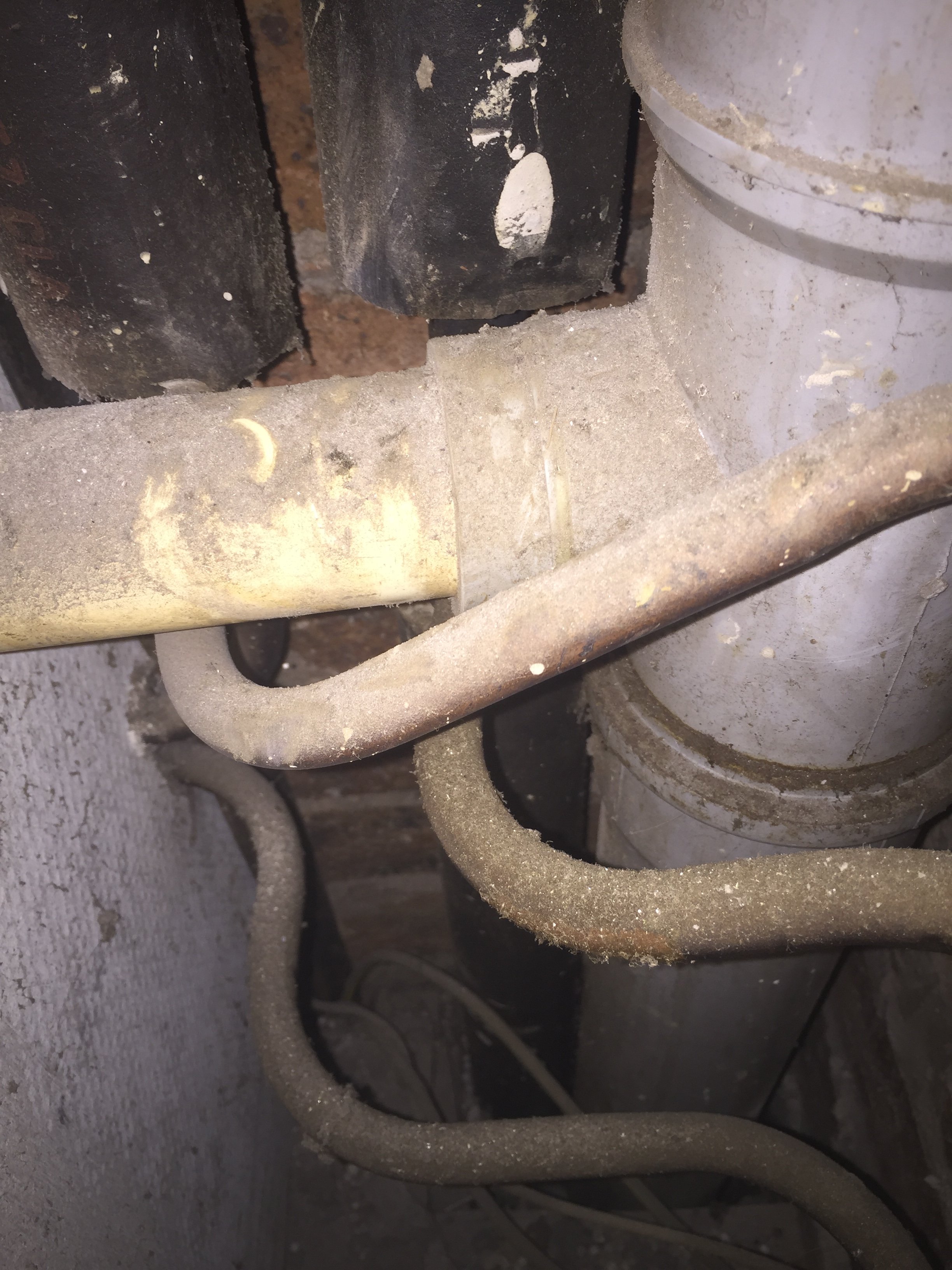

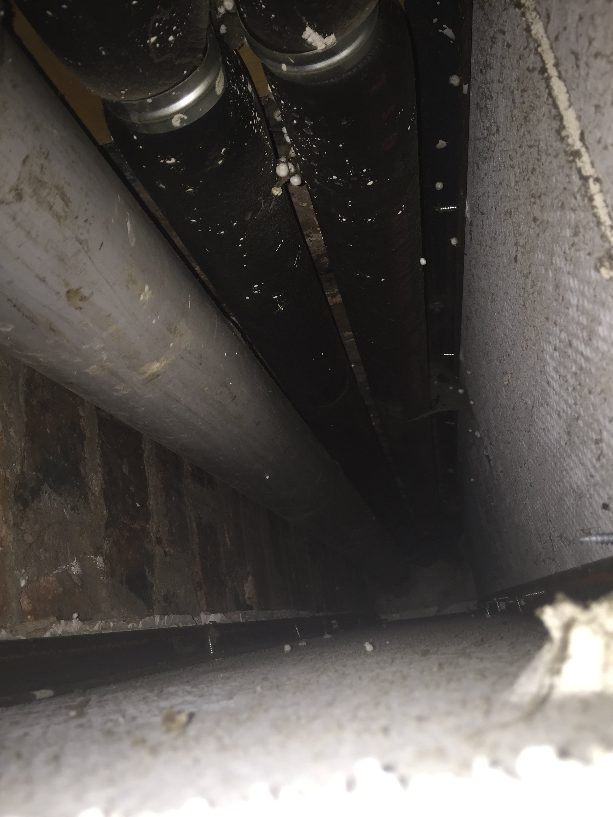

Ok, So I got into the boxing today and all is dry no leaks or anything.
Connections seem ok. It is drafty in there though?
It looks to me like its from the washing machine as your connection is not looped high enough and is above the water trap letting the smelly water in your grey w/m pipe release to atmosphere. Also it could be the pic angle but pipe after trap looks like it goes up hill for a bit

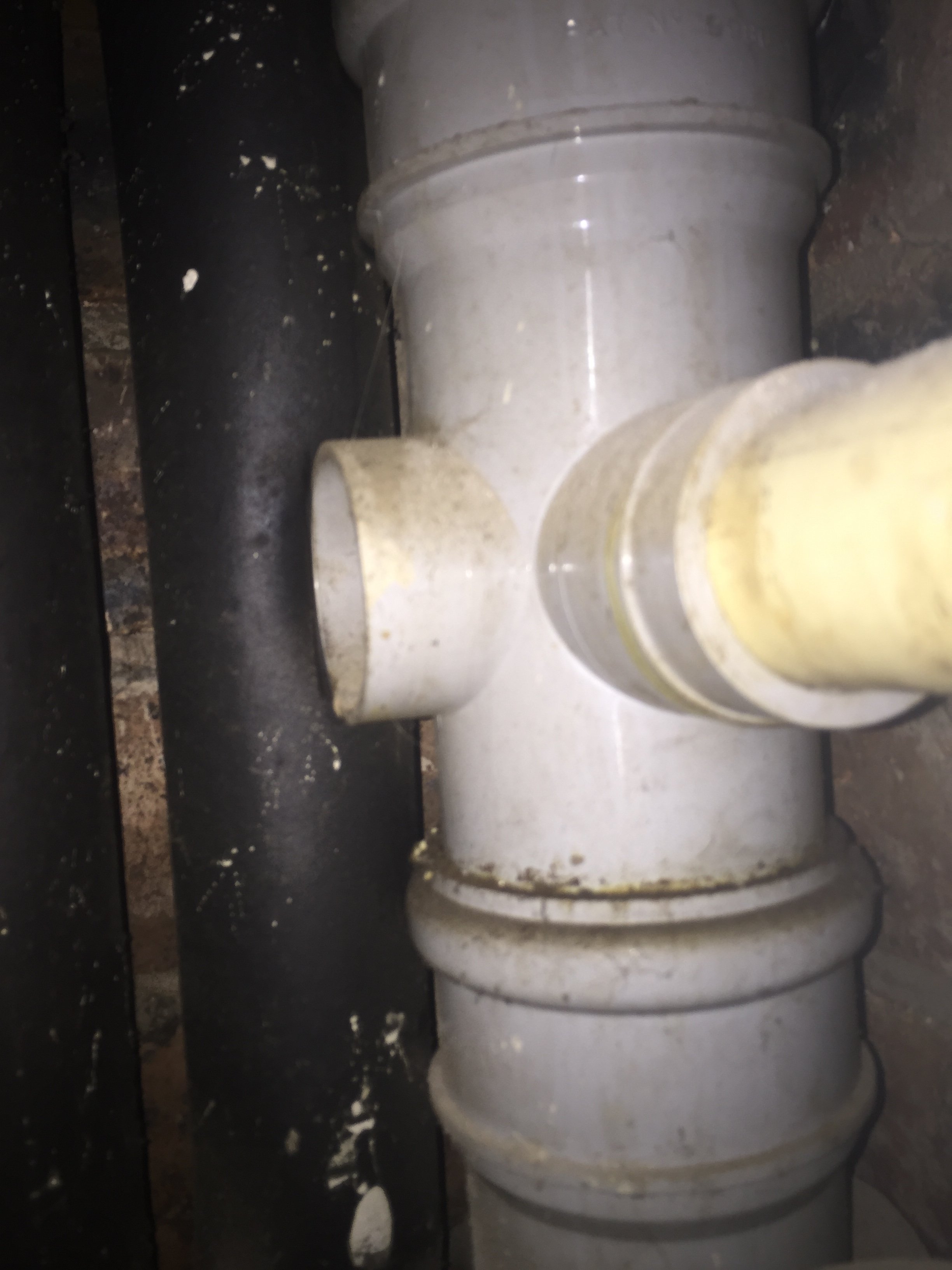

assume you checked round the back for missing blanksb
Could be a hole in another floor that's blowing up through the gap. On a neighbour's floor you can let them know. But if you block the holes in the floor it would help
I looked at the blanks that I can see and they are sealed.
