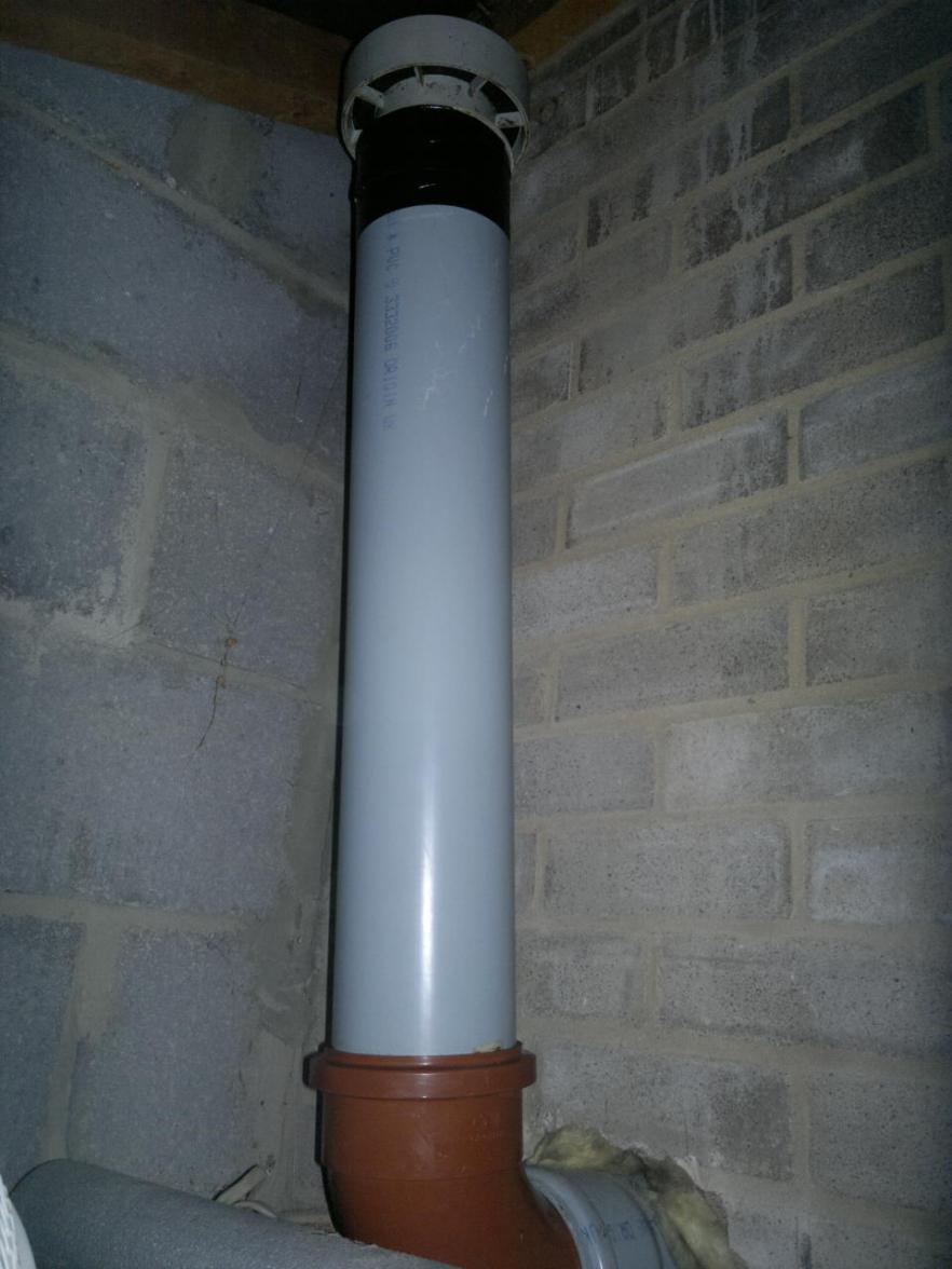

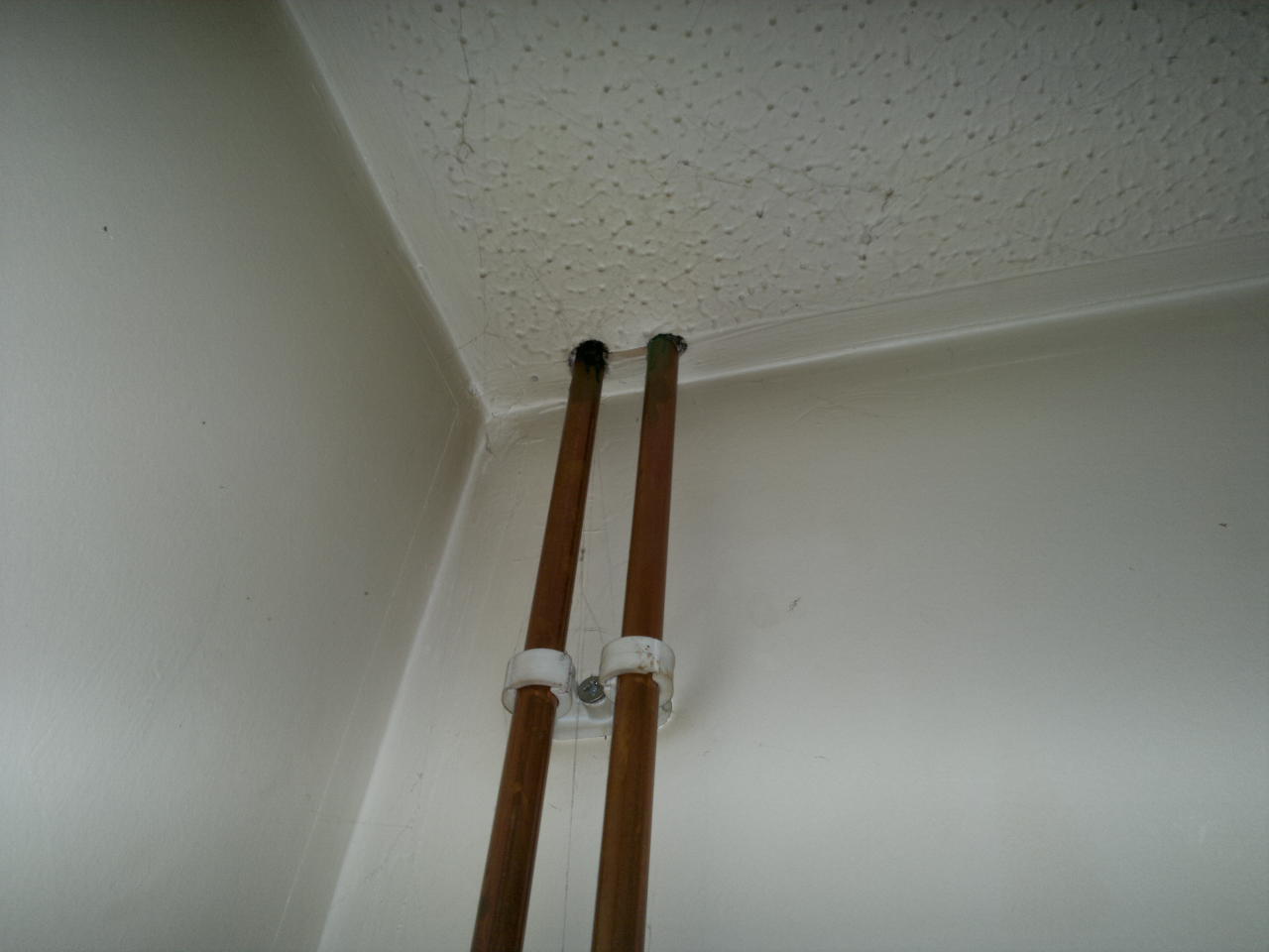

Picture five is the air admitance valve as unguided says propably stuck open and letting Sewer smell out just needs a new one fitted

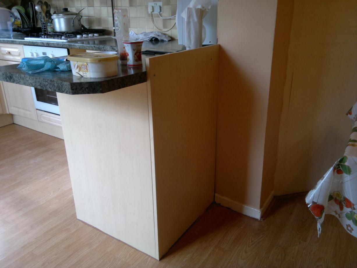

First pictures is from the dining area, where the pipes (concealed in the corner) from upstairs toilet

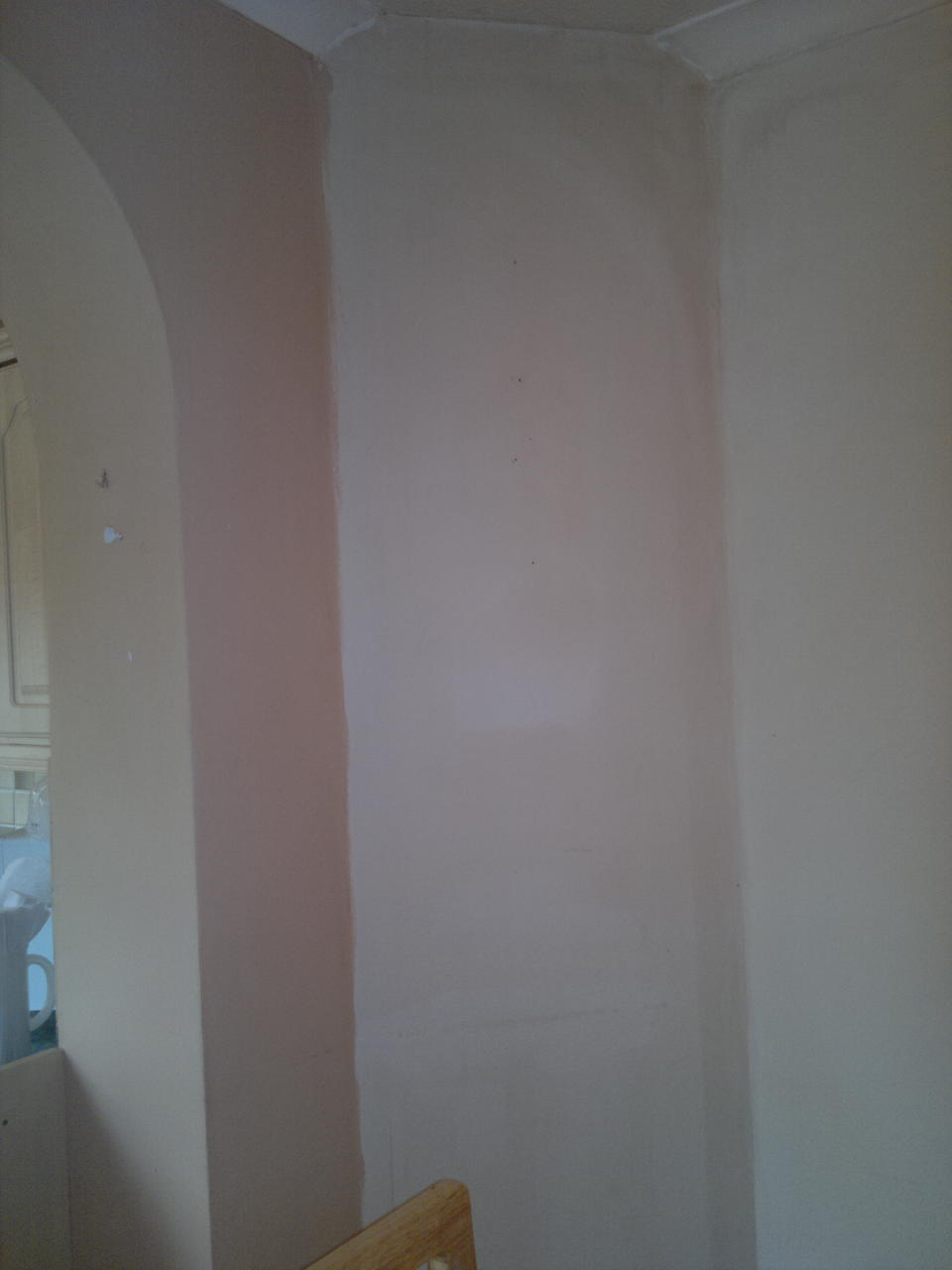

Second picture is the kitchen where the manhole is covered somewhere.

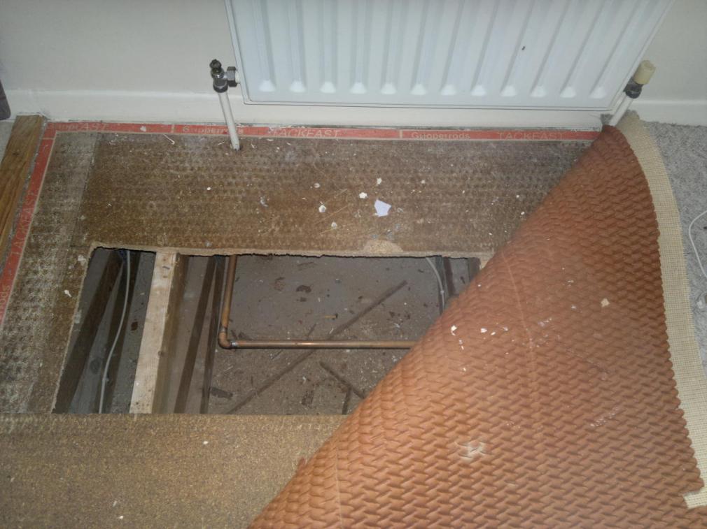

Third picture is the cealing of the ground floor

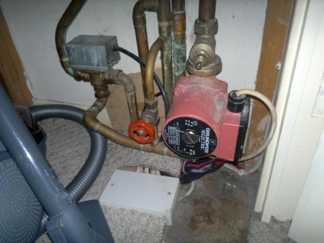

Forth picture is the Airing cupboard first floor
Fifth picture is the loaft of the extended kitchen where the valve can be seen

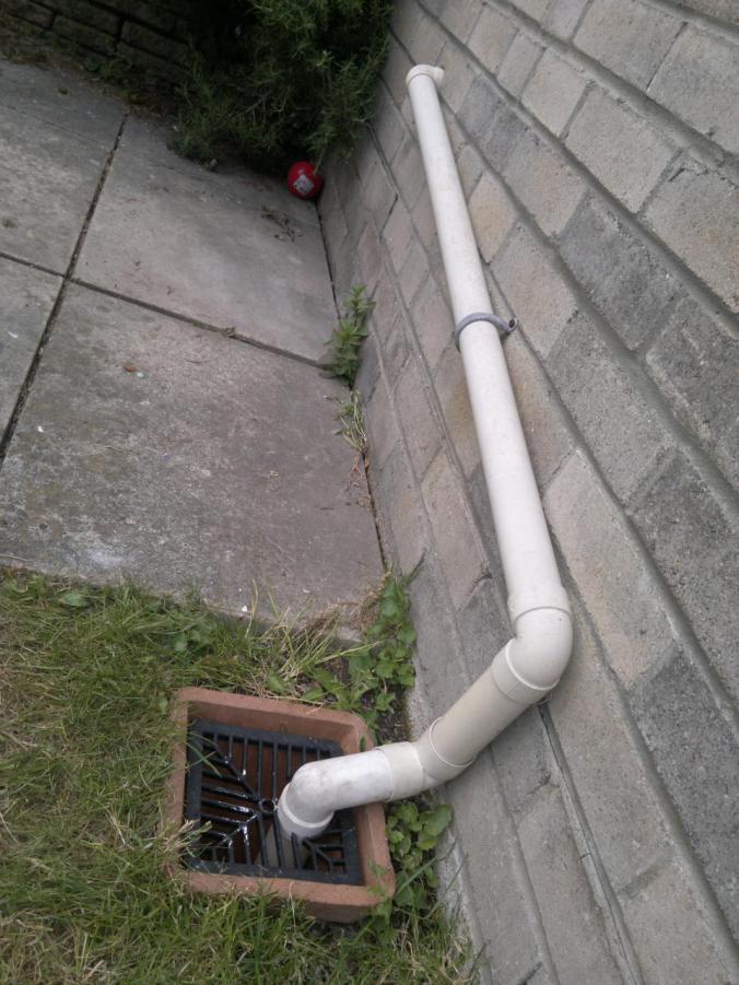

7th picture is the garden area where the sink drain is going

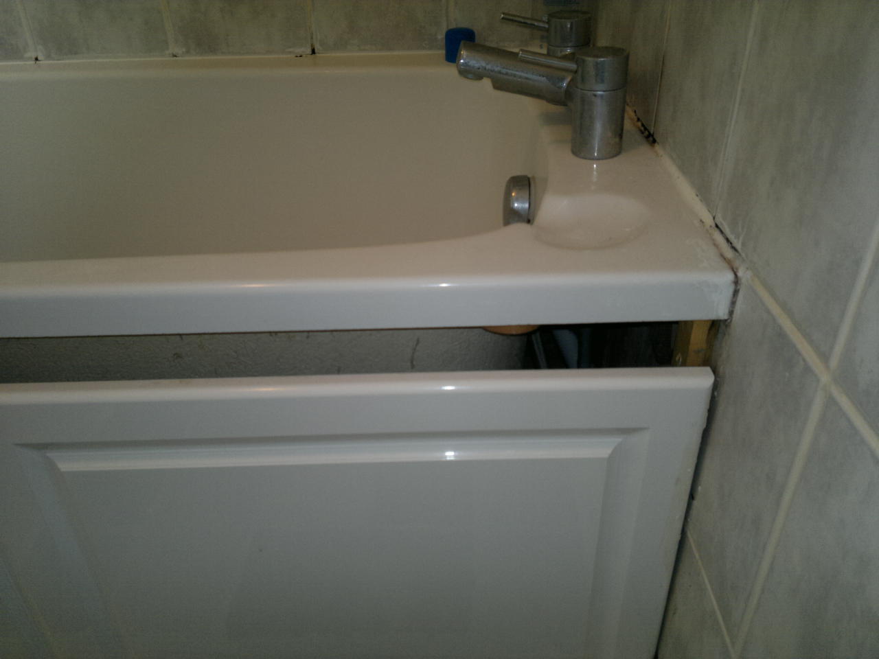

8th picture is the gap in the bathtub where smell comes through the floor board opening.
