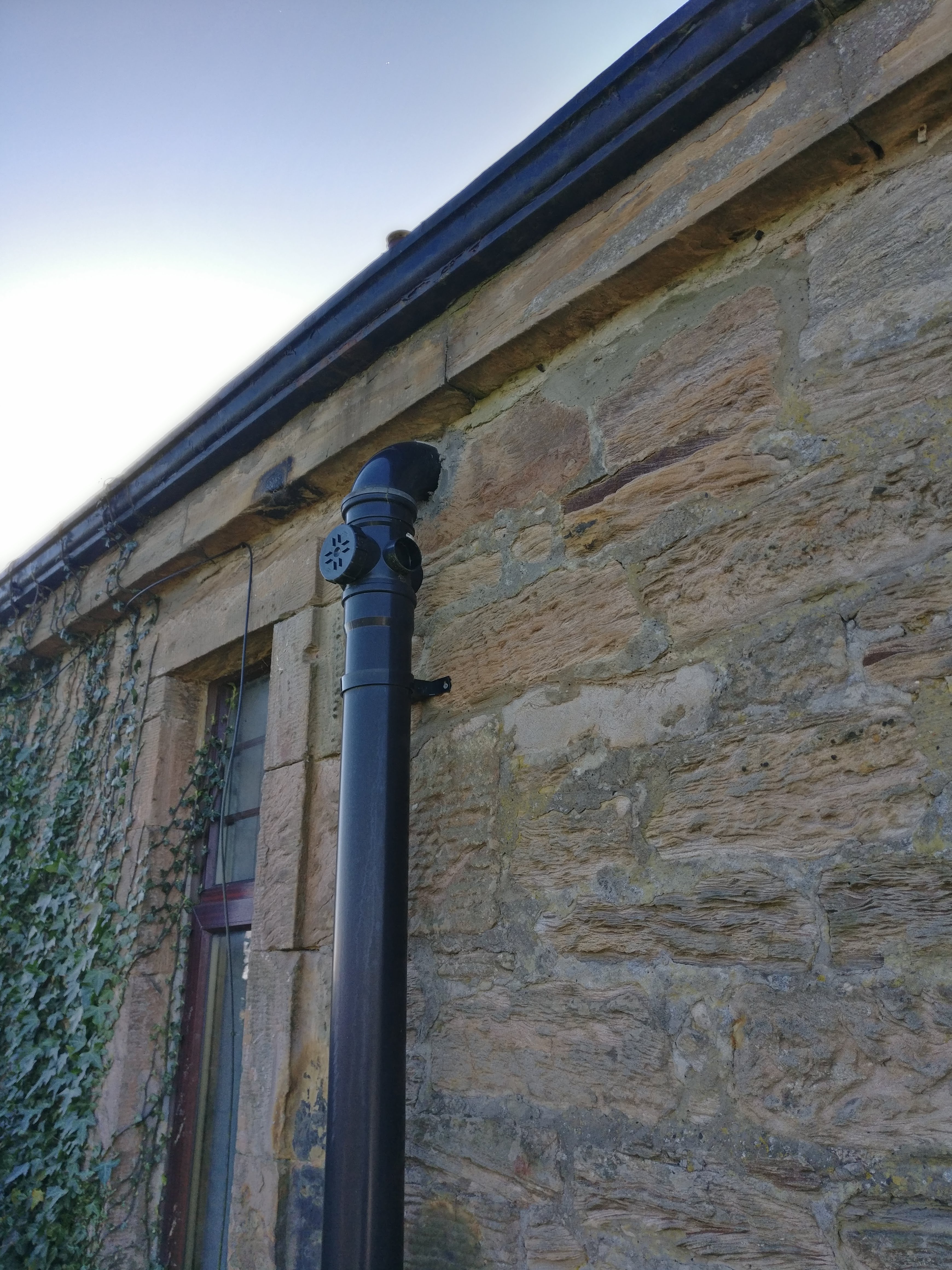

The bathrooms were renovated over the last few years and I am wondering if we should have a vent on our waste pipe and whether this could be a cause. I am wondering how easy it would be to fit this myself? The pic shows the current waste pipe, looking at older photos of the house this used to have a stack on it.

Looks like you have no vent. So will draw the water out of the traps.

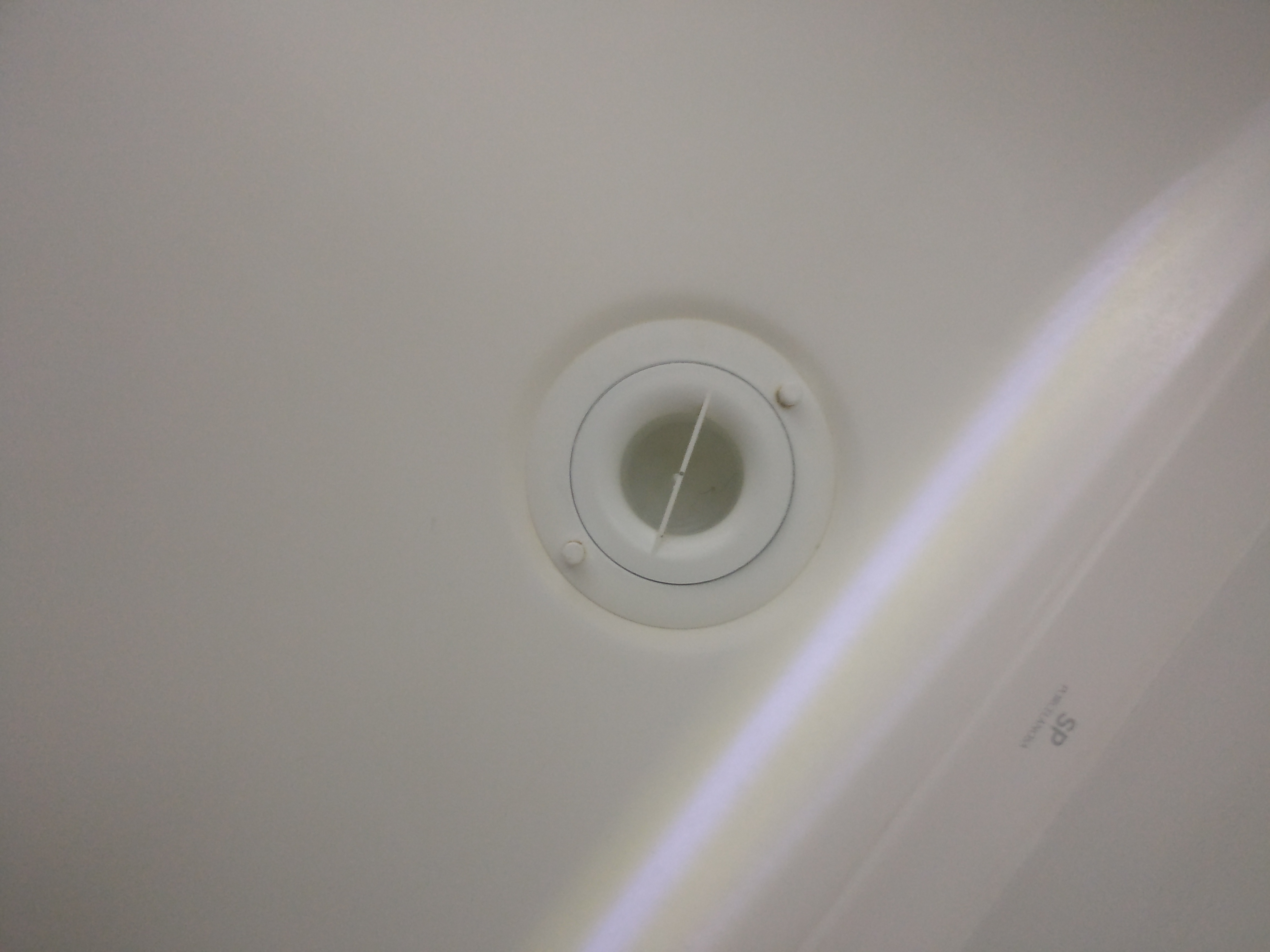

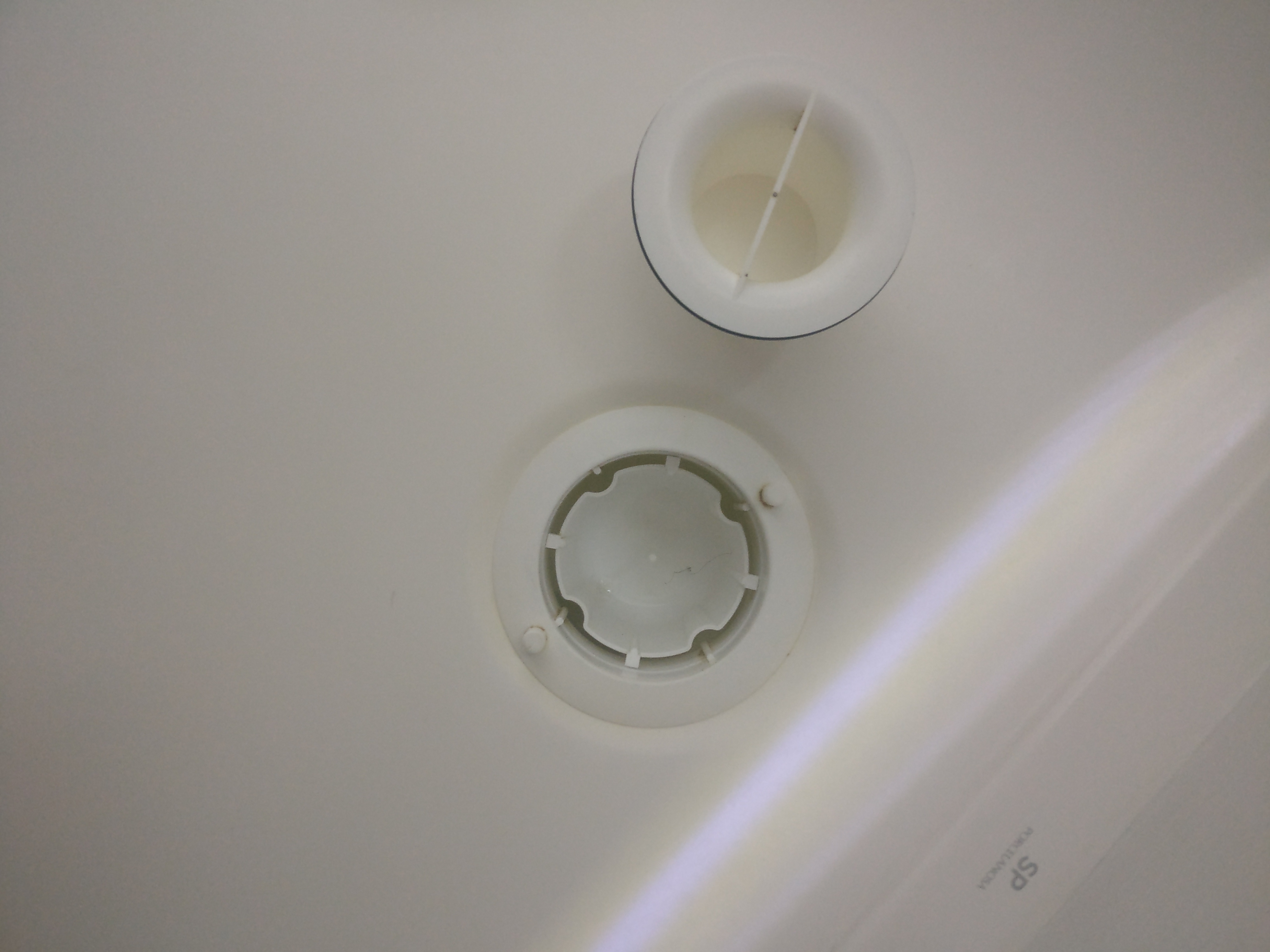

Can get one - it has a little cup inside which is clear and then if you take that out it's the entry into the drain, which is also clear. I should add that the water drains freely, there doesn't seem to be a blockage
Might be missing a part, so a pic would be good
