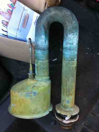

If we where still fitting these bad boys you would have a good flush the days before plastic and saving the planet.
