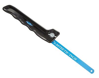

Various types widely available, makes it much more comfortable than tape / gloves.
Personally I like this:
I thought it was a gimmick but the blade is much more rigid than a hacksaw blade so much more useful.
