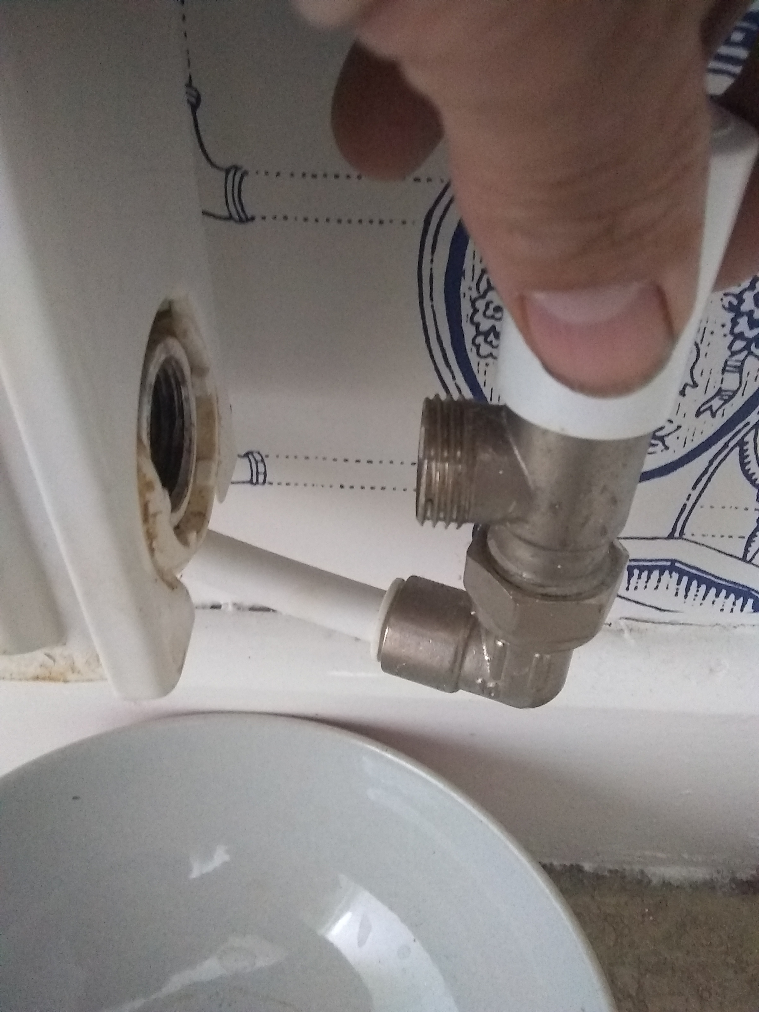

Is this a pushfit elbow?
Can the pipe be easily removed should I want to do. Is a release tool needed? Does anyone recognise the fitting? So, that I know what to by.
The drain valves are now leaking after draining the system and I've been told the need replacing
These look very similar

Hi. Thanks for the reply.
So, how do I disassemble the pipe from the elbow? I may need to cut the pipe shorter. Can it be reassembled once I've cut the pipe shorter, or is it a one time only fitting.

Good morning all. Thanks for the video. I've used Speedfit before, so I am familiar with their use. I wasn't sure if this Drayton push fit (if that is what it is) works under the same principle. I know that some of these manufacturers have different systems.

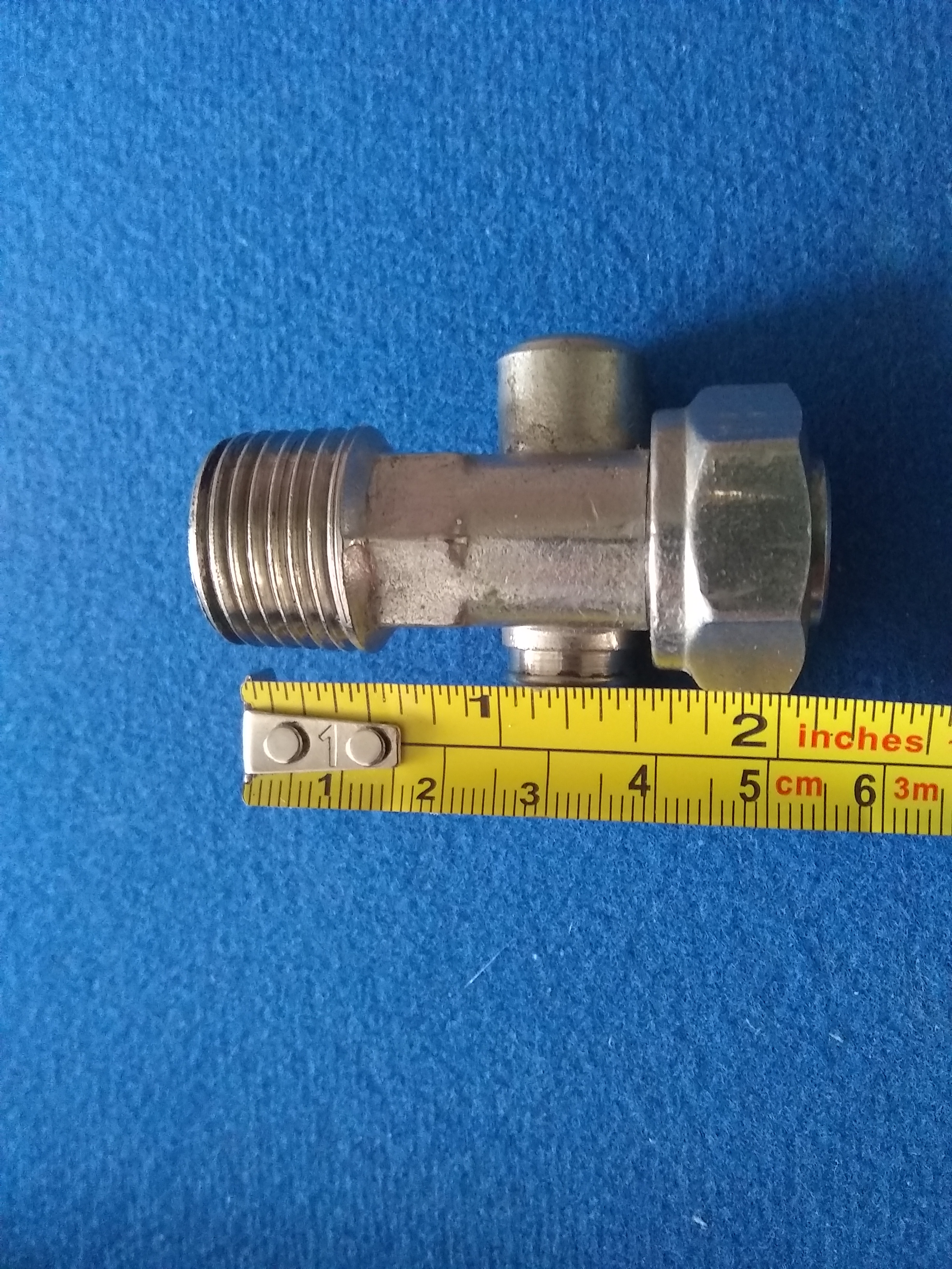

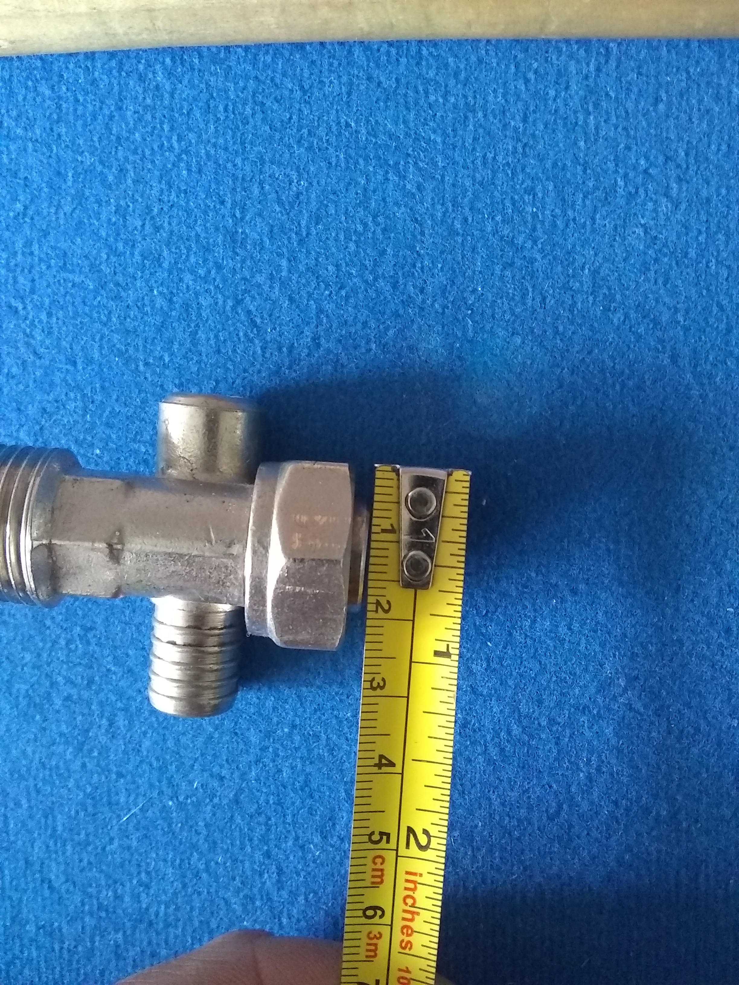

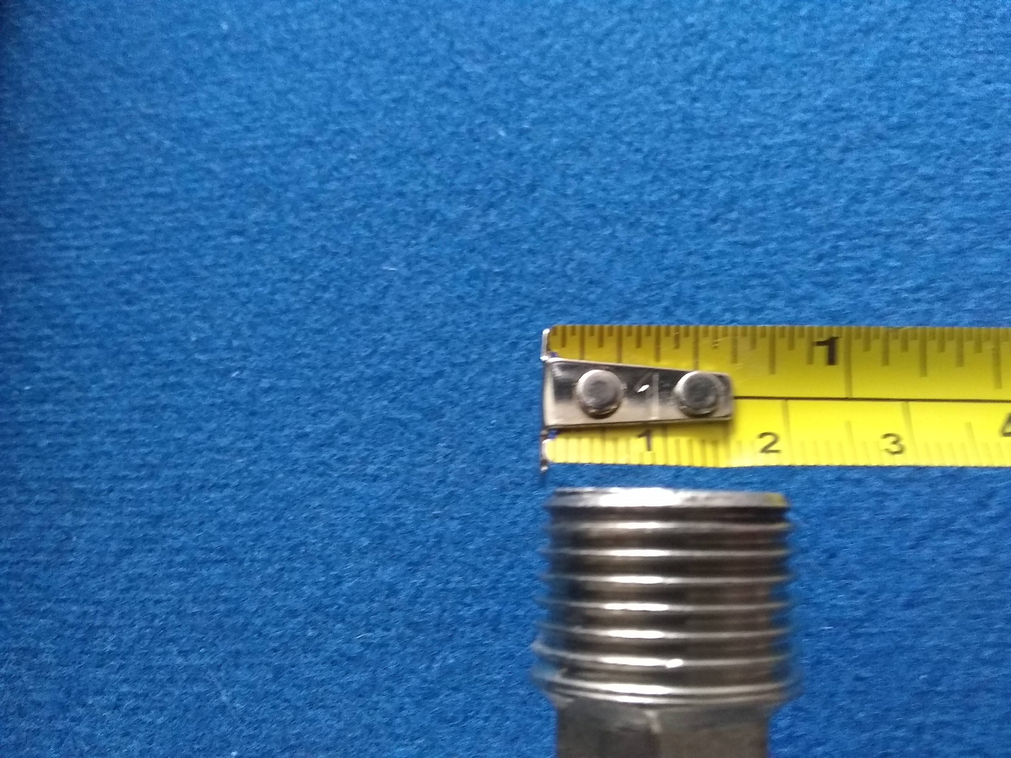

Just out of curiosity. If the ordered drain valves don't come today, is there something else I could buy from SF to cover the distance from the rad to the rad valve. Instead of the drain valve. I really need to get it done today. We've got no heating or hot water. I've seen items called tail valves and tail extensions. Would these do it? I know it means that they wouldn't have drain offs, but I'd have to deal with that in the future if necessary. I've taken some pictures to show dimensions.

These will get you up and running

You could just isolate the radiator by shutting down both radiator valves (just remember how many turns you close the lockshield valve (the one with the loosely spinning head) down by so you don’t mess up the system balance when you refill the rad later). With both valves isolated you should be able to refill the system and restore heating and hot water to the rest of the property. It would be prudent to have a couple of caps to cap the radiator valves off with if they let by a little. (The one in the picture needs a 1/2” cap, couldn’t tell you if the other side is the same). That way you can ran as normal, replace the drain off cock when it comes in and just refill that one radiator afterwards.

I don't like the telescopic ones, I've had them leak in the past. The rigid tesla ones work much better in my opinion, if they're too long you can just cut them down. Ptfe round the threads into the radiator and nothing wrong with a little ptfe round the olive, just not round the valve threads, it's pointless.
