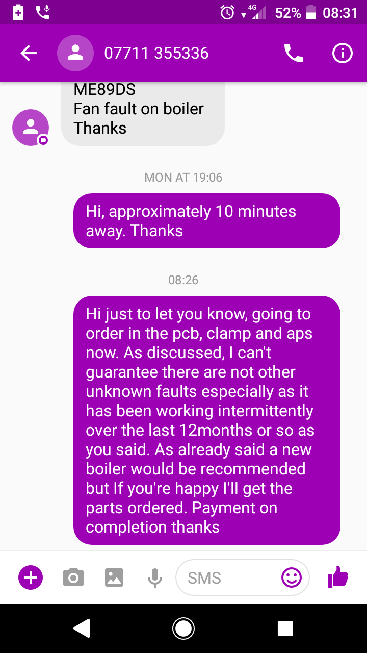

I'm going to call the customer now and suggest new clamp and pcb but will say as he has told me it's been working intermittently for the past year there could be other faults.
I'll probably take an aps also.
He's been an electrician for about 40 years, he has changed parts on the boiler in the past, diverter and microswitches.
I know what he is up to, as its been playing up but he can't put his finger on it, he wants me to take the hit for the pcb if it still doesn't work.
The boiler goes to lockout immediately the second there is a demand.
He has phoned me and said he wants a pcb and new clamp.
I have made it clear that there may be multiple issues.

Just sent his text to him, will await reply.
Can you edit the picture to not contain his number or postcode? You might need @ShaunCorbs to do it for you.
Sorry I didn't even think about that.
It can be deleted completely if needed.
