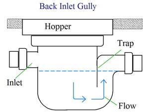

Managed to start my new year with a blocked outside kitchen drain. Skimmed through many forums in search for an answer. My main struggle is understanding how the drain works as I am seemingly unable to figure out w h e r e the water is supposed to escape. I attached a drawing of my current understanding of it, together with a photo i took from inside the system, showing the end of the pipe that runs from kitchen, outside into the drain. I've tried rods that barely fit, plenty of hours of caustic soda - nothing but frustration. The house I live in was built around the seventies or eighties i believe. Does anyone perhaps recognize the system and is able to point me to what am i missing there?

Prob back inlet gullet as above. Can you back away from it and take a pic? Gulleys need clearing now and then. Should be fine silty material. If it's small angular pieces then rats have got into it. If you don't want to stick your hand in get a long handled spoon or ladle and clear it out.

The out let from the gully is most likely to be on the oppersite side to the inlet in your drawing but it will be below the water level to form a trap (seal) which stops the sewer smells escaping.

Boy, it never occurred to me that there might be an actual escape in the bottom of that hellpit. Did some probing with a stick, felt nothing. Will have to wait until weekend to get some daylight in order to dig it properly empty, I sure hope that all of you are right, though, and it is a back inlet gully. Will post results ASAP! Thanks for all the comments so far mates.
