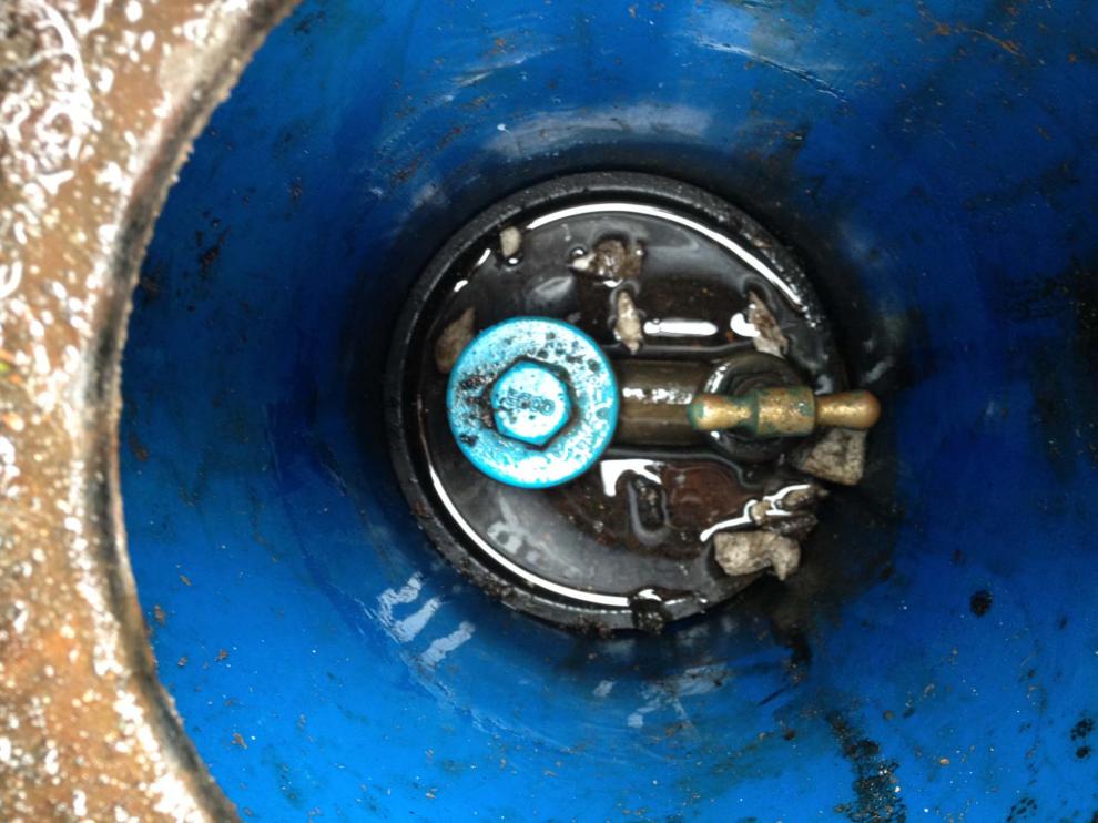

What is this blue thing on the street next to the stopcock ?
Yes will be getting a plumber in. Upstairs have the same poor water pressure.
in my experience usually an empty bag of walkers cheese and onion. (other brands available)
or it could be the stop tap itself, some of the new ones are blue plastic handled jobbies
Is it round with number dials on it? Could be a water meter. Can you take a picture of it and post it on here?
We have a metre post our internal stop tap/cock. This could be an old meter?
Here is picture of the water mains on street:- water pipes (2)small.jpg

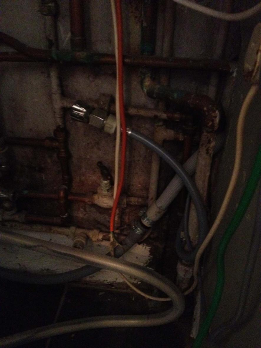

and our internal stopcock. I will get a plumber out but want other advice as well to get a varied range of responses.
