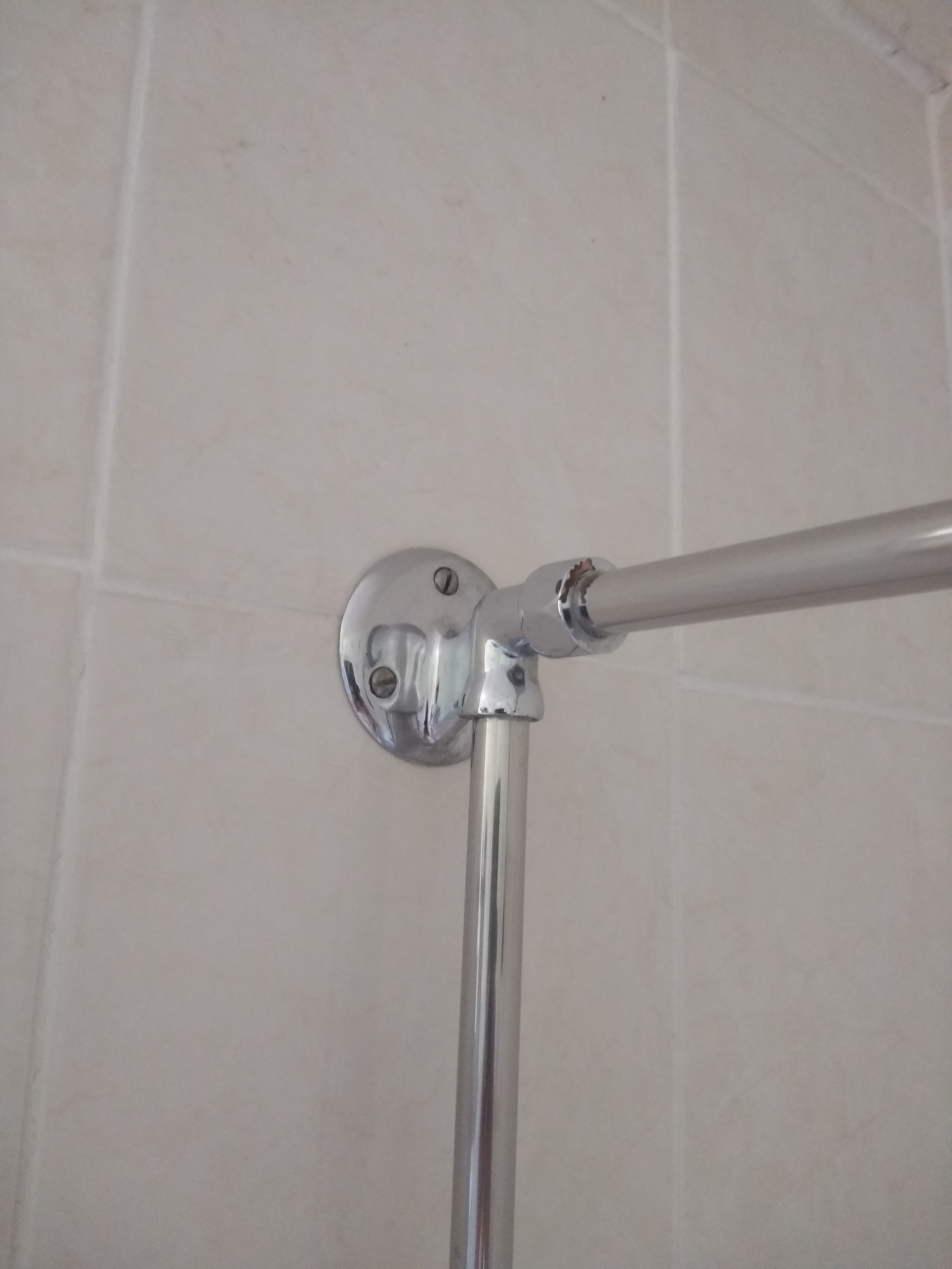

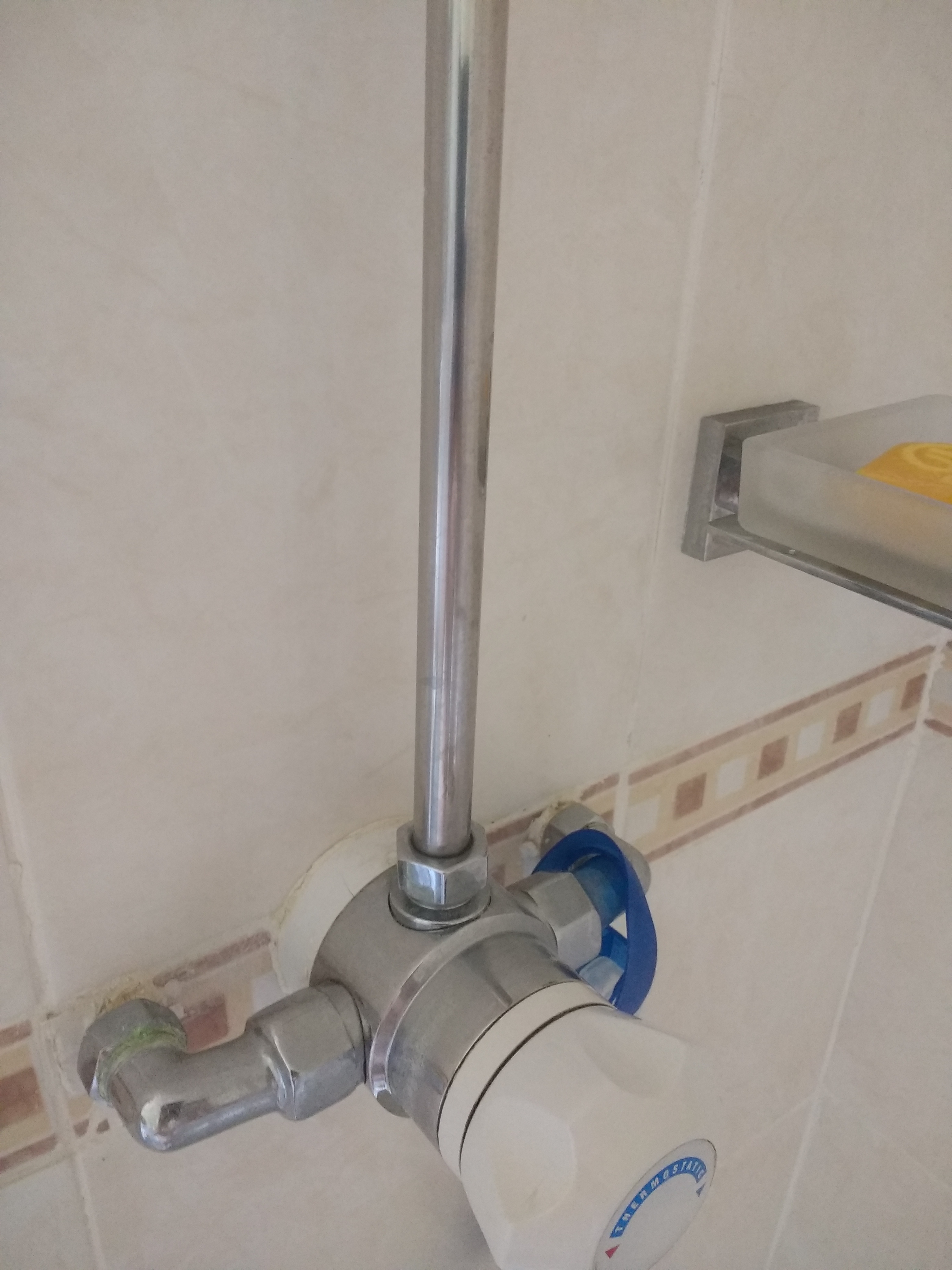

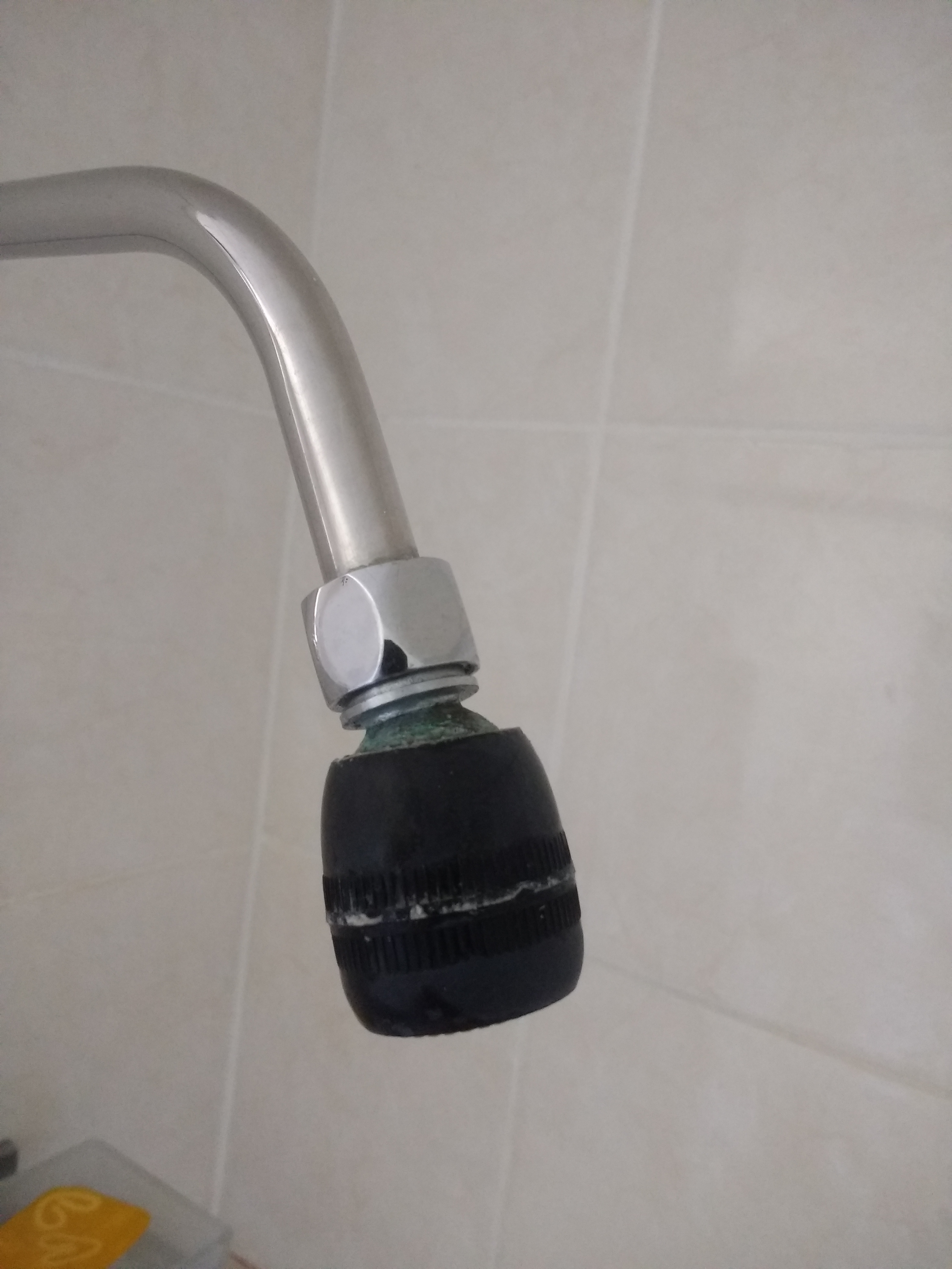

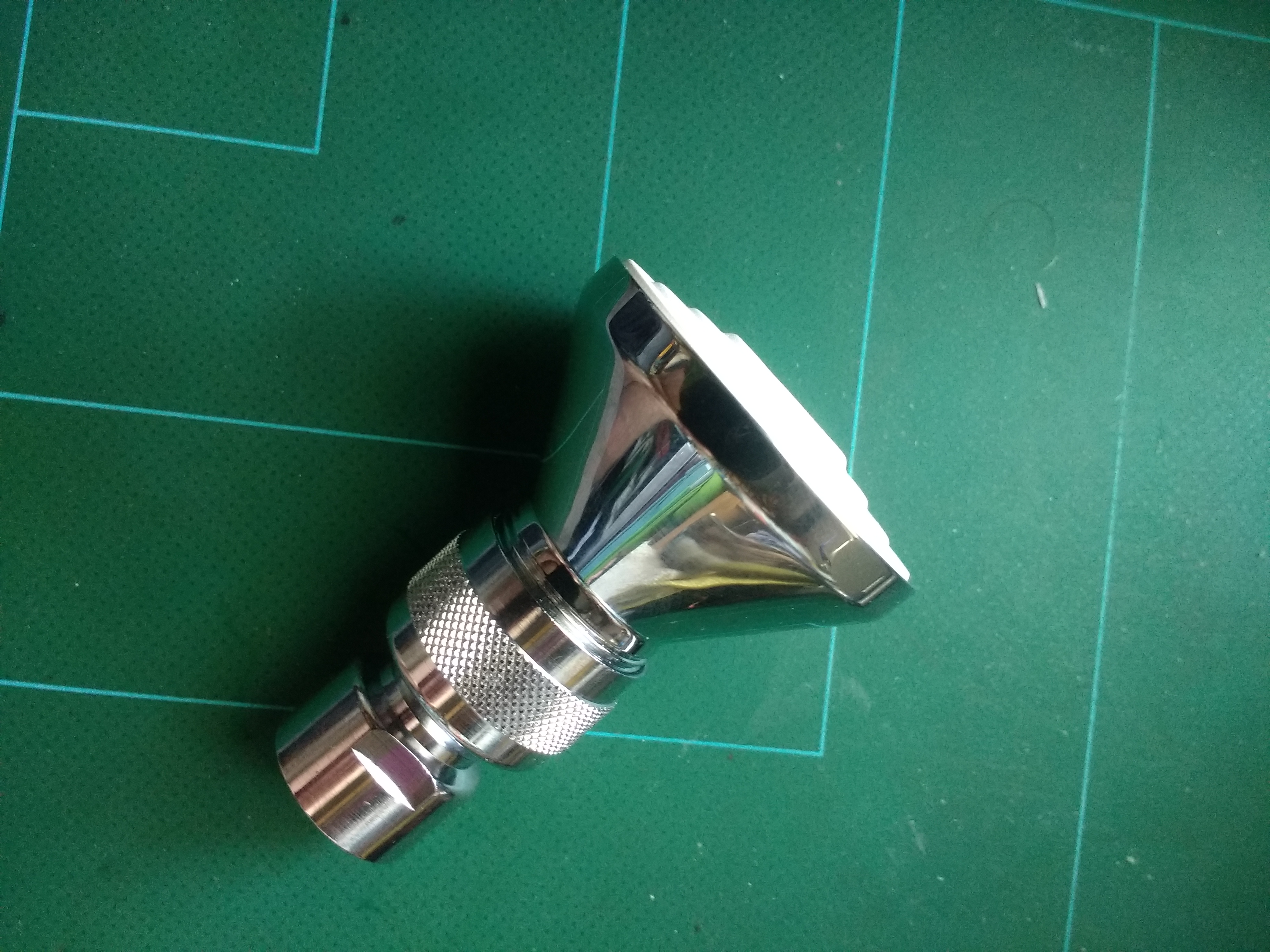

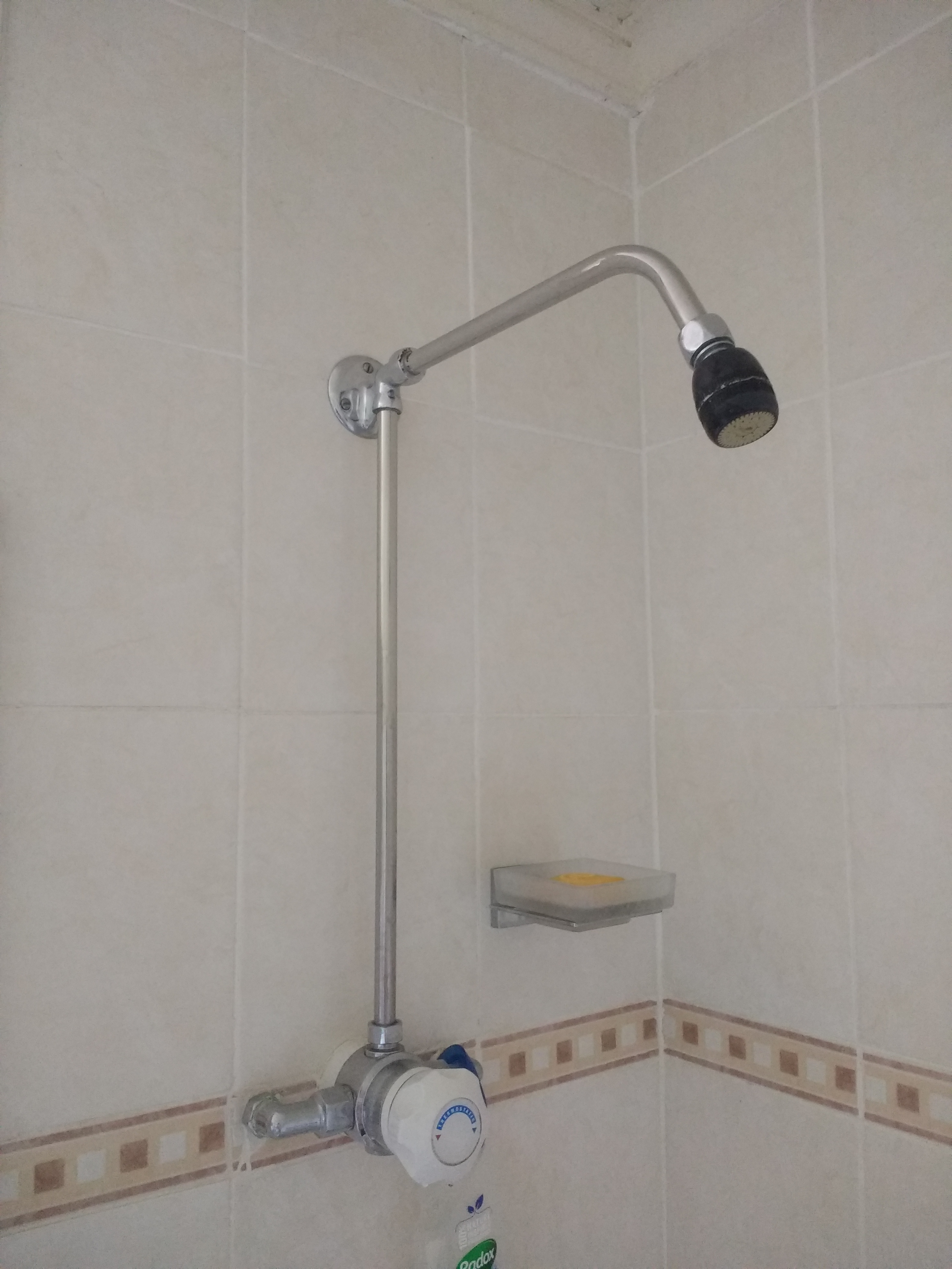

Here you go. General view, valve, wall bracket, old head, new head.
are they both the same thread eg the the new one screw onto the old head?
I think more like male iron to male iron, ie a 1/2” nipple barrel - brass would do as you could cut it down so none was showing . Will cost less than a quid.
Shower engineer, yes, that looks ideal. Thanks. Ben-gee - not sure I follow your suggestion all that clearly. I get that I could screw one end into my existing nut on the end of the shower pipe and the other into the shower head, but surely there'd still be the brass flange showing in between (although maybe there are chrome plated ones available too?). I also like the idea of replacing the nut at the wall end which has lost some of its plating.
