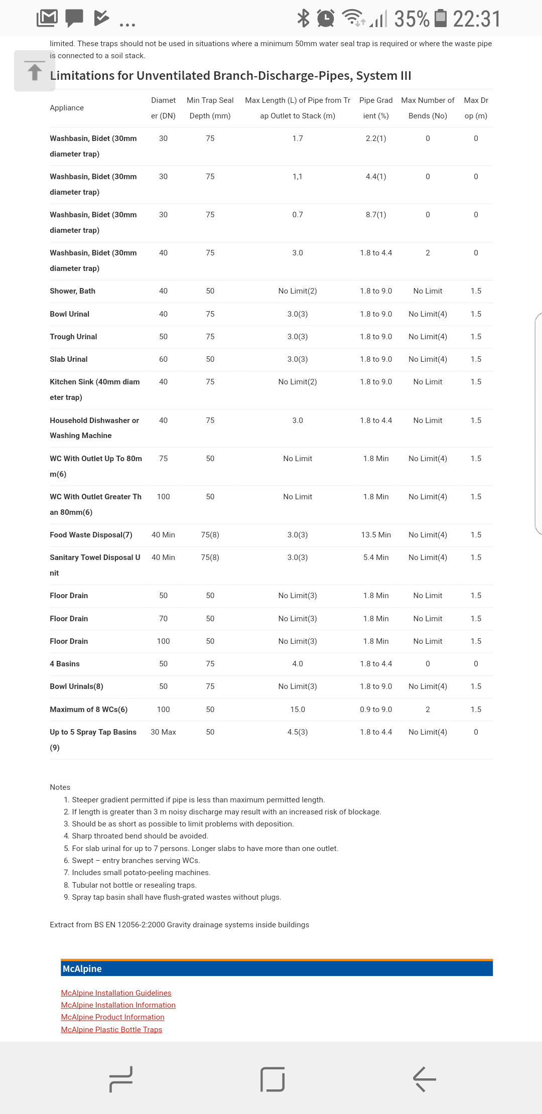

I understand waste pipe at 40mm is a max run of 3m I need to run about 7.5 to get to soil drop.
Is it possible to run sink and shower waste at 40mm at 7.5m if I include an AAV? Fall is not an issue as new floor is way above our exit void into small back loft which is not part of conversion.

I'd run it in 2" but where are you getting your max run measurements from? I wasn't aware there was a max run for shower wastes.
Why did you think there was no max??
Because it's something I've never come accross before. Even now when reading part H of the building regs I can't find anything specific to shower and bath wastes, the only appliances it mentions are toilets, bidets, basins and urinals, and from what I can tell that's on unventilated systems. Mcalpine state there is no max length for baths or showers but I guess that's not an official document. I've always gone off the basis of keeping my runs as short as possible which adequate fall but I'll admit I have ran shower wastes longer than 3m when necessary.
Ah. Well there is something about sprinkler taps on basins that don't have plugs so I see the logic.
If the shower has no plug, then the trailing discharge will prevent the trap from being left dry, even if siphonage occurs. But if there is a sink (do you mean basin?) also, then this is not relevant to this situation as the basin would indeed suffer from a siphonage situation.
Not convinced AAVs or waterless or resealing traps are acceptable in a new-build situation and I think the 'correct' way is secondary venting, but perhaps it's just a case of having to wait for the Approved Documents to catch up with modern practices.
