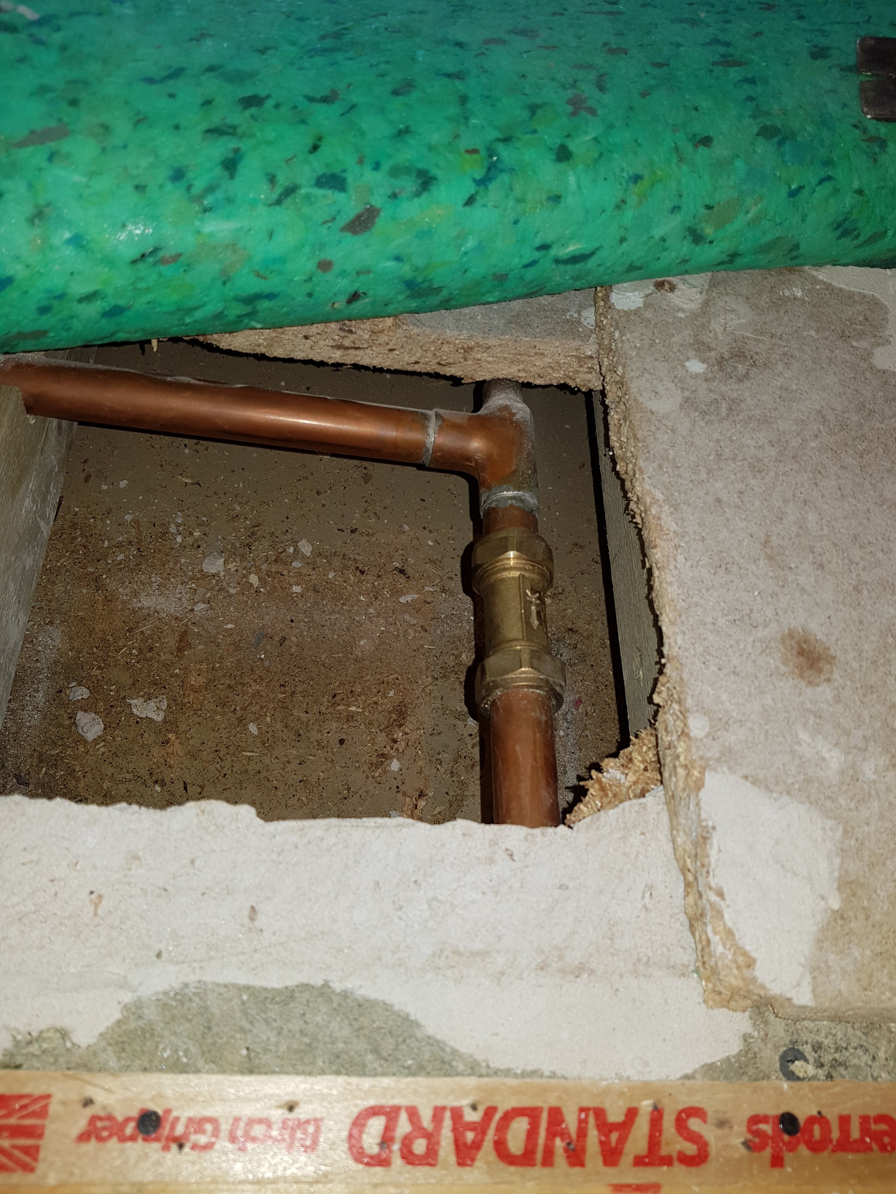

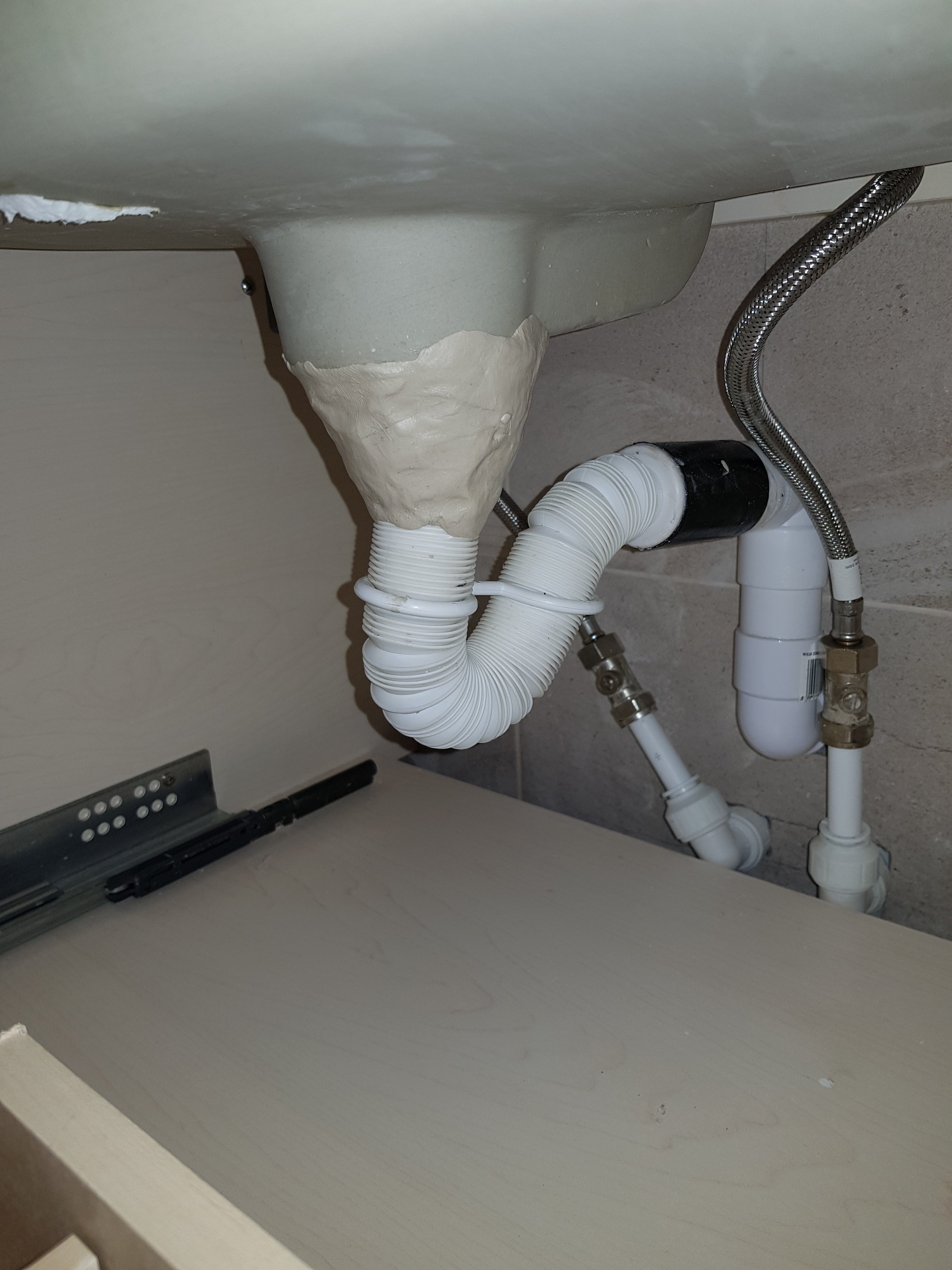

Been to a view a job today which has confused me. The first red flag I got was the basin trap (see pic attached) and the guy the customer got in to put in a new bathroom is refusing to be contacted after saying his work is good and not his problem.
The problem is that there is no hot water to the bathroom. There is a very low pressure flow but not hot. I traced a pipe and it does travel towards the cylinder which is about a meter away but doesn't get warm. There is a nr valve by the looks of it on the pipe (see other pic) which has stumped me why??? The customer said he fitted one of those toilet sprayers similar to one in last pic, and when he did water started flowing from overflow in loft. He said he knew what problem was and put the nr valve on h/w pipe which stopped it.

for a start them sprayers cant be fitted to mains cold water (need there own break tank as there classed at cat 5 risk) some are temp controlled them selves but most come with a tmv
would say theres not enough pressure to open the nrv

But as @ShaunCorbs says: it's the nr valve had the issue couple of months ago.
@ShaunCorbs @Matchless.plumb I know he's put the nrv on to stop water returning to cylinder, but what could be causing that pressure? The tmv? And it does seem that he's connected sprayer to mains. Just want to advise customer on their options. Chase the guy up threatening legal action and/ or pay me to put it all right for them which I don't really want to as @townfanjon and @Harvest Fields so helpfully advised :)
Yes will be mains cold with gravity hot
Your best option is to find the tmv and cap it do away with the spray

Would it worth removing nrv too or just leave it as is?
Can't have the sprayer against water regs
(No ifs nor buts)
Once the tmv is capped yes just remove the nrv

May even see if they want a proper basin trap fitted :)
tbh looks like it wants re piping can you get the other side of the wall / can you get at the pipe as it looks too high
unless your very lucky and theres just enough space between those elbows ;)
