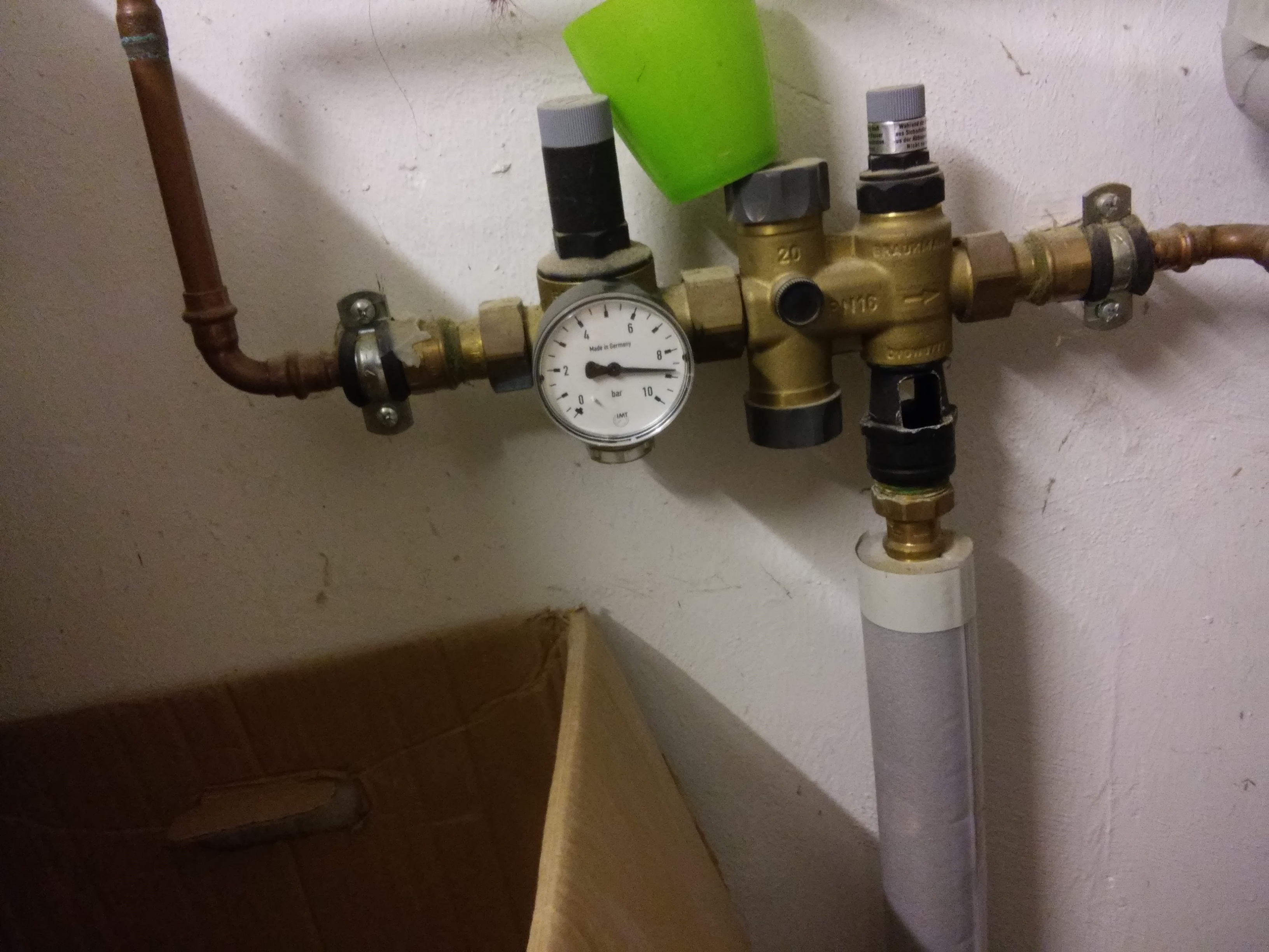

OK I will go and check again. As I said I am a little restricted movement wise. I'll get some pictures of the prv and meter.
thanks for your help so far.
OK I am a complete fool. The PRV's are on the central heating side of the boiler and as the picture shows the meter is between 2 prv's. So some how the hot water supply to the upstairs has caused this issue and I am not sure how to reduce this pressure safely. Pressure to the radiators is a nominal 1 bar and seems to be working fine.
How do I reduce the pressure safely.
Right following that valve leads to your hot water cylinder does it? You really need a G3 registered engineer out to look at it as you are not qualified to work on that particular feature. What you have there is a pressure reducing valve. Not quite sure of the tie in with your thermostatic valve failure but it could just be an unhappy coincidence.
