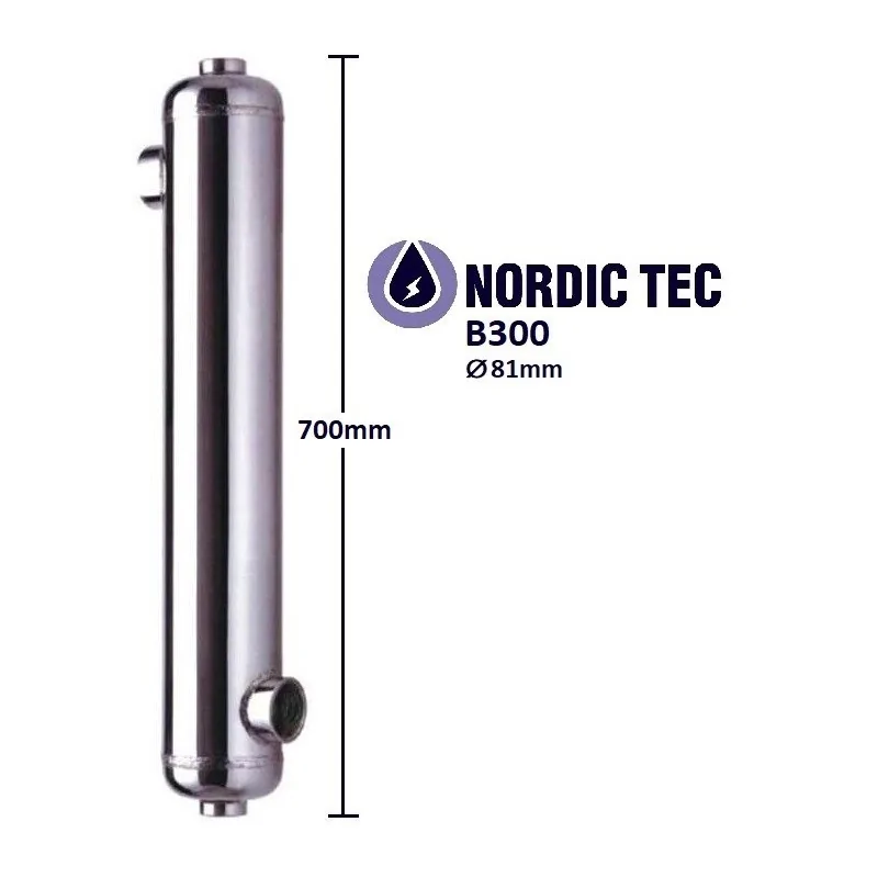

POOL HEAT EXCHANGER NORDIC B300 88KW (300KBTU/H)
Pool Heat Exchanger NORDIC B300 88kW (300kBTU/h) - https://nordictec-store.com/b-line-pool-heat-exchangers/171-pool-heat-exchanger-nordic-b300-88kw-300kbtuh.html
How suitable is this pool heat exchanger for our purposes? I am concerned that it may not be as efficient as a normal heat exchanger. Also, the suggested heat exchanger is 88kw, yet the new boiler will be 100kW.
I can order a normal heat exchanger with 2 inch connectors and to address the clogging issue I could use a CMX inline filter like this one here from Addey: MagnaClean CMX® | ADEY - https://www.adey.com/product/magnaclean-cmx The medium and large models can also be used inline.
I would appreciate your feedback.
Below is information for the pool heat exchanger:
POOL HEAT EXCHANGER NORDIC B300 88KW (300KBTU/H): €319.99 VAT included
Pool&Spa Heat Exchanger B300
Nordic Tec B-Serie
Nominal Capacity: 88kW
based on 60 °C difference between heating and heated medium (water to water),
with counter-courent work
Material: Stainless steel 316L
Heat Exchange surface: 0.64 m²
Connections: 2x 2" & 2x 1 1/2"
Important Note: If one of media is glicol, the capacity will be only 85-90% of nominal one
Nordic Tec B-Serie
Technical Details:
Nominal value 88kW (power/capacity) is based on 60 °C difference
between heating water and pool water (calculations are different for other media).
If there is other temperature difference, the capacity is following:
60 °C = 100%
50 °C = 85%
40 °C = 70%
30 °C = 55%
The nominal flowrates values are also required to achieve the declared capacity.
Nominal flowrates: 42/325 l/min (one of opportunities)
Plates don’t like dirty system so you might need a cleanable one with individual plates this won’t be cheap

Regarding PHE, because you need both the HW flow & return temps to be the same as the boiler flow&return then you need a very high output HX, around 550kw IMO with 3M2 hearing surface, a Nordic BA 60/50 might be suitable and give 100kw output. The BA -27-30, 175kw, 0.96M2 will only give ~ 33kw if my basic calcs are anyway correct.
If you email Nordic and state your requirements, ie boiler output, boiler flowrate&flow & return temps and heating flowrate& flow&return temps then they will suggest the exact fit for your system.

According to Nordic, for every 10kW of boiler output you need a heat exchanger surface of 0.3m2. Thus, a 100kW boiler would need a heat exchanger with a surface of at least 3m2, and they have advised me on what heat exchanger to get, preferably a brazed one.
The issue I am faced with is as follows. Our heating system has been badly maintained and I want to avoid the heat exchanger getting clogged. We recently placed a commercial 2’’ Magnaclean filter, but I am concerned that this will not be enough. I am faced with 3 options:
  1. Install a brazed heat exchanger, which in principle is ideal and the most efficient. However, they usually come with waterways of 1.8-2.2 mm depth and can be clogged, despite having a magnetic filter. Magnaclean’s CMX commercial MIDI and MAXI filters can work as inline filters and if suitable then I could possibly use them with a brazed HE. The CMX come with 50 micron replaceable filters, which will certainly limit any clogging. But I am not sure if this will impact the flow into the return of the heat exchanger.
  2. Install a shell-and-tubes heat exchanger (sold for pools by Nordic), which will not be as efficient as a brazed HE but will not clog easily. Our installer prefers this method for our circumstances.
  3. Install a gasketed HE, which can be cleaned easily. Danfoss Sondex makes a gasketed HE that has 4.3mm depth in the waterways and thus would clog less and it is cleanable. However, they are also more expensive, and in theory they can leak.

A shell&tube heat exchanger might require multiply times the heating surface of a PHE but (thermal) efficiency doesn't come into it except the exchangers have no external lagging/insulation.

A Nordic B3600 Swimming Pool Heater, 1060kw, 6.4M2 might do the job for you, I'm assuming the heat flux at 2850 w/m2.degC, Nordic will advise.
@John.g
In reply to my pool heat exchnzger query, Nordic suggested the pool heat exchanger B2400 at 704kw, as it has a surface of 4.47 m2, not too far from the required 3m2 for the 100kW boiler . However, Nordic's stronger preference is a brazed heat exchanger Ba-95-40 which is 1000kw and has a surface of 3.8m2, which is cheaper but more efficient. As discussed before, my concern is of a brazed HE clogging as our system is old and had been poorly maintained. Keep in mind that one of our requirements is to have 2'' connections, as this is what our single pipe system has.

The required 3M2 to give 100kw output is based on a PHE, the required surface area of a S&T to give the same output (100kw) with the same flowrates and flow&return temps and LMTD is far higher than using a PHE because the more turbulent flow in a PHE gives a far greater (IMO) heat flux, so to compensate, the surface area of the S&T must be far higher, this is why they say its more efficient, all this means is that you have a smaller Hx, they both give exactly the same input/output., ie 100% efficient. If you have the space to install a S&T if you think it's easier to clean (and it is) then I would install it.
I am a little surprised that Nordic sized the S&T at 4.47M2 (704kw) but they have the requirements?. I would be far happier with a 6.4M2 (1060kw).

Going back to the heat exchanger, I will discuss again with Nordic the right size for my circumstances. John you are correct that plate HEs are indeed mroe efficient because of turbulent flow conditions.
Assuming (i) we recently installed a 2'' Magnaclean filter, and (ii) our system has not been well maintained over the years and clogging the HE is a possibility, which of the three options below woudl go for?
  2. Install a shell-and-tubes heat exchanger (sold for pools by Nordic), which will not be as efficient as a brazed HE but we will get a larger size and will not clog easily. Our installer prefers this method for our circumstances.

I would also go for option 2, like your installer, have a good look at the attachments again as I would strongly suggest the 6.4M2, 1060kw Hx as your rads, if based on the normal "50deg" will still give 72% output and if oversized originally (by a factor of 1.39) then you will still get 100kw. If you opt for the 704kw Hx then you will only get ~ 70kw.

Option 1, depending on how clean you can get the system is probably a better choice than option 3 despite option 3 having bigger waterways and the ability to split it for cleaning, my experiences of this type (3) of PHE was on a number of ships I sailed on, they needed very careful re assembly with the correct torque settings for the tie bolts etc after cleaning, the rubber gaskets frequently were torn on splitting them and any new gaskets had to be glued on, if you go down this route then who will disassemble, clean and re assemble them properly?.
Option 1, if you are prepared to treat the Hx as a throwaway item should it get plugged is far less trouble IMO but of course may prove very expensive in the long run.
My preference is still option 2.
Of course, as suggested above, by others, you could go for a LLH, with suitable filtration, both magnetic&particle, of the boiler return, you might find that the boiler Hx might last for years and its replacement cost may not exceed and may even be far less than the maintenance cost of either of the PHEs.
