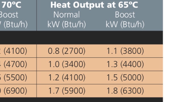

2.2kw at 75 degree or 1.7kw @ 65 degree
I could go for SS5 or SS7 to be adequate for room size but always found they exaggerate btu outputs
Picture shows SS3 up to SS9
