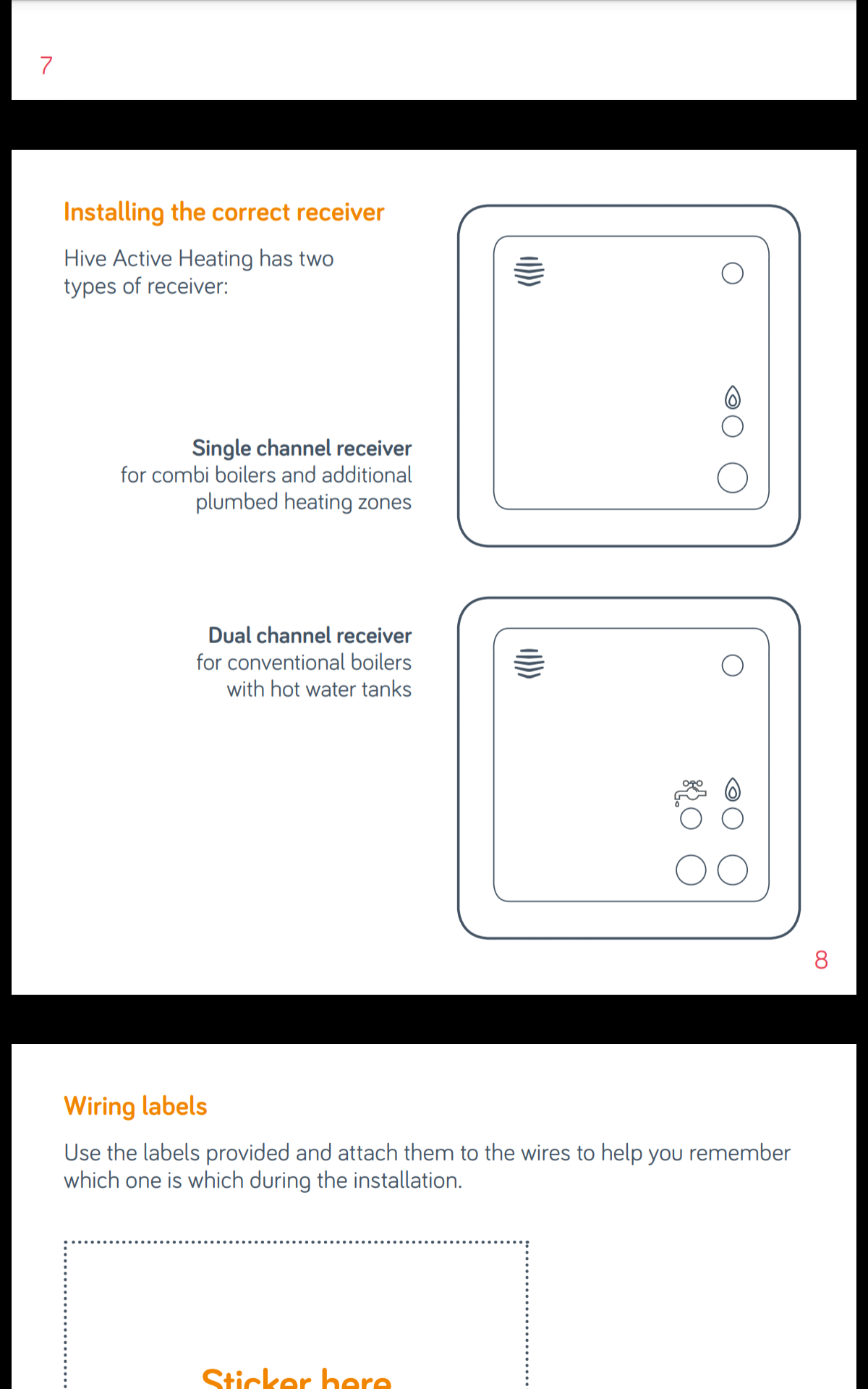

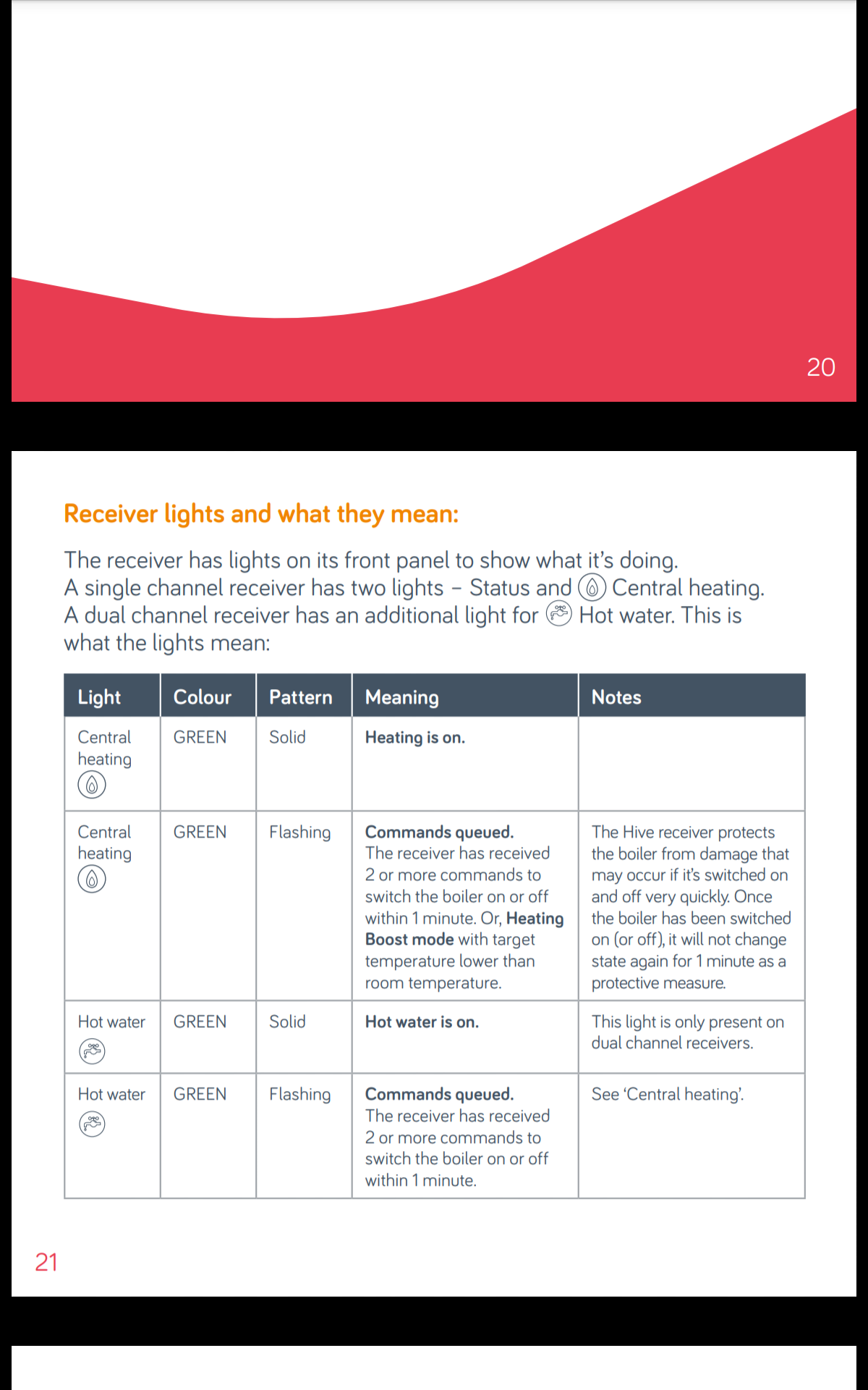

There are two types of hive it looks like you have the correct one as there are two lights in the right hand corner follow the directions below you will know what you system is doing. Cheers kop
Cheers for that mate but also when hot water schedule is on hive flashes a green light instead of a solid light when central heating is on... On the pictures iv sent is there any more heaters on that tank? What are the yellow and silver box at the bottom etc?
Yellow box is your heating valve which will control the on and off times of your heating and room tempreture , the silver box is the hot water valve which will control your hotwater tempreture to 60 degrees and the on off times set in your hive thermostat , kop
