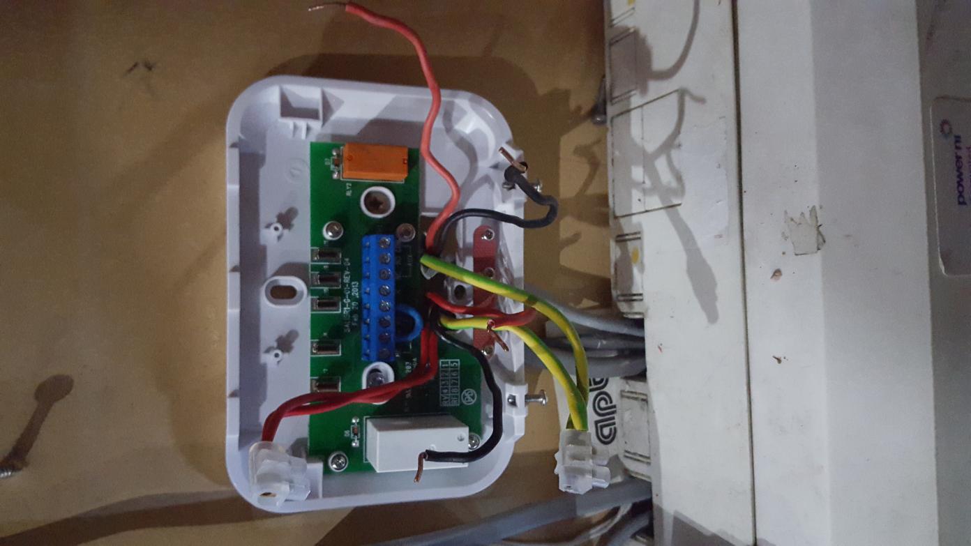

My current oil burner system is 1 zone only which heats all radiators and water together, at the boiler end I have 1 black wire and a earth going into a double switch, one for pump and one for burner. Inside I have a wired thermostat which is terrible so I turn it up full blast to get the heating to work and I have a clock timer switch under the stairs to turn the heating on and off.

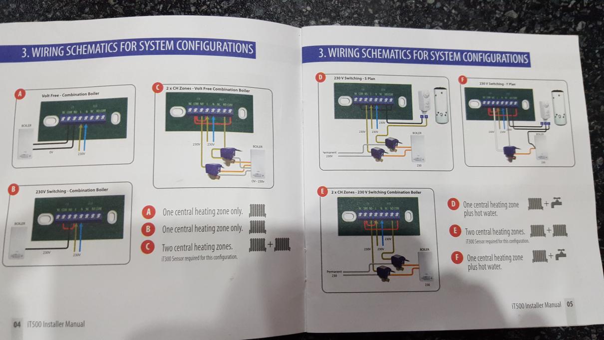

Ive tried to wire the new system as best I can but with no joy, ive attached a picture of the wiring where I removed the old timer switch and left the current wires on show and a picture of the different wiring options.

where your instructions show you trying to wire a combi, is your boiler a combi plus using choc blocks for starters?

No there are 3 options on the instructions for a combi, mines is a grant boiler with a sterling burner, normal oil burner not the combi type
all you need is a perm live, neutral and earth, then a switched live for it to work. If your not able to work out whats what, get someone in.............
ok so I know which ones the mains live/neutral/earth its the switching live that's throwing me with the way its currently wired
I hate to agree with above comments, but when I hear you have an earth going into a switch, might I suggest the wiring you have already is substandard?
I mean, it sounds like someone's using a CPC (earth cable) as a switched live or a live. And that isn't good or safe really. Earth cables are not designed to take current except in a fault situation.
