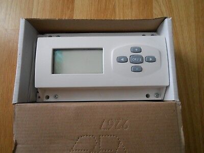

I know of a UFH center like yours with the timer module fitted. I have been looking around to find the "Continental" Heatmax chrono module, but this product seems to have disappeared and the item badged with other names - the only recent equivalent has the "Watts" name.
This is what the module is like:
and just for interest I see there's one currently on eBay:
Whilst this appears to be 'the right thing' I am not guaranteeing it would just plug in and work! We need someone experienced with fitting/ maintaining these to confirm different branded modules of this type can work together. I think the design is at least 10 years old - the system I've seen was installed in 2007.
It seems the industry has moved towards thermostats having time clocks in them, so different rooms can have different timings, rather than one central clock turning everything on and off (or doing setback) together.
