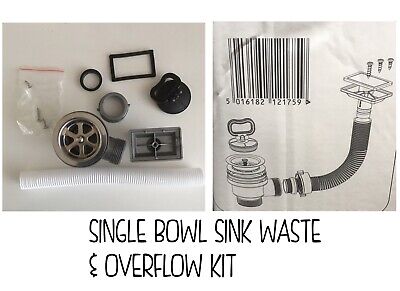

Would this sort of thing be what I was looking at?:-
Looks like that would do, if the size matches.
You may not need the chrome / stainless grid in the bottom of the sink, it looks like the sink is designed not to have one and the one in the kit has square corners so wouldn't fit.
Also the sink has a counter sunk hole for the screw, the kit ones are raised head.
Have you got the waste for the main bowl and does that bowl have an oveflow or does it overflow into the small bowl?
This may do, it's probably intended for when the sink oveflows to the drainer hence it's description single bowl.
The outlet on that fitting is going to come out horizontally, which is probably going to cause build up of fat, rotting food, etc. and a continual continual foul smell.

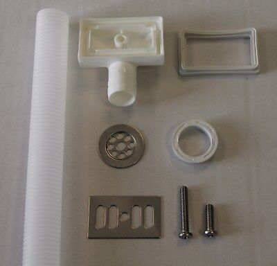

Here is a suggestion for a bodge 😀
If the underside of the sink is fairly flat, you might be able to use the plastic component from this, complete with gasket, on the underside:
and then a grille, something like this, on top to spread the load from the nut and bolt you would need to find:
I suspect the dimensions would not be quite right, but it might be functional!
As mentioned, probably easier to buy a new sink unless you enjoy a challenge!

OK, so ignore my previous suggestion.
Would this sort of thing be big enough?
(needs a gasket I think)
The metal grille I suggested above might be the right size then?
