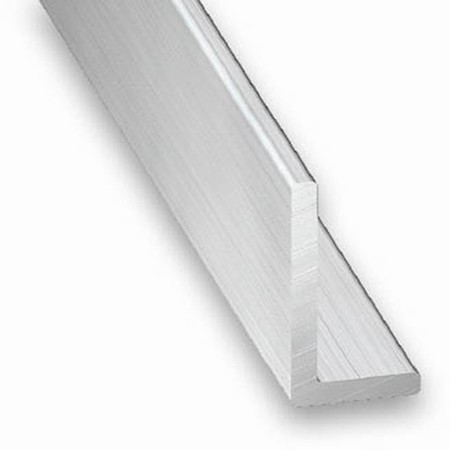

Mmmm...I like Shaun's option if you could find some aluminium channel deep enough, that seems the neatest and probably cheapest. Alternatively get a piece of channel made up in aluminium or even stone to match tile.
Ok, thought about it. How about using two pieces of aluminium unequal channel to make up the right sized U channel? One side will be lower than the other but it won't be noticed if on the inside of shower. You could just use a single piece but then you'd see the filled gap on the inside.
