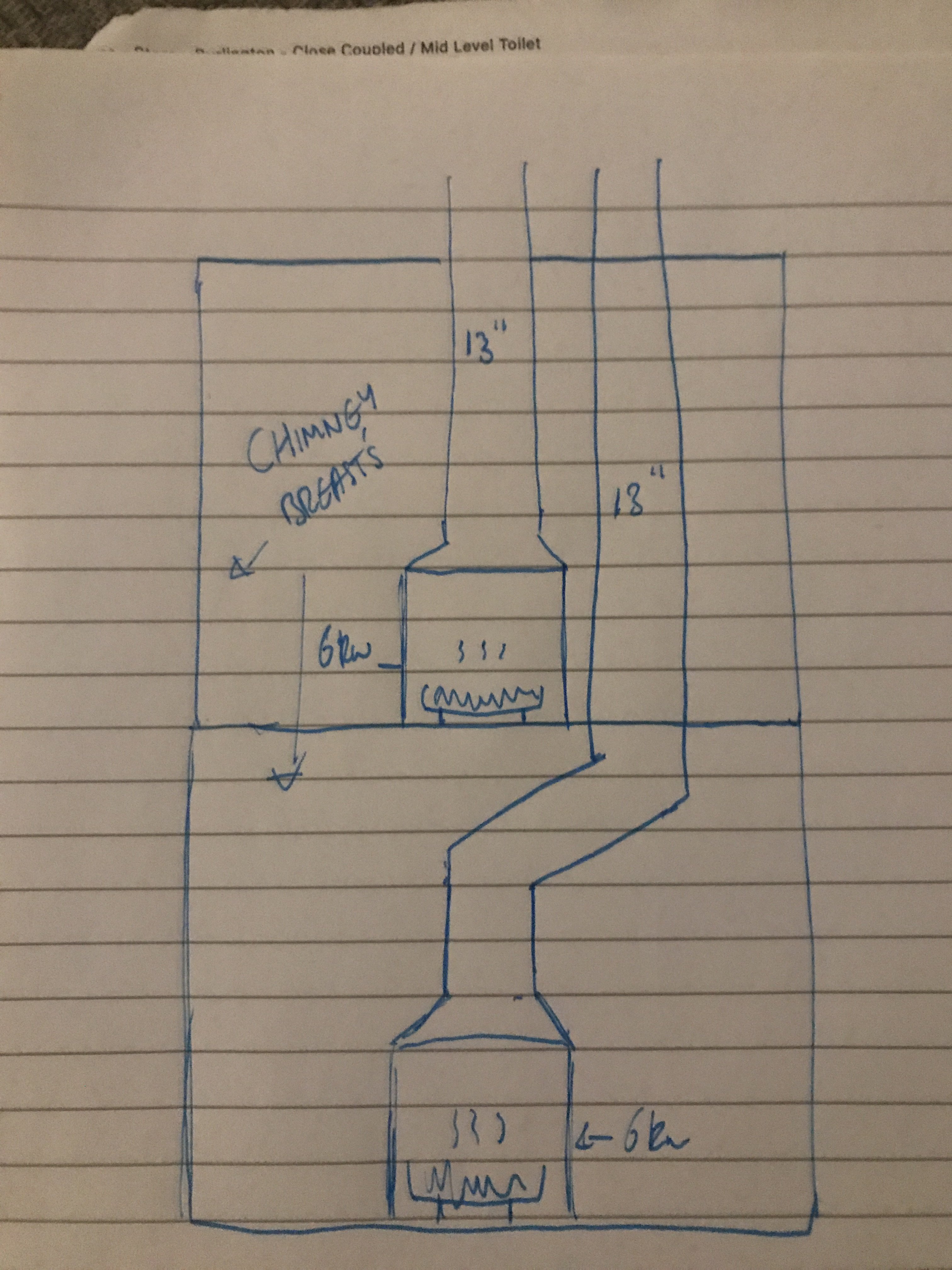

They are building a chimney breast from new, there are 2 basket gas fires rated at 6kw each. They have built the builders opening and attached a chimney gather on top. This is where my question lies, they have used from the gather a twin lined flue system but with a diameter of around 350mm? One for each fire.
The client, my friend asked if this was overkill as the chimney breasts are not huge and take up a huge chunk of there 3 rooms in which the chimney breast is. I said I always thought the minimum was 125mm/5 “
The builder has said he’s asked many people for advice and is adamant that they are the correct size. What are your thoughts on this?

They are hand made and all the manufacturer gave were the dimensions for the builders opening. If you were to put a flexible flue liner down a chimney and seal off the opening with a debris plate then I’d imagine you’d use a minimum of 5” diameter flue? You wouldn’t and couldn’t drop down a 13” twinwalled flue (inner diameter ) !
So just curious as to where he got this huge diameter from as he claims he’s asked many people. And my client is now asking me if he can get someone else in could they decrease the size of the flues.

As said I haven’t got a qualification for fires so don’t know too much about them. The builders opening goes to a gather plate then on top of that is stainless steel tube going to outside through the roof. As said 13” seems overkill when the regulations I’ve read a gas fire must have a minimum diameter flue of 5”.
Even with a 5” flue they are like 20% efficient so with a 13” flue it’s going to be 0% with huge drafts. Like with water you can have too big of a pipe which will produce a linear flow, surely a flue should promote a turbulent flow.

But the client isn’t happy as it is humongous and ugly, and he just asked if I could give advice on whether they need to be that big. One flue run is 5m with 2 45’s the other is maybe 3m straight run.
The builder is adamant and is not going to change them as they are now enclosed and decorated. But client is thinking of ripping it all out and start again and use smaller pipe. I personally would be happy using a 5” pipe as from what I’ve read. But I can’t do the work.

350mm is way too big, it almost certainly should be 175mm, plus the the second skin, so around 225mm in total.
View attachment 37204 I personally would be happy using a 5” pipe as from what I’ve read. But I can’t do the work.
You would be wrong.
