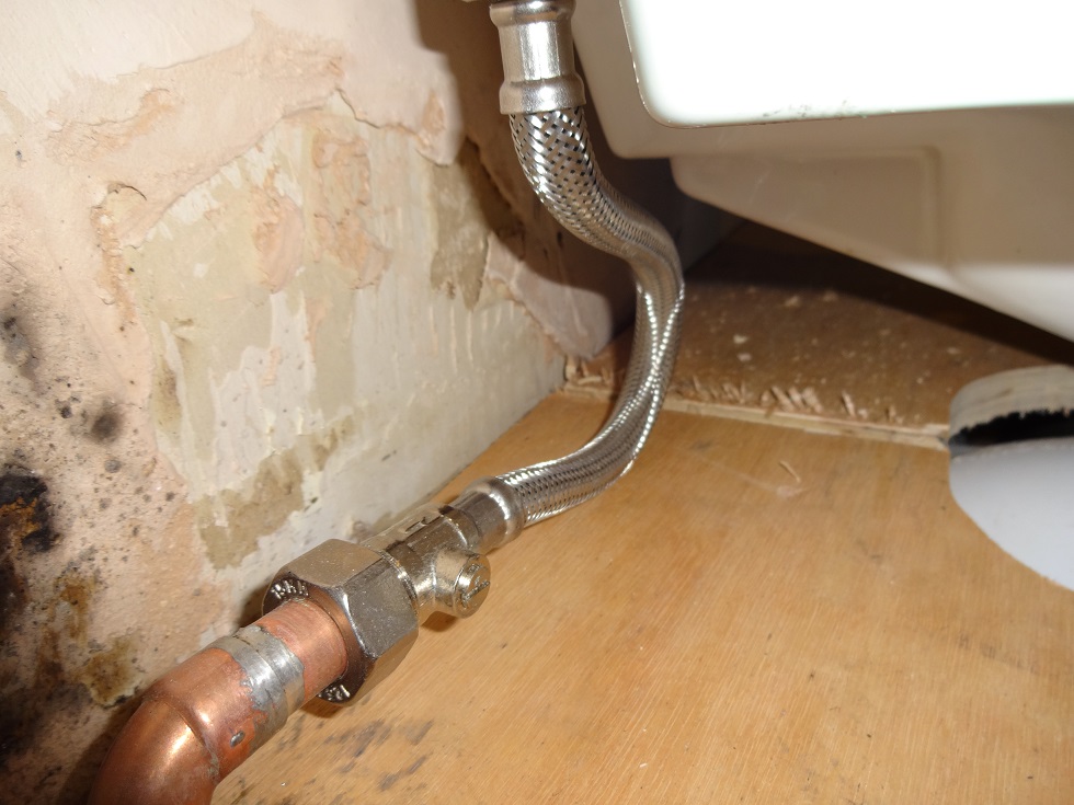

Can someone tell me if the flexi connector in the picture on the toilet fill has too tighter a bend on it i have asked my plumber if he would connect the toilet in copper because 1 I think it would look better and 2 i think it is bent so much it may fail prematurely.
He said he would change it but would not guarantee the work because he had lost count of the times he had been called out to toilets that were leaking due to cracked copper connections on the cistern.
PLumber or handy man I only ask due to the burn marks on the wall
Easy enough to do in copper
Plumber with so called 19 years experience.
Must have been 19 years largely wasted then. :p
All copper and with a straight copper soldered connection (tap fitting) would have been easy.
If the pipe could have been moved if possible to come up immediately below the fill valve would have been neater and my choice.
Nothing is neater than keeping the pipe well hidden
That flexi isnt good but its easy to criticise at the end of a job or from a bad picture. We dont know what work the plumber has done, what he has had to work with/ work aroundand sometimes what materials have been supplied
