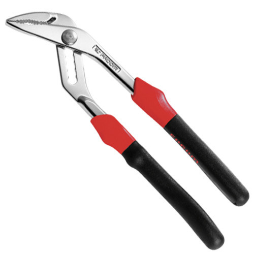

one of these are good ,if you can get in
I've a pair similar which I'm going to try with. My biggest problem I think will be gaining access to the backnut, apparently the entire plumbing for the tap is boxed in within the kitchen units... :/
As Kris said, you need to disconnect the hot and cold first. And if you can find it , there's a box spanner that'll fit that nut, I've got 3 or 4 different ones. Believe it or not I actually think I bought one of them in B&Q

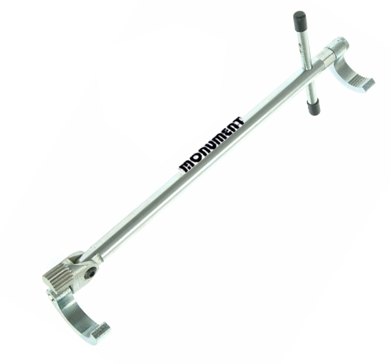

Until it get's tangled up with the boxes of soap powder, bottles etc etc that are under any sink. Monument-2-Jaw-Adjustable-Basin-Wrench.jpgyou need to get yourself one of these think of it as an investment.
Until it get's tangled up with the boxes of soap powder, bottles etc etc that are under any sink. View attachment 19337you need to get yourself one of these think of it as an investment.
I already have an adj basin wrench, (Adjustable Basin Wrench | Adjustable Wrenches | NoLinkingToThis) but the backnut to the tap is 35mm and won't fit. Plus, I have a sever GAS problem (Gear Acquiring Syndrome) and have vowed to steer clear of screwfix for a while :p
How wide are the jaws on the monument? brrrrrrft lol
You get two jaws designed for 1/2" & 3/4" tap back nuts but in truth the 3/4" will get on your nut.
If not
there is an option extra large jaw.
