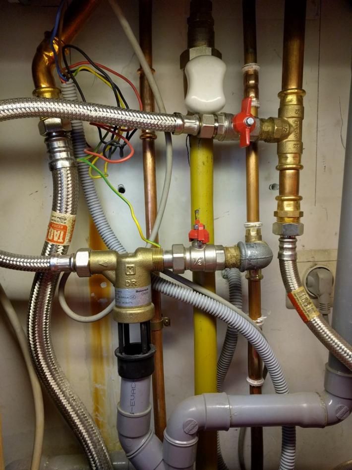

So, I took a picture of the system and it is the following
I thought that the upper valve was the gateway to the main supply, then I disconnected the hose on the low end and turned the upper valve.. I was unlucky this was the boiler side and all the boiler water slid into the bucket. Boiler is now red light, pressure 0.1 bar and out of water. Some mud (a few, less than 1 square cm pieces) slid in the bucket.

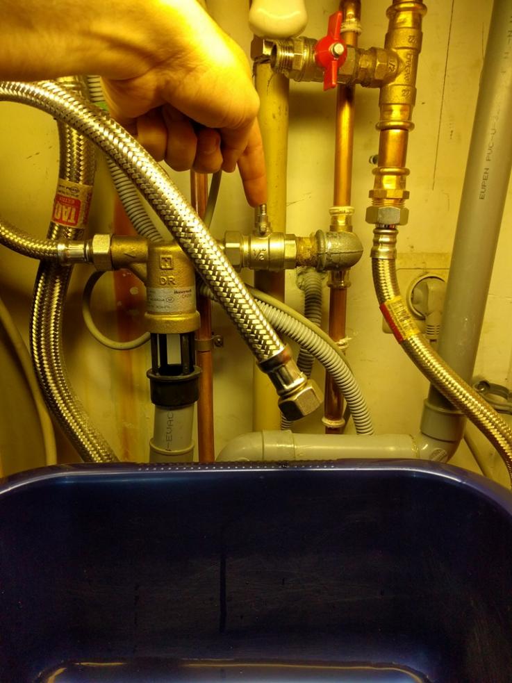

Then I disconnected the hose on the upper side and turned the lower valve. Nothing is flowing. I took the valve out and tried with {I don't know the name of the tool, but it unscrews hexagon screws} this tool but still no water flowing.
I lost the valve in the process (it fell in the gap between the wall and the wood) but I can easily replace that. Here is a pic (my hand is the main supply valve, the valve is missing, no matter if I try to unscrew this nothing flows)
So, what should I try to do in order to unscrew this? Maybe I should unscrew several times and not only 90 degrees? The screw appears to unscrew indefinitely now that the red valve is not attached on it. Or maybe I have a problem with my mains supply? Every other tap in the house has water normally.

but if you are determine to have a go the brass thing with DR & "Honeywell" on it is what we in the UK would call a Type CA Disconnector it is there after the isolation valve to protect the mains water supply from the dirty heating water. It is this that has likely broken & is not allowing water to pass, if this is the case you will need to get a replacement.
Why have you taken the red handle off of the lower valve ? is it not turning ? they are only 1/4 turn, if the handle is across the pipe the valve is off, if it is in-line the valve should be on.
If you can turn both valves off i.e. across the pipe, you could try to undo the silver nut on the lefthand side of the lower valve & the one on the other side of the Honeywell valve, then remove it. Place a bucket under lower valve & slowly turn on to see if there is water & the valve works.
If it does, temporary connect the hose directly to the lower valve it looks like the threads should fit.
Turn on the upper heating valve then slowly open the lower valve allowing water to fill heating as you have done before, no more than 1 -1.5 bar.
Make sure you turn off both valves & disconnect the hose until you get the Honeywell valve replaced.

Your guess about the Type CA Disconnector being broken is probably correct. When I turn on the lower valve, water is not flowing, however, water is leaking from the bottom of the Type CA Disconnector. When I turn off the lower valve, this leaking stops. So, it must mean water arrives to the CA Disconnector, but doesn't go through.
I took the red handle off of the lower valve because, reading different posts on the Internet, there was this piece of advice, to remove the handle and try to turn the screw using another tool. In the process, the handle fell in the gap between the wall and the wood furniture, so I don't have access to it. I will have, among everything else, to buy another handle for the lower valve.
Regarding your advice to remove temporarily the CA Disconnector, which I presume you propose to me as an ad hoc solution to pressurise the boiler again, I do not have the tools to do it. The silver nut you mention cannot get undone that simply :) Once again, we will call in a plumber tomorrow and this shall be fixed by replacing the CA Disconnector.

Just to let you know. The plumber came in today, he disconnected first the CA Disconnector, it was not blocked. Then he disconnected the valve, it was not blocked. It was the corner junction between the main supply and the valve that was blocked with mud and calcium. He cleaned it up and now it all works again.
