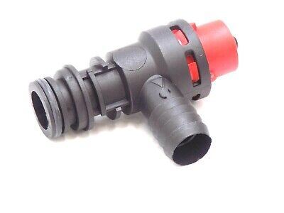

When you replaced the PRV did you replace the full body or just the PRV head?
I tried cleaning the old one first and when that didn’t work I replaced the prv. This one:
