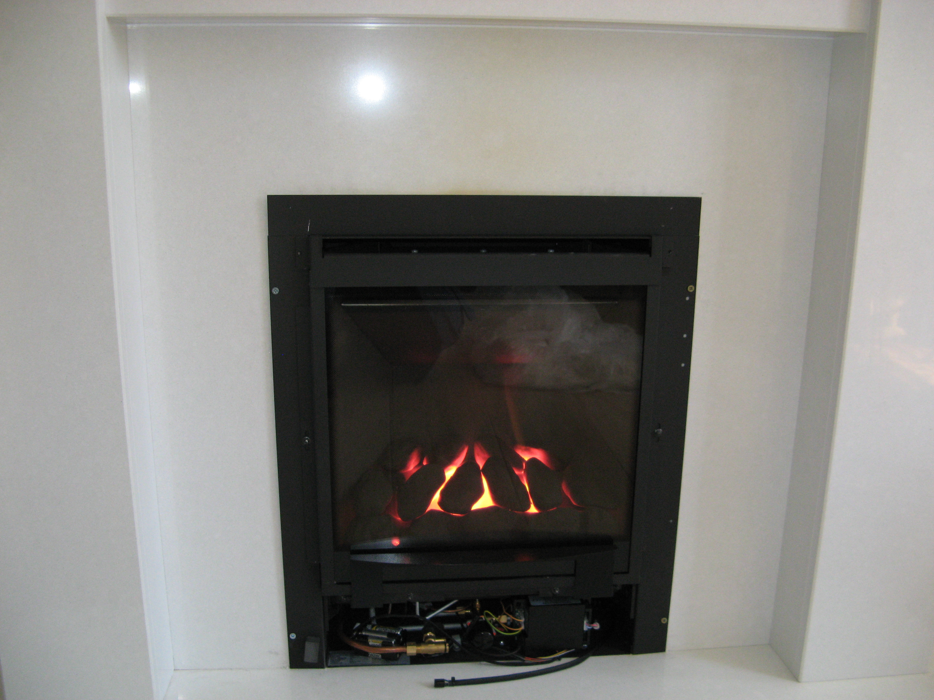

Post some pics of the fireplace

Here are 2 pics of fireplace and fire (with trim etc removed) although the stain hasn't come out very well.

That is, I believe, a Paragon/Matchless High Efficiency fire. Is the back panel marble or a composite material? Paragon do not recommend that fire on composite materials due to the high temperatures. Alternatively, it COULD be "spillage". You may wish to contact Paragon tech to ask about their recommendations.

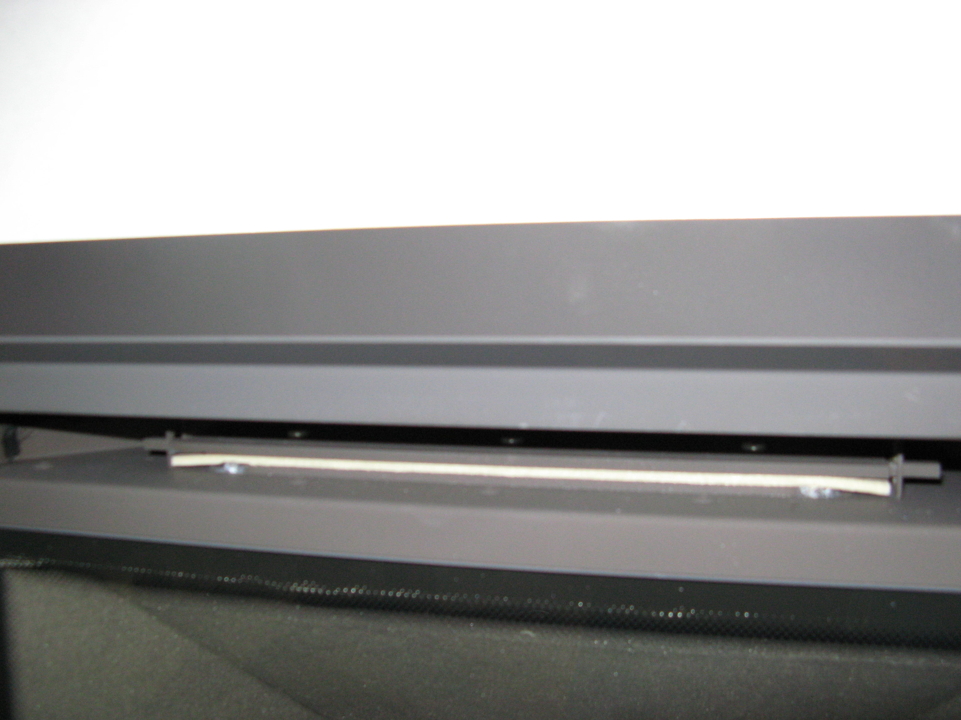

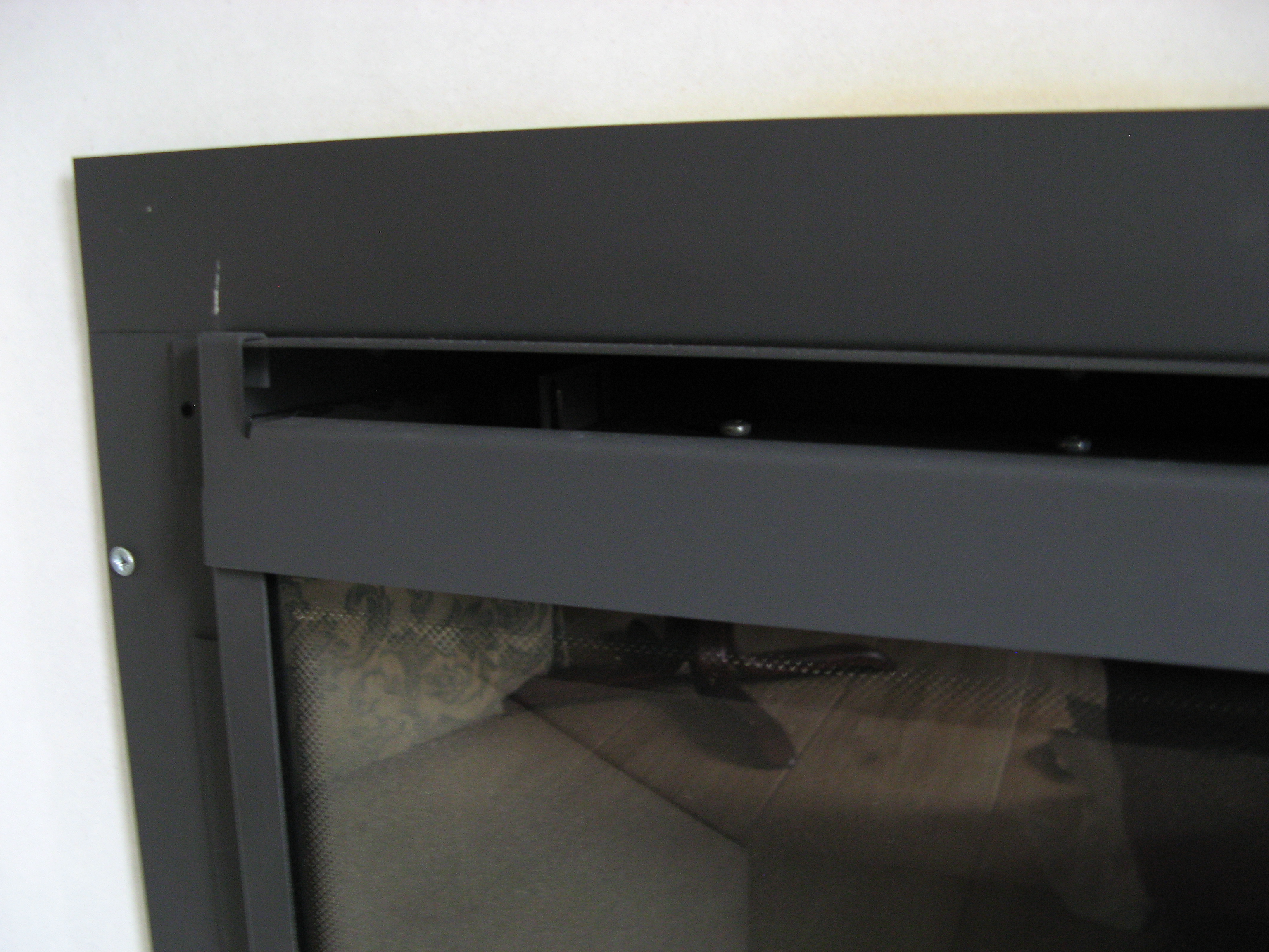

I assumed the "black lift-up flap" was the flue spigot. I now assume it us the shield that fit a in front of and above the glass. The only thing that can flex there is the front of the heat exchanger. There is a thin gasket so if the panel flexes back I suppose it could create a gap This being the case then the slight increase in input pressure would not make a difference
Have taken 2 more pics. The first one shows the black flap across the middle of the photo (it can also be removed). The 2nd pic shows the black flap lifted up allowing you to see on to the top of the fire box. It is that bit you can see including the white foam-like strip that the engineer said was flexing up when the fire was on. I don't know what it's called.
