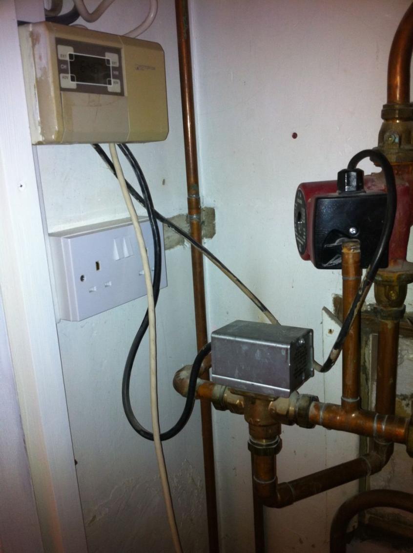

This is what I have there at the moment.

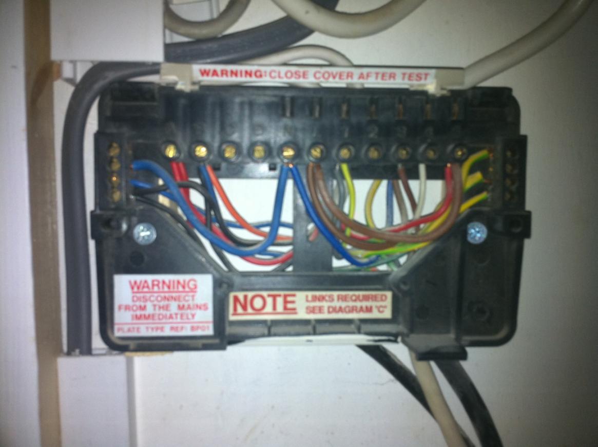

Your pumps are now wired independently as opposed to before the timer would automatically select hot water when the heating was called for. You'll need to change the wiring so the pump runs for both. Depending on how it is wired it could be a simple job or require a relay. Have you got a wiring diagram?
Off the top of my head you could wire the 'H/W' pump off the switched live or pumped live off the boiler depending on what boiler you have? The hot water pump will then run whenever the boiler is on, the heating pump will run whenever heating is called for.

Jumpers were present on the EP2001. Nothing to be seen at the back of the EP2. Seems that those did the job then.
