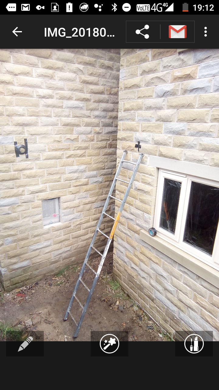

I am on a site and the potential flue arrangements on 2 properties is causing me concern. It has been ok'd by another gas safe engineer who no longer works there. So wondered if I could have some opinions? I have uploaded a picture. The flues are 1800mm apart diagonally. And the flue shown by the flue terminal cover taped to the wall (the other flue is the cross taped on the adjacent property) discharges at 450mm to the adjacent properties boundary, though a flue needs to be 600mm from a boundary when facing it. You are apparently allowed to get over this if you use a plume kit and angle the flue away from the boundary so that it can go up to 600mm as long as you are at least 300mm from the boundary. What are your thoughts acceptable? Hope that makes sense.

Thanks, the one with the collar taped on has a property the other side of it, is a semi detached. The only other option with that boiler/flue is to get them to slightly change the kitchen layout ( Joiner hasn't first fixed the property yet). So that the kitchen is slightly bigger and the downstairs toilet slightly smaller. So the boiler can go in the kitchen on this stud wall separating the kitchen and the downstairs W.C. Wall would need altering to give clearance of over 300mm from the window to the boiler flue.

Thanks I go back to the architects. Its not correct with the boundary begin 450mm from the flue. Gas safe state a plume is acceptable but not ideal. Do you see the other flue being 1800mm away diagonally as a concern also? I know if there facing each other needs a gap of over 1200mm.

So the manufactures have said its acceptable. Reason being that the flue is 450mm to the boundary. Which is acceptable if a plume kit it fitted as it takes the 600mm distance from a boundary down to 300mm. The distance between the flues is 1800mm at an angle. Which is greater than the minimum required 1200mm if flues are directed towards each other. So apparently complies with regulations.
