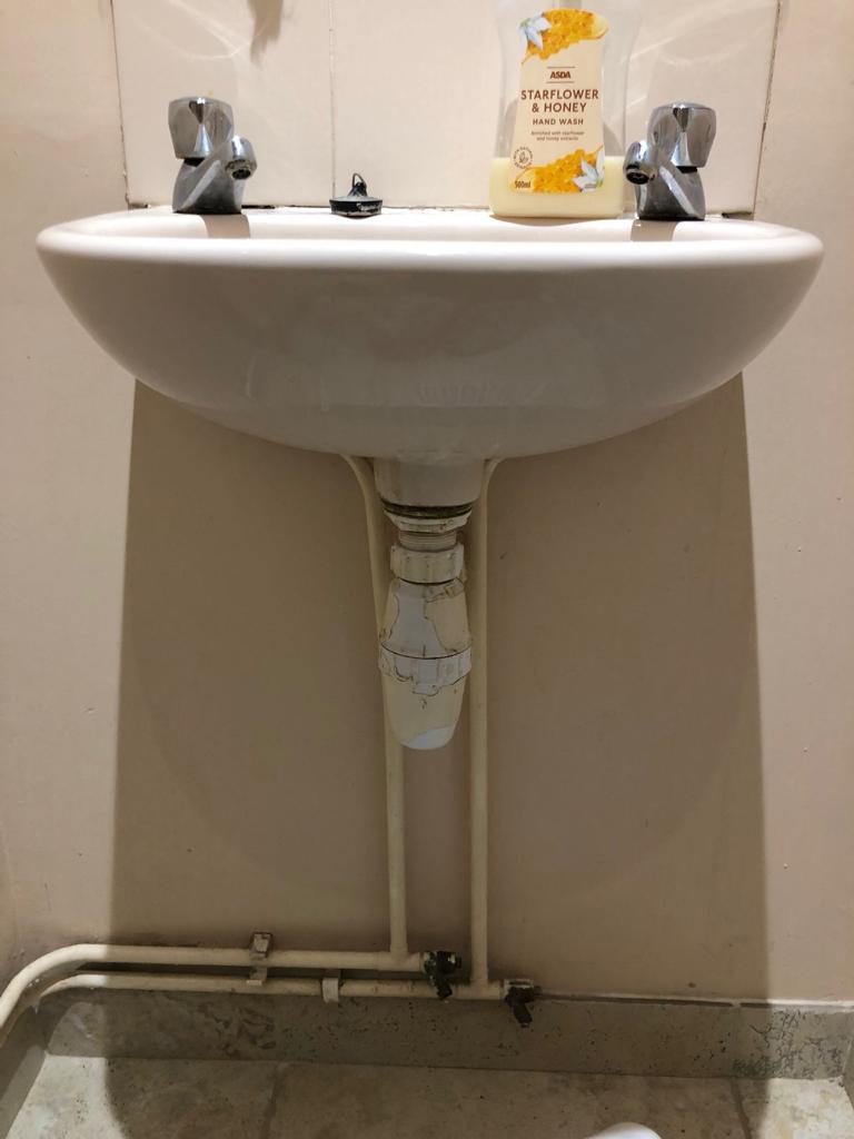

Looking for some advice. Currently modernising my downstairs toilet. I am wanting to hide my hot and cold water feeds to basin. Wall type is dot and dab onto breeze block. Use of copper or plastic is fine. Can anyone explain best practice chasing them into walls and if need to insulate/ lag them if bonding will be put over the top.
Photos attached is the pipework.
Any help would be appreciated.
Use either plastic or copper pipe 15 or 10mm, when chasing in make sure you have at least 10mm clear to the face of the plasterboard, (if using copper wrap duct tape along the tube to completely cover it) firmly fix the pipes, then cover with silver foil tape and plaster in.
Thanks for that. What is the 10mm clearance for? Is duct tape a means to protect the pipe? is the silver tape for plastic so it can be identified when concealed?
Also if it ok to have soldered joints in inaccessible areas. I know its best practice not to have push fits in areas that you cant get to but just thinking about copper?
thanks
Thanks for that. What is the 10mm clearance for? So you can plaster over Is duct tape a means to protect the pipe? Yes for copper to prevent corrosion is the silver tape for plastic so it can be identified when concealed? Yep
In my opinion it's OK to have soldered joints in inaccessible areas, pressure test them before covering to ensure they are sound.
