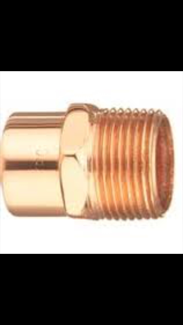

    What I meant was. On a domestic valve you'd just use your adjustable and grips. Where's as the ISO valves I'll be using on site are used with a male copper thread both sides.
    [​IMG]. As there 54mm would you still use stilsons on the copper? Just worried they may round them off a bit.

    ShaunCorbs Trusted Plumber GSR Top Contributor!!

    Is the copper thread liable to cross if tightened to much? I'm just thinking that copper is quite soft
  16. snowhead
    snowhead Well-Known Member
    Once it's started it won't cross.
    You'll struggle to cross thread 2" by hand
    • Like Like x 1
