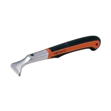

I've tried out duel x and soot breakers. Could be useful with really bad chamber. But settled on 10mins with good old brush, scraper and vac.
one of these is my primary weapon
sorts out most boilers, but if they are particularly manky i break out this

Surely it will work with scraper ...
I used to use scraper too but sometimes the chambers are so big or awkward you can't rely on a brush or Hoover. Sometimes there is no space to get far enough with the Hoover therefore I'd use a chemical which will burn the rest of stuff away.
