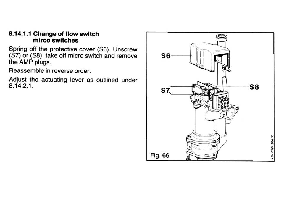

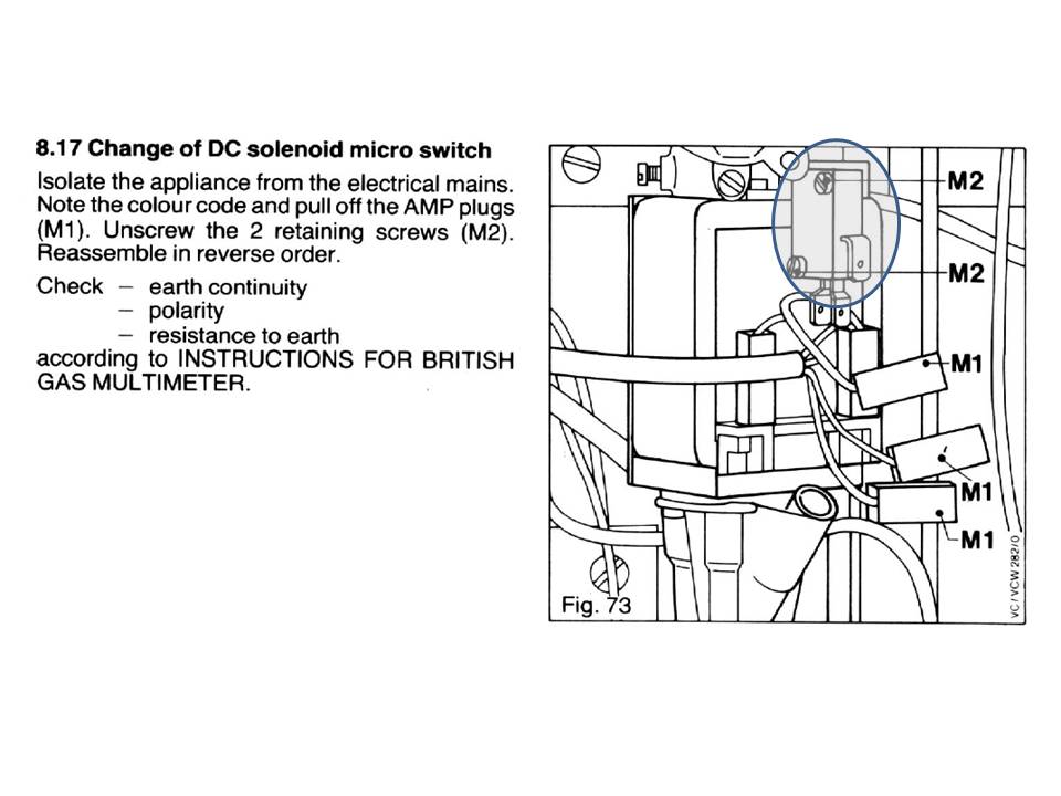

Sounds like back main pcb faulty,however could check micro switched making correct contact in silver box on top of servo unit

I show two screenshots below from the boiler manual. Which microswitch are you reffering to?
Screenshot 8.17 or 8.14.1.1?
Many thanks!
