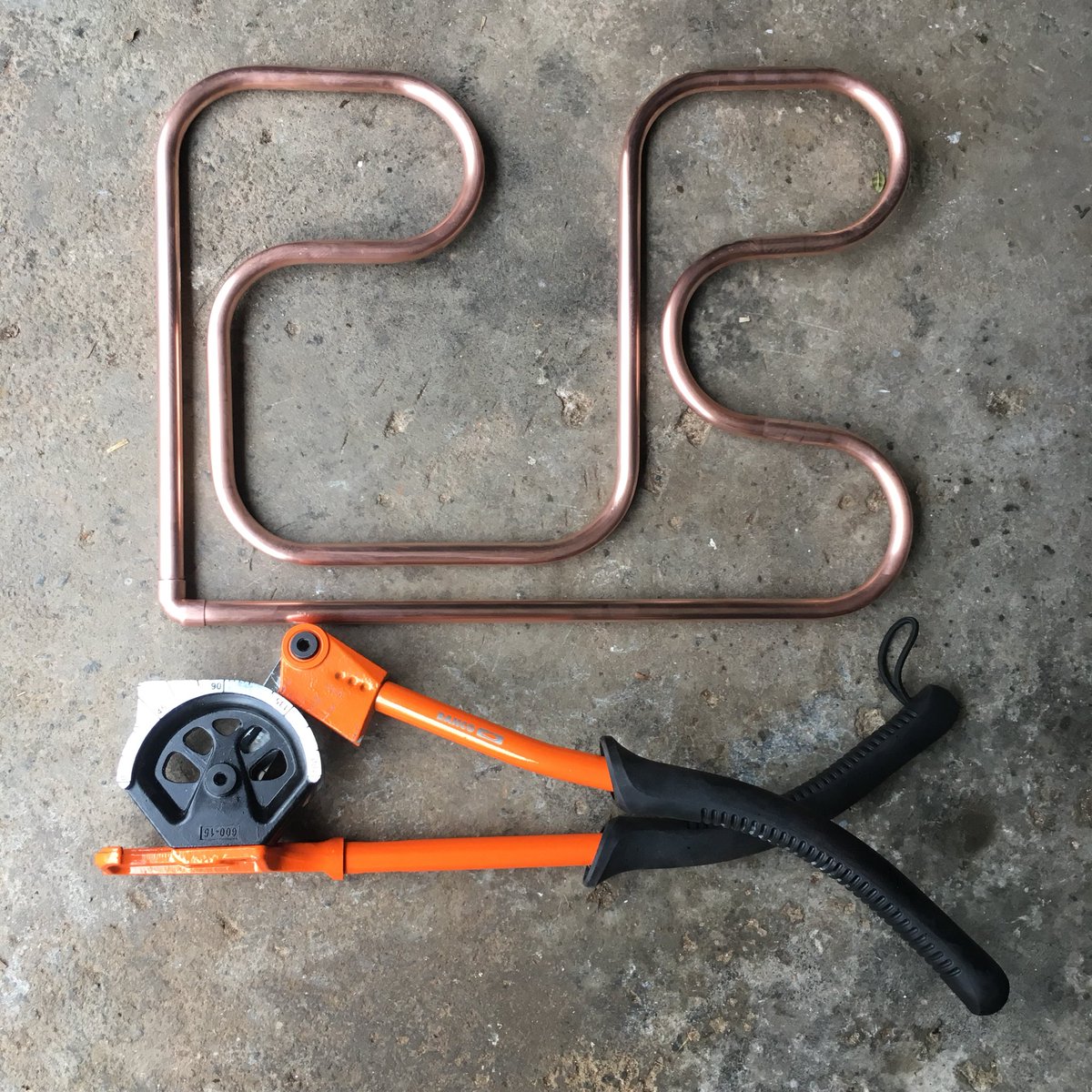

I have a Draper 34212 lever bender. I know it isn't a Hilmor but I don't bend 3/4" much so it does the job. The one thing that is difficult is bending 180 degrees. Do you guys have any tips? Obviously I can do two 90 degree bends with a gap between but often I need a 180.
I was thinking of adding another catch to the frame so I could bend once then move the pipe forward some and finish the bend.

Bacho 180 degree bender have a look at pb plumbers vid on it

I was hoping you guys had a trick for bending 180's on a lever bender as it seems most of you use lever benders for water piping. I guess I will have to try to add another catch.
You had a look at hilmor hvac tube bender ?
I also have the hilmor 1926598 Compact Bender Kit but it won't work because it is for soft copper. The 1/2" L pipe we get is "hard" copper. I put that in quotes because there are different grades of hardness/temper. For the most part we get mueller streamline which is bend temper. That means you can bend it with a lever or geared bender but it is still relatively hard and difficult to bend by hand. Soft copper can easily be bent but costs more because it takes more gas to heat up the copper and make it softer.

Maybe I will just make some 180's at the shop with the geared bender and keep them in the van. I usually only need them for toilet tempering valves and frost-free hose spigots under kitchen sinks.
It does look really nice, can't find any sites that ship to the states though :(
