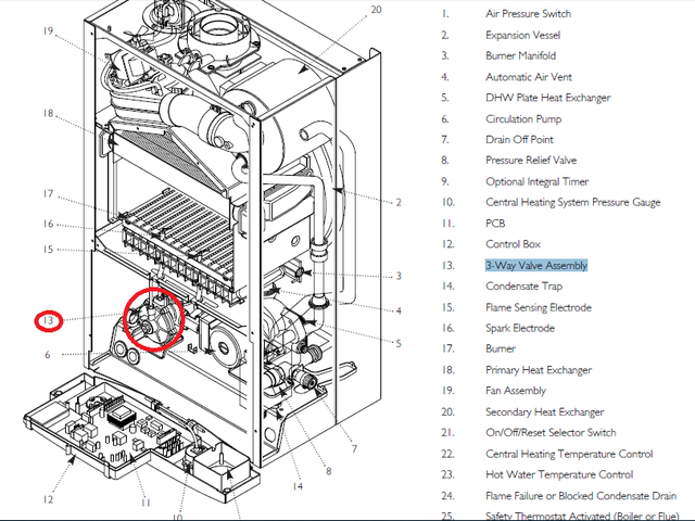

I've got a Baxi Combi 105 HE, and there's a component at the bottom that drips water. Not a lot, I'd say 1 drop every 10 sec, but annoying though. Here's a screenshot from the manual with the part I mean:
Is this something I can fix myself? I can do basic plumbing and central heating DIY stuff, but I'm in no way an expert. Since a boiler is water, electricity, gas and combustion altogether I'd rather not mess around with it.
Thanks!
As above if it's dripping then it'll be the Diaphragm in the Diverter valve that needs changed. Not a big job but not a DIY job either
