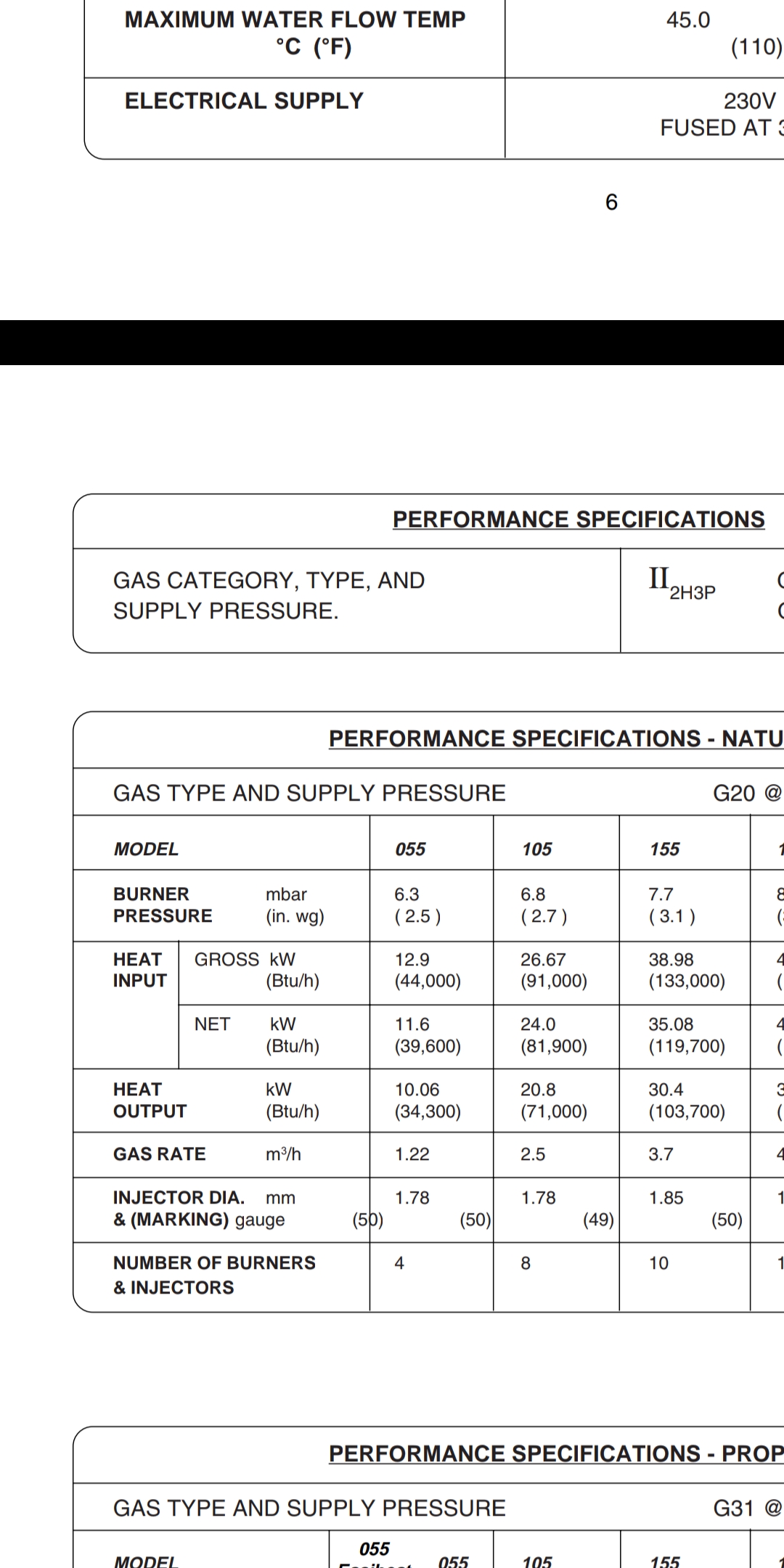

Now because of this, the engineer thought the gas piping run at 22mm was undersized as the manual for the heater (Certikin MB155) stated a recommended pipe length of 10 metres. The pipe length here is around 20metres.

Thanks for the reply. I attach the screenshots from the manual with gas requirements for the 155 model. Running on propane 24metre length of pile would be OK in 22mm.
