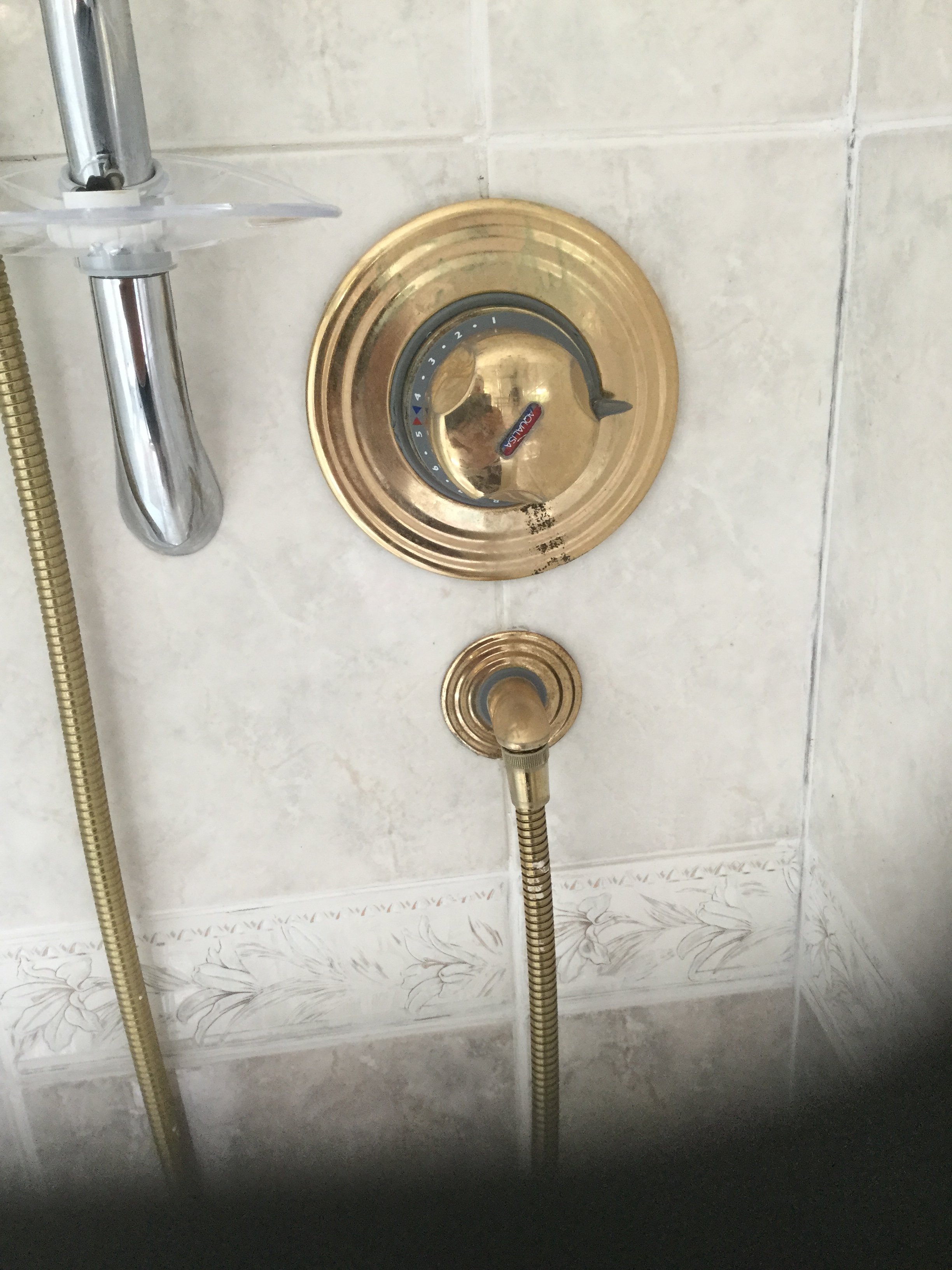

Hi I have just moved into a bungalow and it has a Aqualisa mixer conceal shower in a tarnished brass colour when I turned it on I heard a pop noise and water was coming out from the back so I took the round inspection plate of to have a look behind it and I found a small white cap with a round part next to it with a rubber ring around it but it won’t go back on as there is no thread to tighten it up so when I turn on the shower water comes out of the back at the top and down the inside of the wall.can anybody help thanks Andy

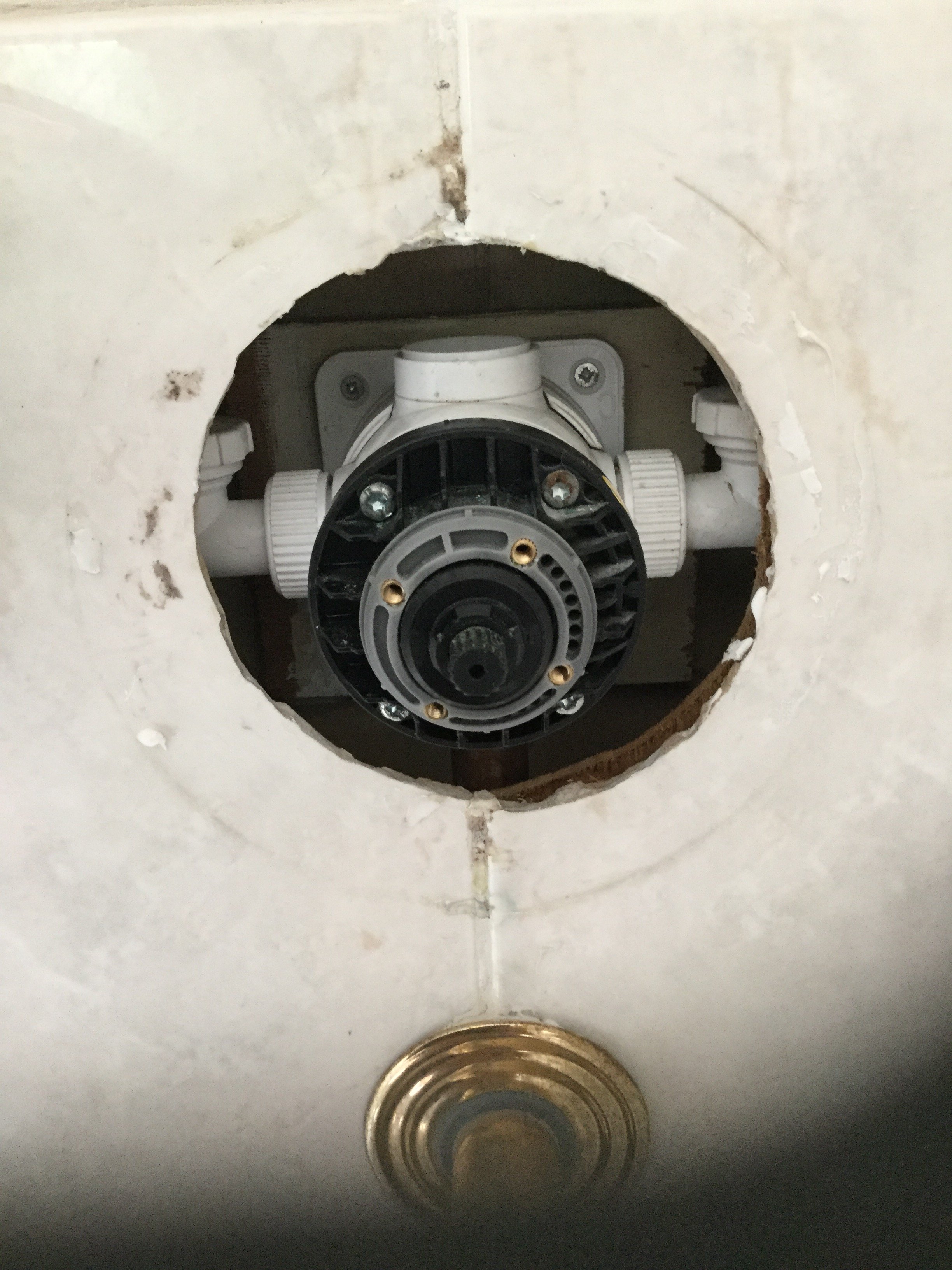

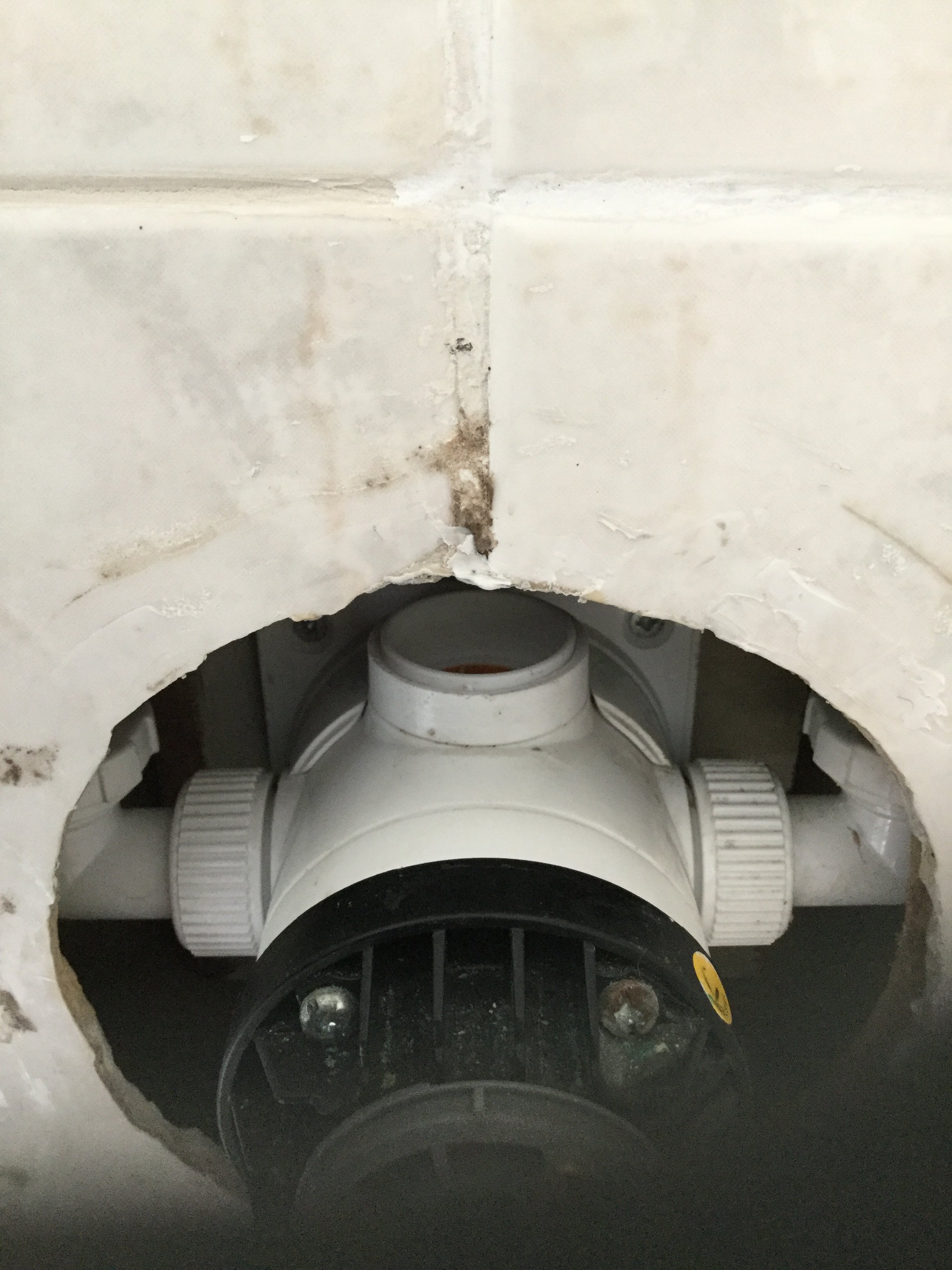

Hi thanks for your response in the last photo the small white fitting keeps coming off under water pressure but it is supposed to be fitted on the top outlet is this a PRD

Its not a PRD. The valves have the option for either top or bottom outlet and you switch the cap around to suit what you require. A little search online and I believe that is the aquavalve 430. If you email the pictures to aqualisa they will be able to advise on what parts required to repair your shower. You may require either a new cap and outlet kit or possibly a new body if it's damaged. What hot water system you on? Some of the older plastic aqualisa models were only suited to low pressure systems so if the system has been upgraded it may be whats caused the fault.

Is there no lugs in the cap or on the valve body? I would have thought it would be a push in and twist to lock. Also if your on a combi, is the shower hose and shower head free flowing and not blocked with scale? A backpressure build up caused by a restriction could have caused the cap to pop off.

Hi the shower is on a stud wall and the hallway is on the other side.I contacted Aqualisa today and they said that it is a old model a 605 the fitting on the top of the valve has snapped off and the thread was still on the body.I now know what has happened and you was right thank you very much for your help I’ve ordered a new cap/plug for £30 then I intend to change the whole lot eventually I will let you know when I get this part if it works thanks again

Hi thanks for your great advice and help my shower is back up and running again it was the blanking plug when I changed the shower hose it was a slightly smaller bore I don’t know if was this that caused the pressure of the water to force the plug off its thread and snap or the fact it is a old shower thanks again Andy
