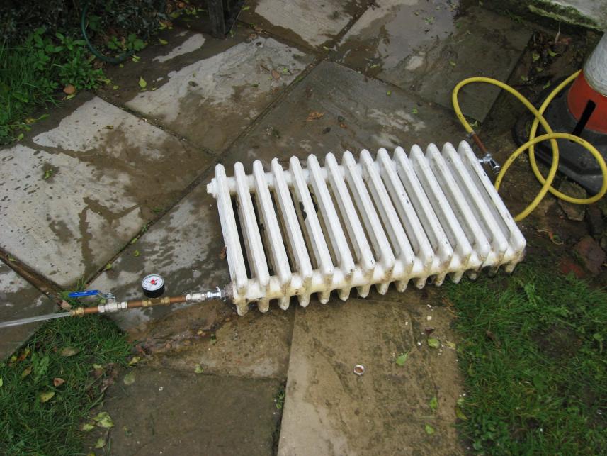

Here's the same rig, used to pressure test reclaimed column radiators on a period install job. The part spurting water is a female 3/8 BSP, which with a bit of PTFE will accept a compresser hose union perfectly.
thank you danny pipe, can i test normal rads? or will i need to turn them off?
You should really turn them off, but in all honesty, I never do, and it's useful not to because it will show up if a rad valve union is leaking or you've left a bleed valve open.
So in short, yes check the rads as well as the pipe work. I've done it for years and never had a single problem. It can save you hours on a drain down too. I only bother checking large runs of pipe. Not worth the hassle of setting it all up otherwise.
