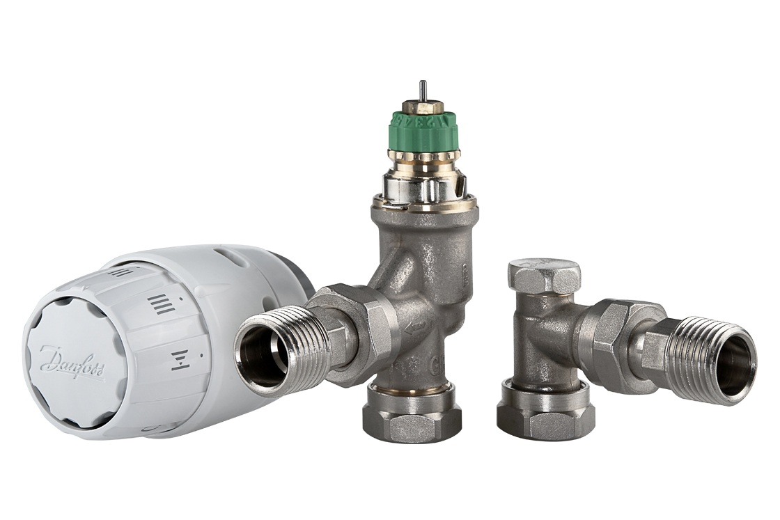

**) You can also purchase "Auto Balancing TRV's" and "Auto Balancing Valves"
