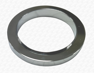

It may be that the hole in the bath is bigger than the tap needs so it may need a large washer with a seal under to cover the gap something like the link, but the size of hole and tap would need to be checked first.
It may be that the tap came with such a washer but was never fitted.
