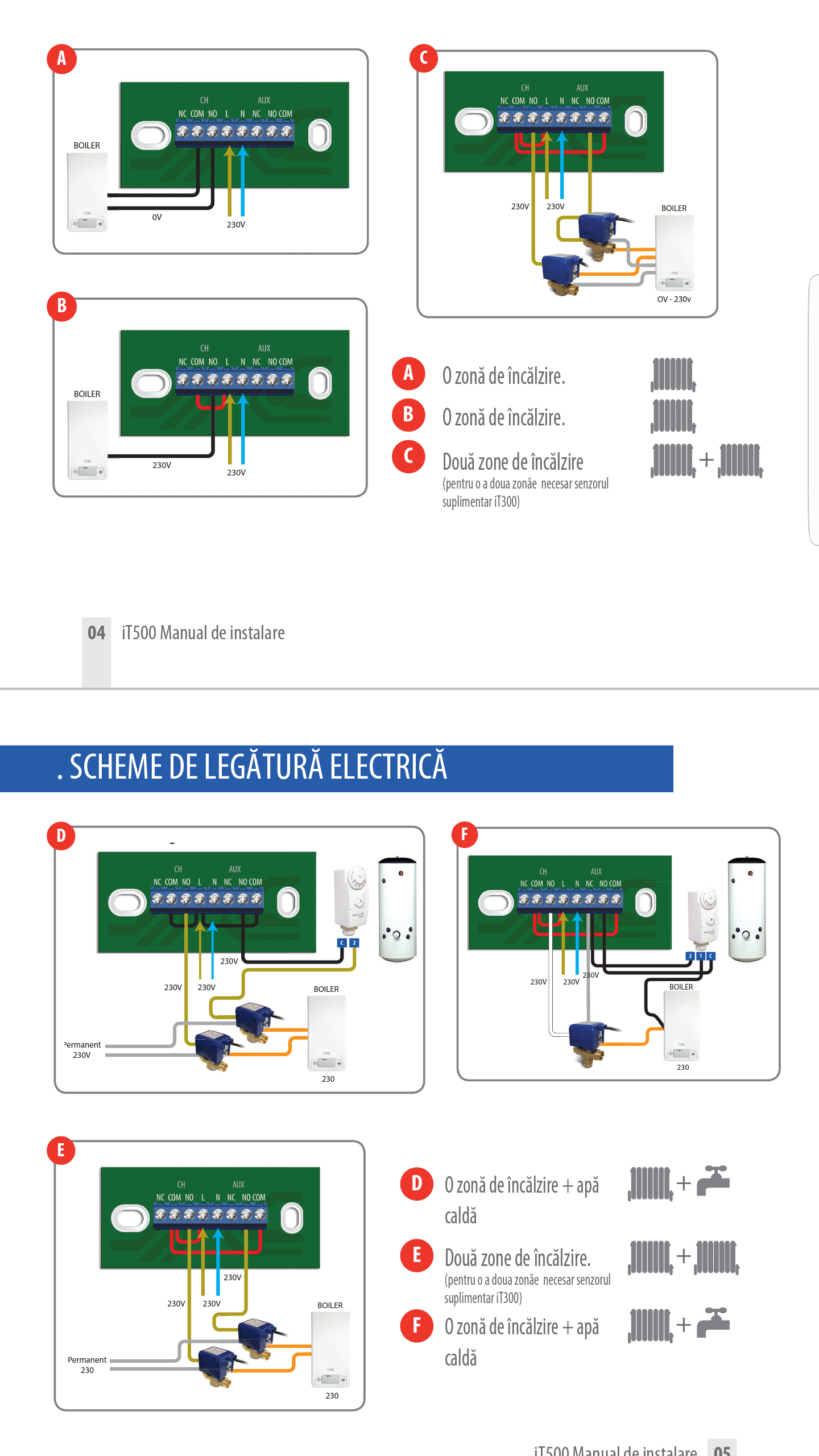

I have a thermostat salus IT 500 and it300, Ariston Genus One 35kw and 2 pumps for 2 heating zones.
What I want: to independent control each zone, floor no1 and no2, with the pumps. When the temperature that I seted up reaches, the thermostat to command a pump to close the circuit.
Problem: I can't make the wiring system.
You will require two single Pole contactors
Simply
Lne to stat
From stat call goes to a1 on contactor a2 neutral from stat / same circuit
Then a perm live to one side of the contactor from the same circuit
The other side to the pump
Hope that makes sense
Simply
Lne to stat
Stat won't be rated for the pump amps so could blow / damage it
