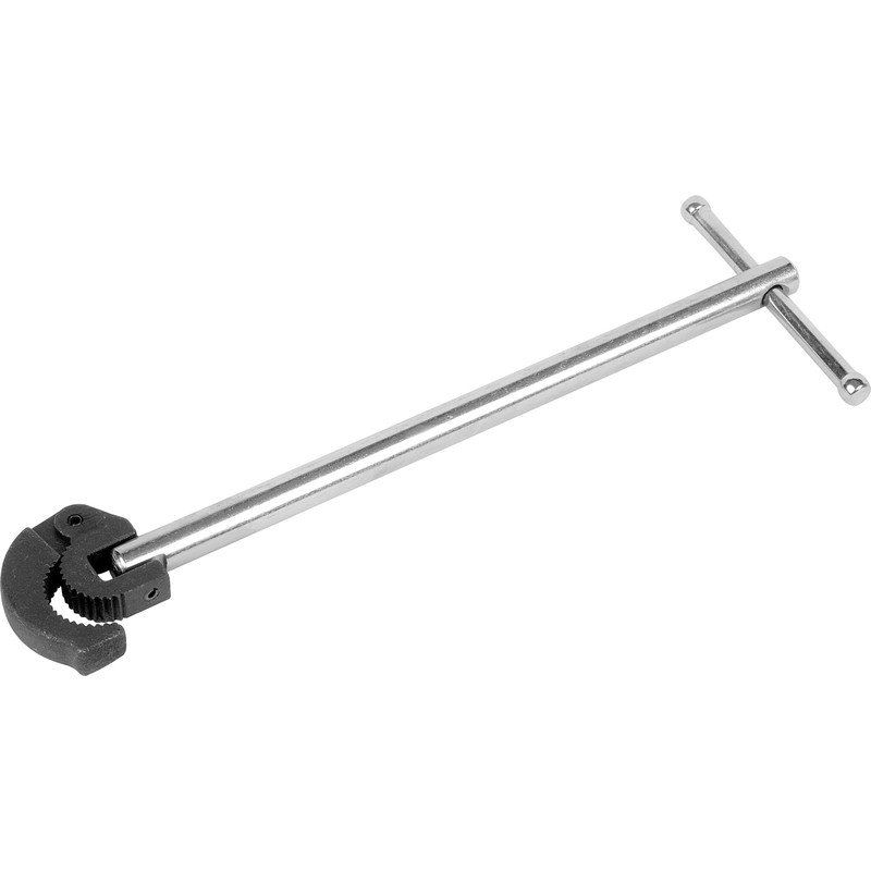

    Hi, can anyone let me know what is needed to remove this very stubborn tap from the kitchen sink.
  2. Pickwickpick
    Pickwickpick Plumber
    You're going to need an adjustable basin wrench/spanner to get that chrome nut removed. Once you've dropped the chrome nut, you should be able to pull the tap away from the sink enough for the copper tails to be accessible, they can come off with a small spanner or adjustable spanner.
    e2a: one of these
    [​IMG]

    If the sink/basin is off the wall, you could try an adjustable spanner or grips on the nut and turn the tap with your hand.
    A big box spanner or monument tap spanner might be thinner
    Monument 2 Jaw Adjustable Basin Wrench
    Good luck. :rolleyes:

    That's a lot tighter than it looked from the initial pic, you're going to need to remove the copper tails so that you can get a box wrench (see pic below) onto the nut.
    [​IMG]
