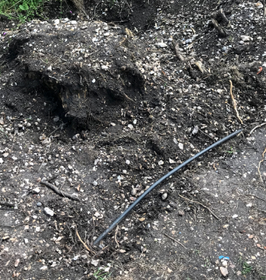

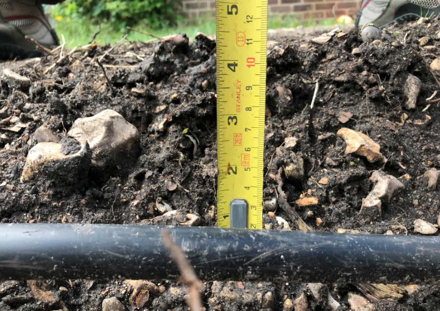

    Please could someone provide any advice on what a black pipe with Tenaplas Ltd BS1972 on it, could be? Do you think it is a water pipe, rather than any other utilities? (e.g. telephone, electricity, etc...)
    We have found it 4in below our garden (we haven't unearthed all of it yet), so don't know where it starts or ends....who can we contact to obtain information on what this is for, is it still in use, and how can we move it?
    Hope this all makes sense - I have posted a photo of it, in case this helps identify it.
    Thank you for any advice anyone can give.

    Could be elec
    Garden shed outside lights?

    thank you for your quick reply...I really don't know - we moved into the house 2 years ago and am not aware of any electrics going outside...we want to build an extension - hence why we have started to clear the ground.
    I've put in a request to SEB to take a look as well. When I have googled BS1972 I see lots about it being a water pipe - so thats why I thought maybe someone on here may have seen this before.
    Thanks for your thoughts

    This is probably not a water or gas pipe. I would lift the exposed section higher and see if you can make it break, it might be brittle. turn you lecky off and break into it. In situations like this I would just turn lecky off and then set fire to it and see what happens

    Quick Google says:
    BS. 1972 is for above ground or pipe and cold services.

    Thank you - yes that is what I have found...
    "BS 1972: Polythene pipe (Type 32) for above ground use for cold water services"
    "This pipe is coloured black for above ground use only and conforms to imperial sizes. The standard has effectively been replaced by BS 6730 and may be withdrawn"
    Well this definitely wasn't above ground - or at least it isn't now...it may have started it's life as above ground and someone thought it would be useful to bury it??
    Who would manage 'cold water services'?

    I'm fairly certain it's what's called Black Alkathene which is marked with that standard. It was used a lot for water services where I am and also commonly used to sleeve sections of underground oil lines too.

    What is in either direction of the ends ?
    Going back in time people thought it was a good idea to use such pipes to run twin and earth in!

    The 3/8” black alkathene was perfect for sleeving 10mm copper oil lines
  13. chris watkins
    chris watkins Plumber
    How old is the house ?
    Approx what direction is the pipe running i.e. to or from the house ?
    At that sort of depth it is unlikely to be mains water as it would be subject to freezing.
    Could be an old temporary supply for the building site is house in not that old.

    So I tried to unearth some more but it just kept going so I called the SEB to say we had found this pipe/cable after digging. The lady then went into panic mode and said that she was treating it as a damaged electrical cable and would send an engineer this afternoon and to ensure that everyone stays more than 5m from it!! (I suppose better to be safe than sorry). Anyway a lovely man came out and as soon as he looked at it, he said that is not one of ours. He also put a CAT over it and confirmed there are no electric cables nearby for us to worry about. He has suggested it was an old water pipe that is probably not used anymore (which I know others have suggested), he has also suggested that we just cut a hole in the top so we can see. So think that will be our next step - hopefully it is redundant and we can ignor/remove it and continue with our building work.
    Will let you all know once we’ve cut into it.
