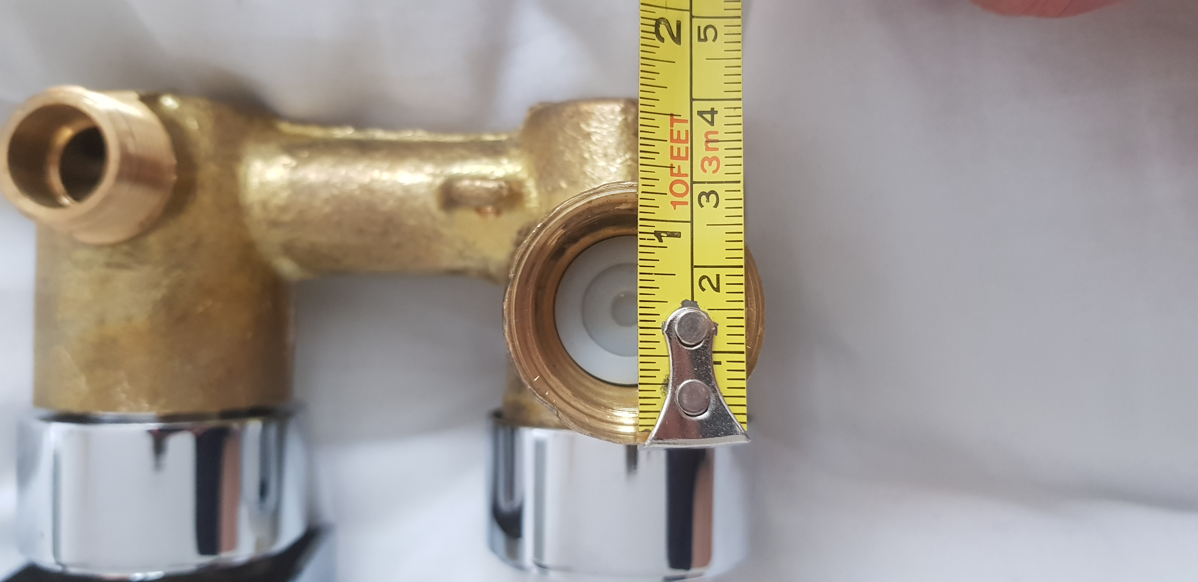

    I am putting a shower in, but cant fathom what connector I need to use to get the mains water supply connected to the valve.
    The water coming into the valve will be via 15mm pipes, but the opening at the moment is bigger than that so I need a reducer or something for this I think. Screenshot_20190525-175523_Gallery.jpg
    I'm aiming to connect using speed fit fittings
    (See attached image)
    Can you advise?
  2. ShaunCorbs
    1/2 male iron

  4. ShaunCorbs
    Measures around 20mm dia

  6. ShaunCorbs
    Inside dia
  7. Steve weightman
    Steve weightman GSR
    1/2"x 15mm female and a 3/4" x 15mm male.

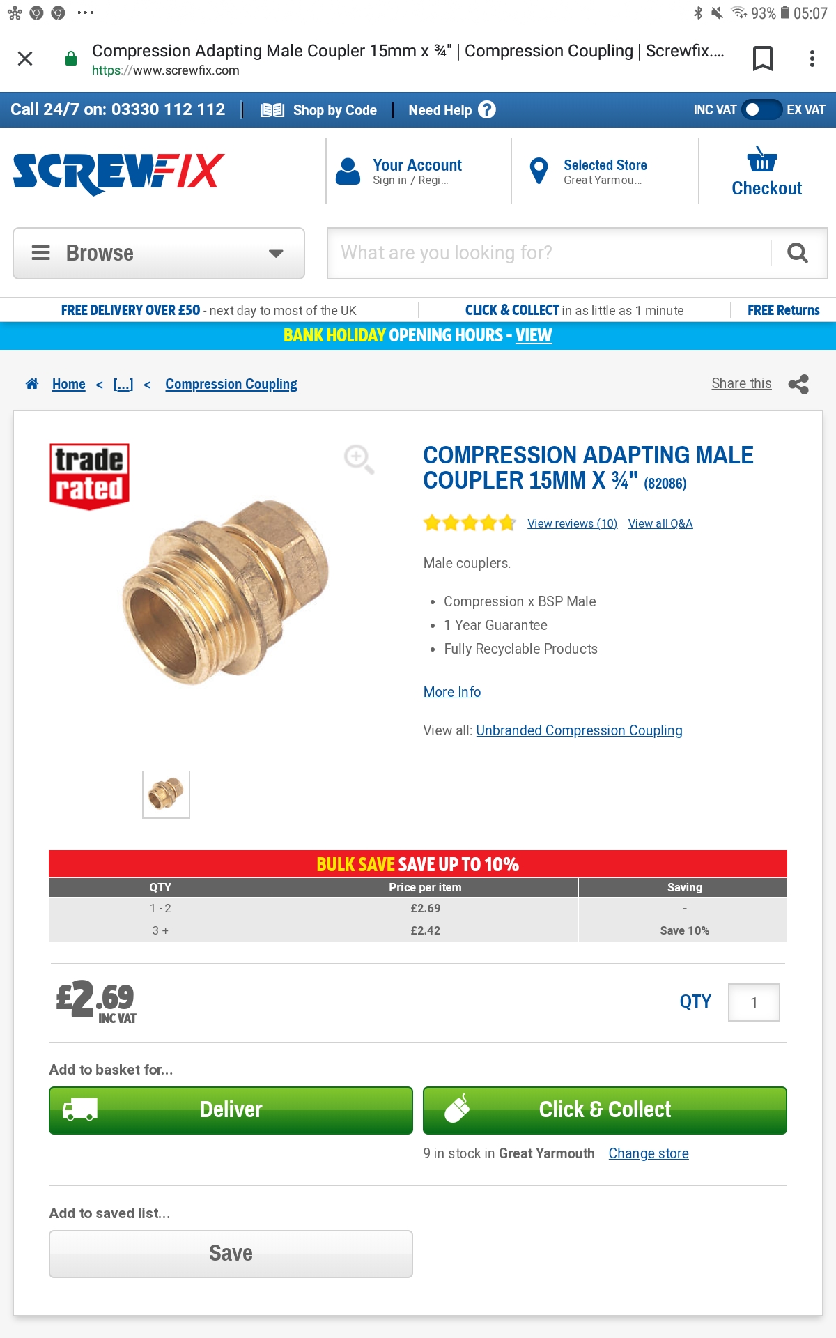

  8. king of pipes
    Looking at it probably this then adapt from 15mm copper to your speed fit . Kop
  9. quality
    quality Plumber GSR
    I would prefer to use kuterlite type as they do a male taper

  11. king of pipes
    Each to their own but these will do the job , kop
