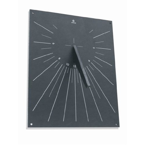

Totally of topic but I worked at a house once where the old fella had fixed a Sundial to a vertical wall like a clock. I laughed my head off
41UhUVi36eL._SS500_wall mounted sun dial.jpgWall mounted sun dial:clap:
I did not explain properly, it was mounted under the apex of a summer garden type thing attached to the side of the garage (with no sun)
