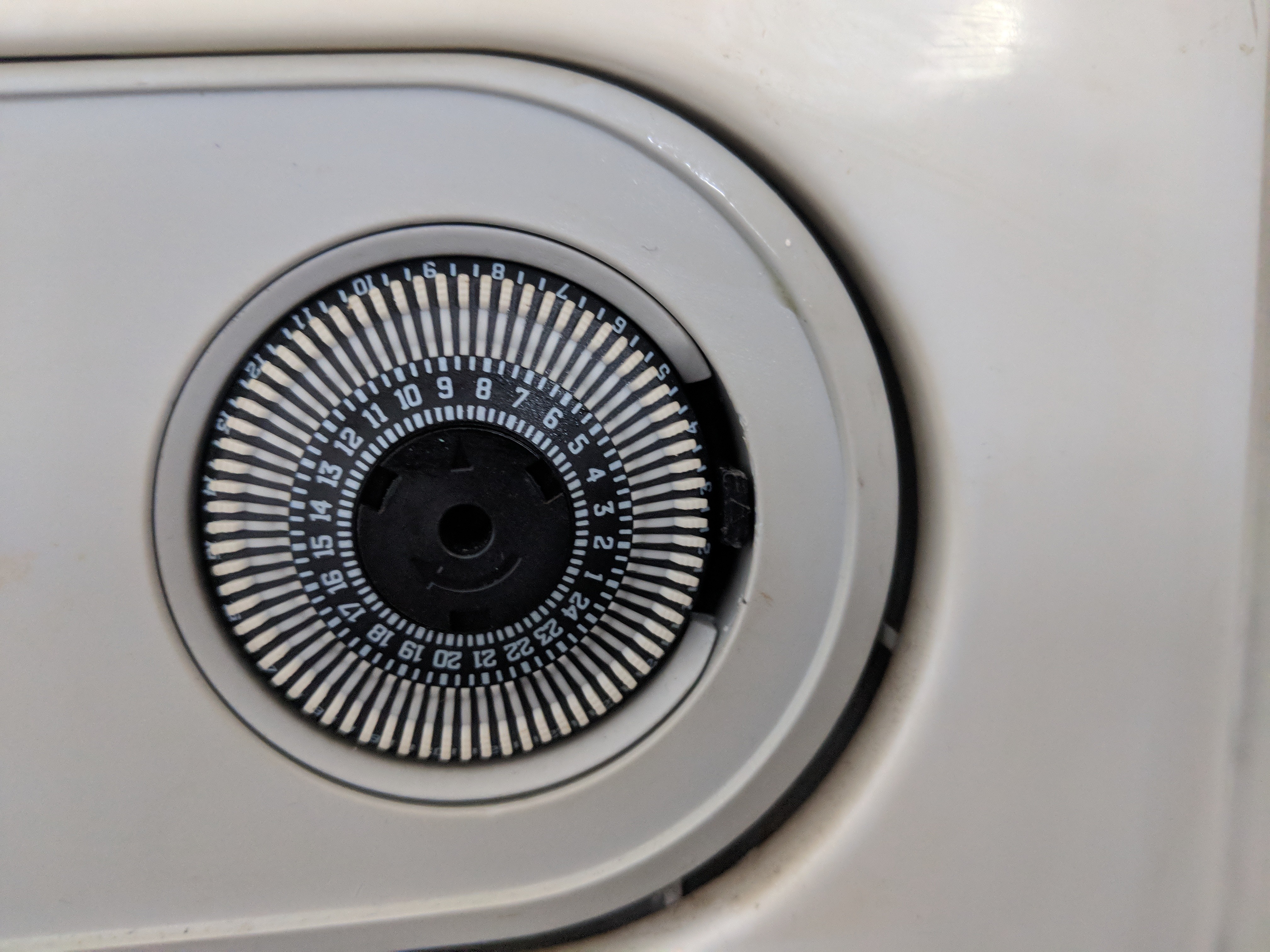

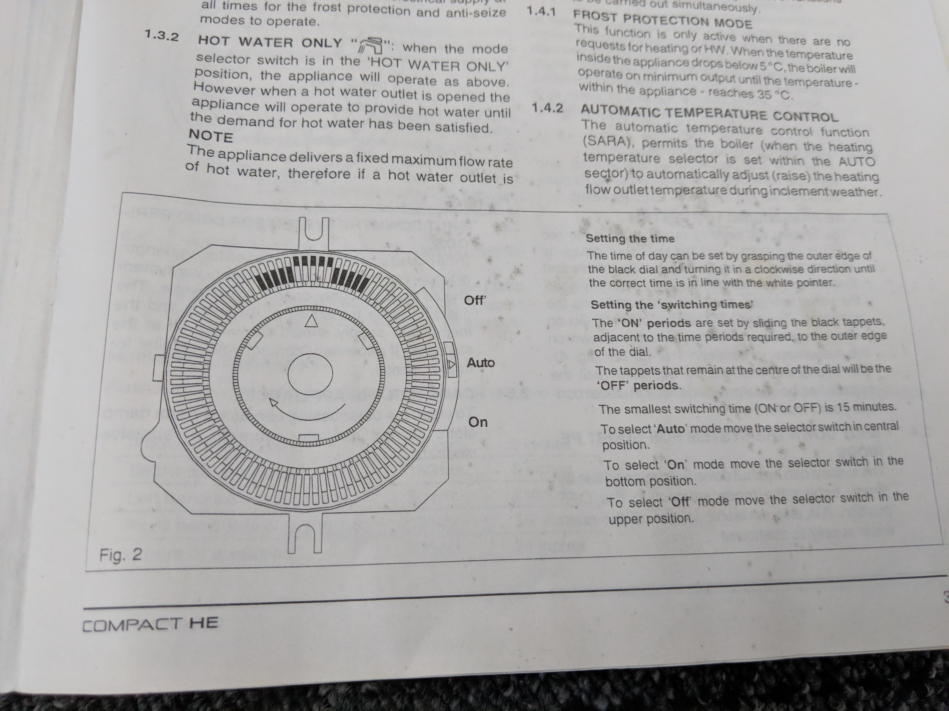

Then on the timer clock right side black switch push it down should come on then if it doesn't try moving the switch all the way up

the black switch the right of the clock is currently in the middle which is apparently "auto".

the black switch on the timer dial is set to auto.

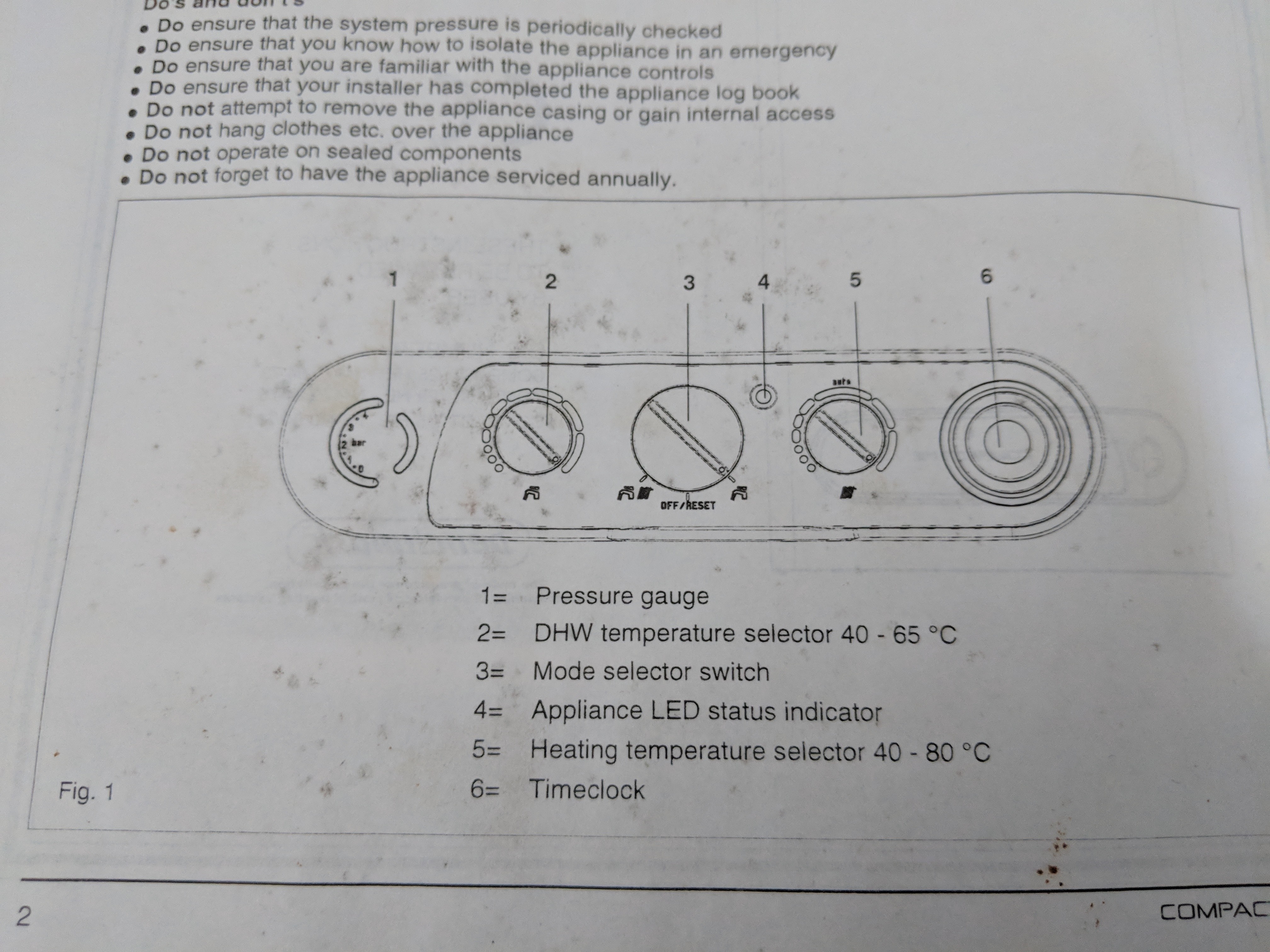

i've found that the supplied manual doesn't really match what is physically on the boiler. it says the timer dial should be lined up against the white pointer, but mine doesn't have a pointer.
also, the section about the middle dial doesn't match what the boiler has either.

on the boiler the snow flake is winter mode eg heating and hot water, sun is just hot water eg summer mode

i mean it will run until you turn the clock off / until its set to eg 9am -11am
