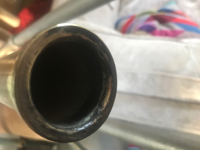

Hello all, I am hoping to get some advice on a small project I am working on at the moment.
I have a lovely old victorian towel rail which I am trying to modify to make it smaller. Its just too big for out house.
It is made of Brass pipe and fittings, 1 1/2" . The Brass pipe has a flange end and a compression BSP fitting. There is a perished washer on each fitting. I intent to cut off the flange of the brass pipe (to make the radiator smaller / narrower) and restore it / reconnect (with new washer).
I do not think it will work with just an olive on the pipe as I am not sure there is enough to grip on if you know what I mean...so was wondering, can you buy flanges you solder on (1 1/2 " brass pipe) or can you solder the olive on to the brass pipe ?
Input or help would be greatly apreciated if anyone has any experiece of something like this or working with 1 1/2" brass.
Pics attached.

Thanks everyone for the input, very much appreicated.
I did think about flaring the ends, but thought the gague of brass would be too difficult.
After considering the possibility of welding / brazing...I have cleaned up the ends and it appears the flanges are soldered or brazed on the ends ! Hopefully this means I can heat it up....remove the flanges and re-solder or Braze them on the adjusted length.
The pipe o.d is hard to measure because of the flanges but I belive it is 39mm.
Can anyone advise how I would tell if its soldered or brazed ? Ive attached some pics but difficult to see. I think either way it needs a Oxy torch and not a plumbers blow torch. (thus not a job for me)
If I cannot get them off, as Yorkshire Dave has said, I can get some new ends turned.
Luckily in a 2 mile radius from me I have 2 very clever chaps with lathes who I am sure would be up for it !
Why out of interest fiber washers over rubber ?
Thanks again for help everyone.
It won't be 39 mm at that age. That'll be 1.5 inch (bearing in mind production accuracy was not as good as today).
Think you'll do potentially more damage trying to remove. Best, IMHO, to use an adjustable pipe cutter to cut teh pies and get those ends turned.
Fibre as its much more solid a join. Too much flex & give in rubber and the oxygen etc in the water may eventually break them down. Why risk it?
