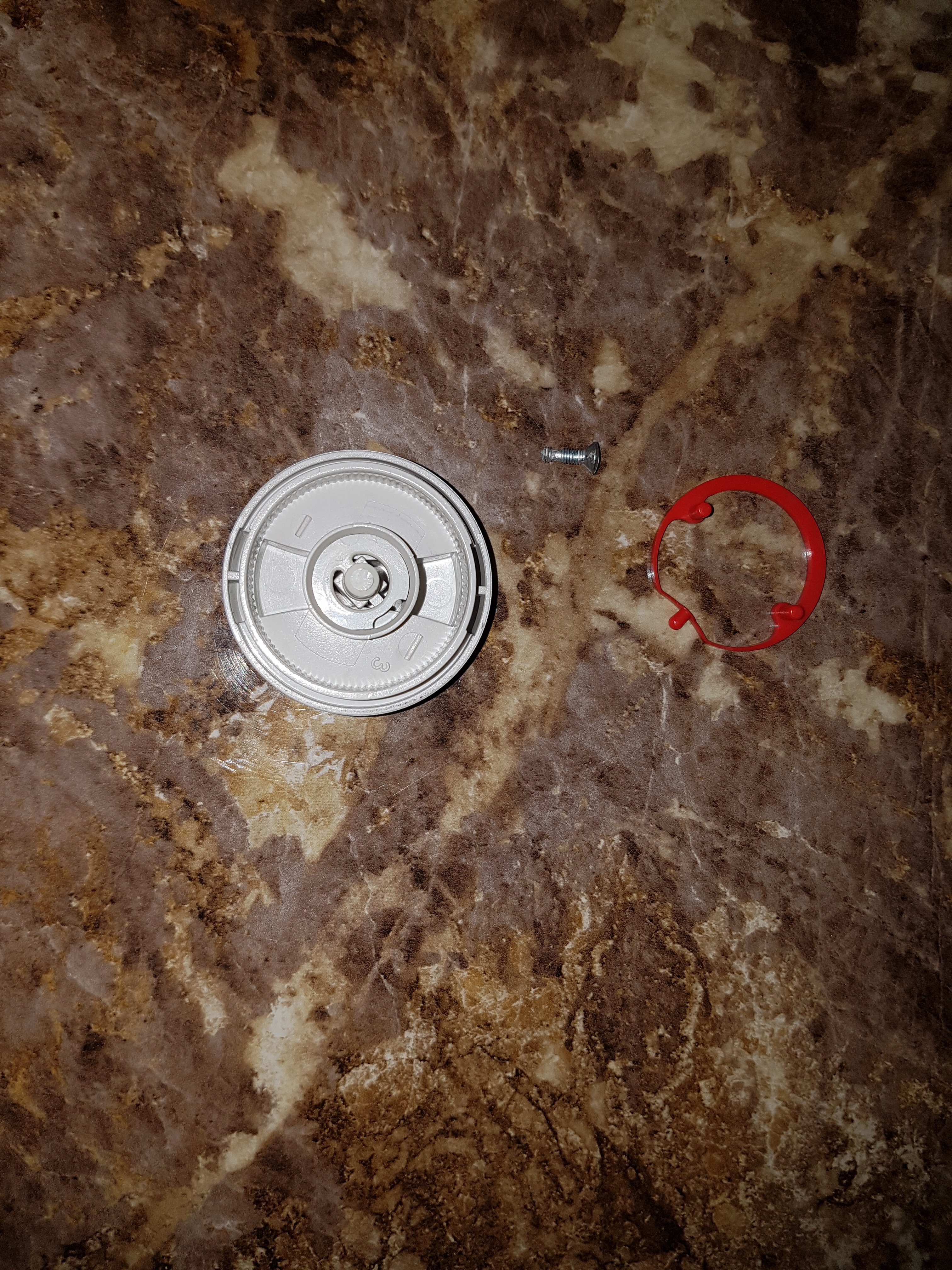

Hi pictures say it all really..
The knob to turn to adjust the temp of heating,(and hot water) just free wheels, and pulls off.
Can I just stick a screw driver or something in and twist?
Is there a way to work out what it's set at?
Is there an easy perm fix?
Easy perm fix is to get a gas safe engineer in to replace the knob. As they will have to remove the cover to fit a new one
Using a pair of pin nosed pliers just wriggle the shaft. The temperature will be displayed in the window. Adjust as required.
how much to sort this job? i can see you can replacement knob for about ÂŁ10. should i attempt? how much for a engineer to do is a fair price? greenwich
Hours labour and a coffee. We don’t talk prices on here
You won’t know without a gas safe engineer as you can’t take off the cover legally I’m afraid
please don’t poke a screwdriver through, the plastic insert goes into a live connection.
