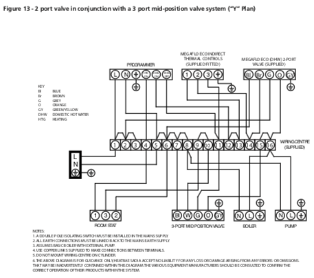

    have any of you fine chaps got a wiring diagram for a y-plan with a new 2 port wired in for an upcoming unvented installation.
    I usually change them to an s-plan but the boiler is miles away from the cylinder and would cause a load of work getting perm lives to the 2 ports .
    Cheers in advance

    Creates more hassle than it's worth IMO. Have you checked the wiring, you usually have enough wires to do it anyway, especially if theres already a pump overrun.

    Can you add a 2 port to a y plan? With the 3 port keeping one zone permanently open, what happens when the 2 port calls for heat? You'll get unwanted heating of a zone.

    Yes you can. It's on the HW side, so you can leave your 3 port in situ and have the 2 port for thermal cut out for the Unvented after the 3 port valve. It's doable but for everyone that i've come across it's not worth the hassle and easier just sticking two 2 port valves in.

    Ok, I get what your saying, but if the 2 port acts only as a thermal cut out, what happens when the cylinder stat on the first cylinder is satisfied but the thermostat on the second isn't? You could end up with unbalanced temperatures.

    Ancient boiler pal , so no spare wires but just realised there must be a hw off wire , but really need 2

    If you've got a HW off wire then you're sorted. Change that for a perm live, you'll already have Neutral and Earth there, along with HW on and CH on.
    It's when you haven't got a HW off wire that's the issue (So when they have to have HW and CH at the same time)

    Part of the G3 regulations. Must have a thermal cut out, as a 3 port valve is always open in some form that doesn't meet the requirement.
    See so many Unvented cylinders on 3 port valves, it's worrying! Had one where the High limit stat kept cutting out, so cylinder must have been about 85/90oc!
