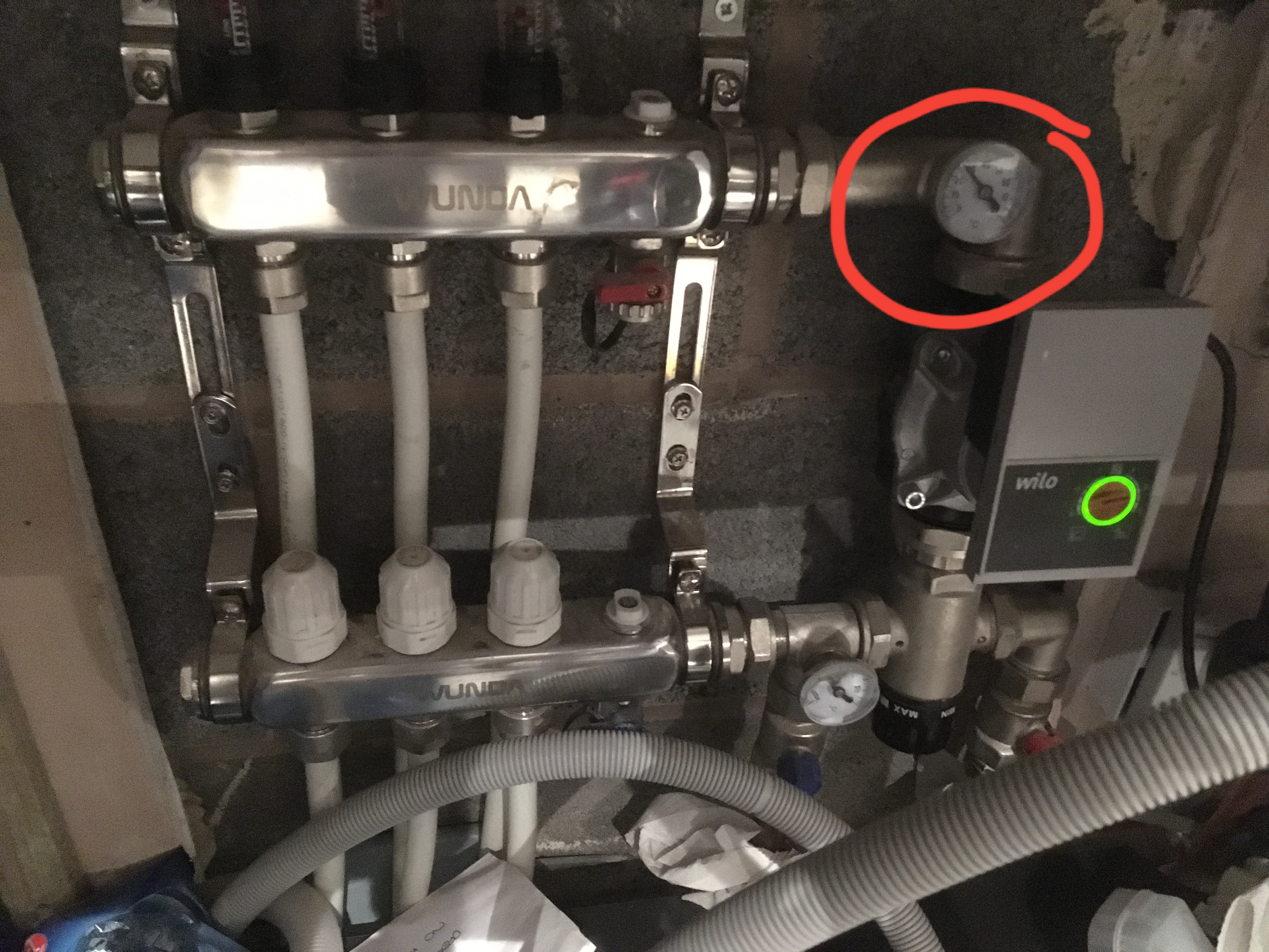

  9. Pkitch
    Pkitch New Member
  10. Pkitch
    Pkitch New Member
    Here you can see the inlet flow temp is about 25 degrees but I can only achieve this by turning the central heating on the boiler to minimum
  11. Pkitch
    Pkitch New Member
    Chris that is my guess but the system is new and the blender/mixer valve does operate but not as low as it should do
