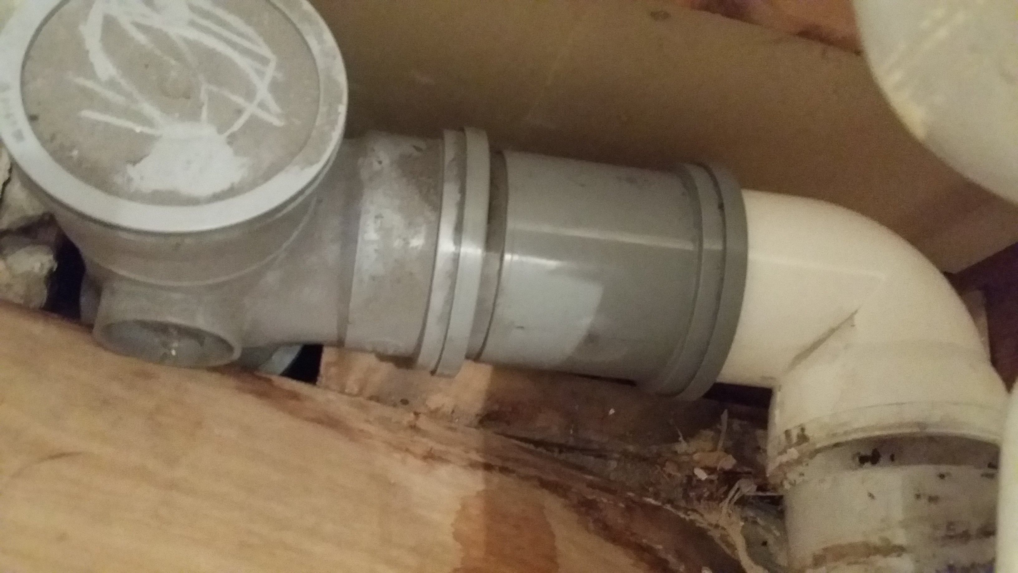

    Hi. The pipe that goes straight into the toilet at the back was leaking. I have moved the toilet away from the pipe but am struggling to seperated the white bend from the grey straight pipe. Any ideas? What is the correct method. Do I twist or pull? 20190710_193106.jpg 20190710_193126.jpg

    Twist and pull , a bit of each pal .

    Thanks for your response. I tried but it must be really tight and I thought I'd seek assistance before getting more heavy handed.

    Sometimes an old slotted screwdriver or crowbar just to loosen the fins, then should twist and pull

    Thanks. I'll give it a go. I'm gonna need a new bend. What's it called mate?

    A (usually 90 degree) bent pan connector. Get a Multikwik or McAlpine if you want a good one. :)
